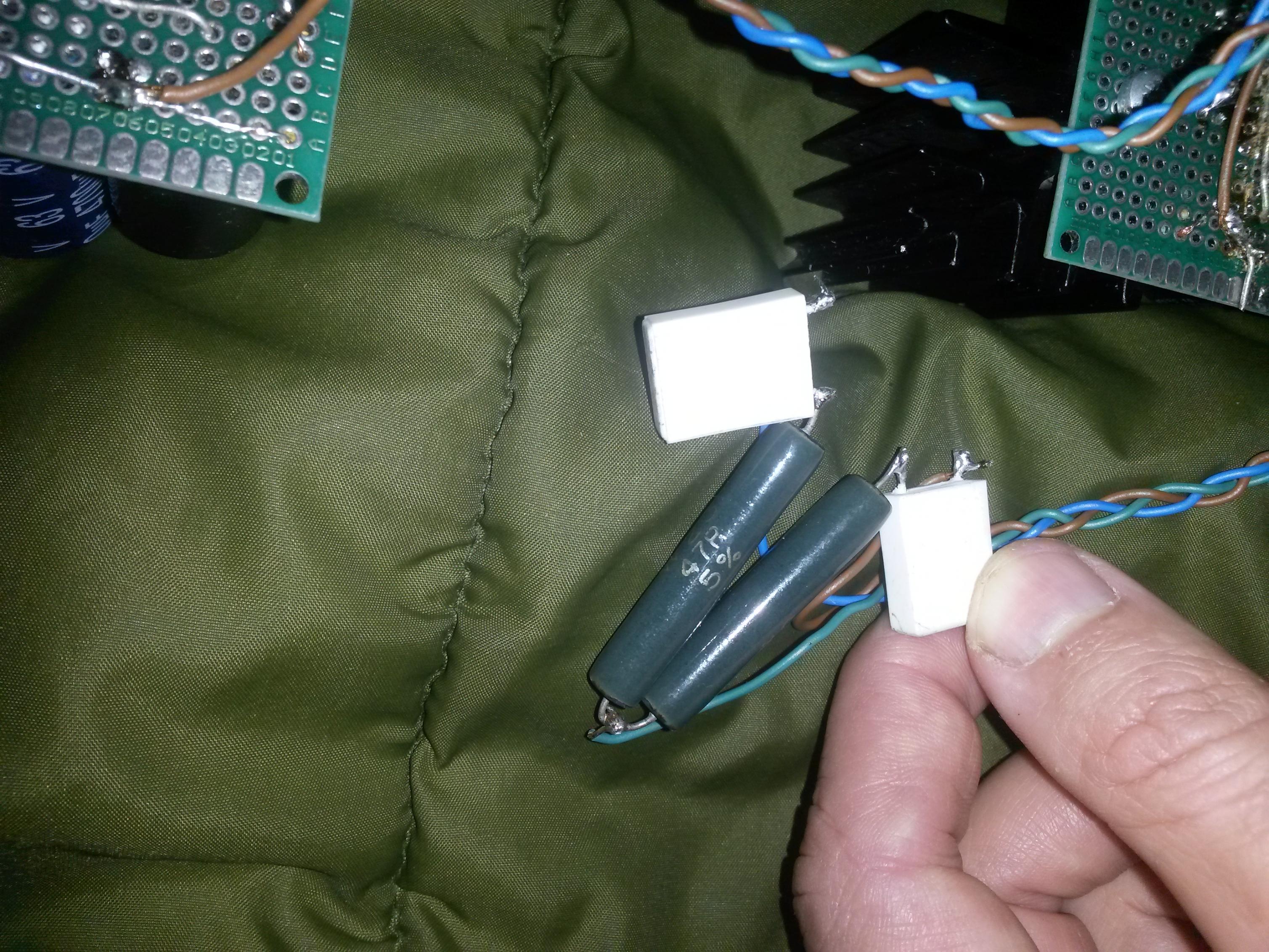

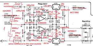

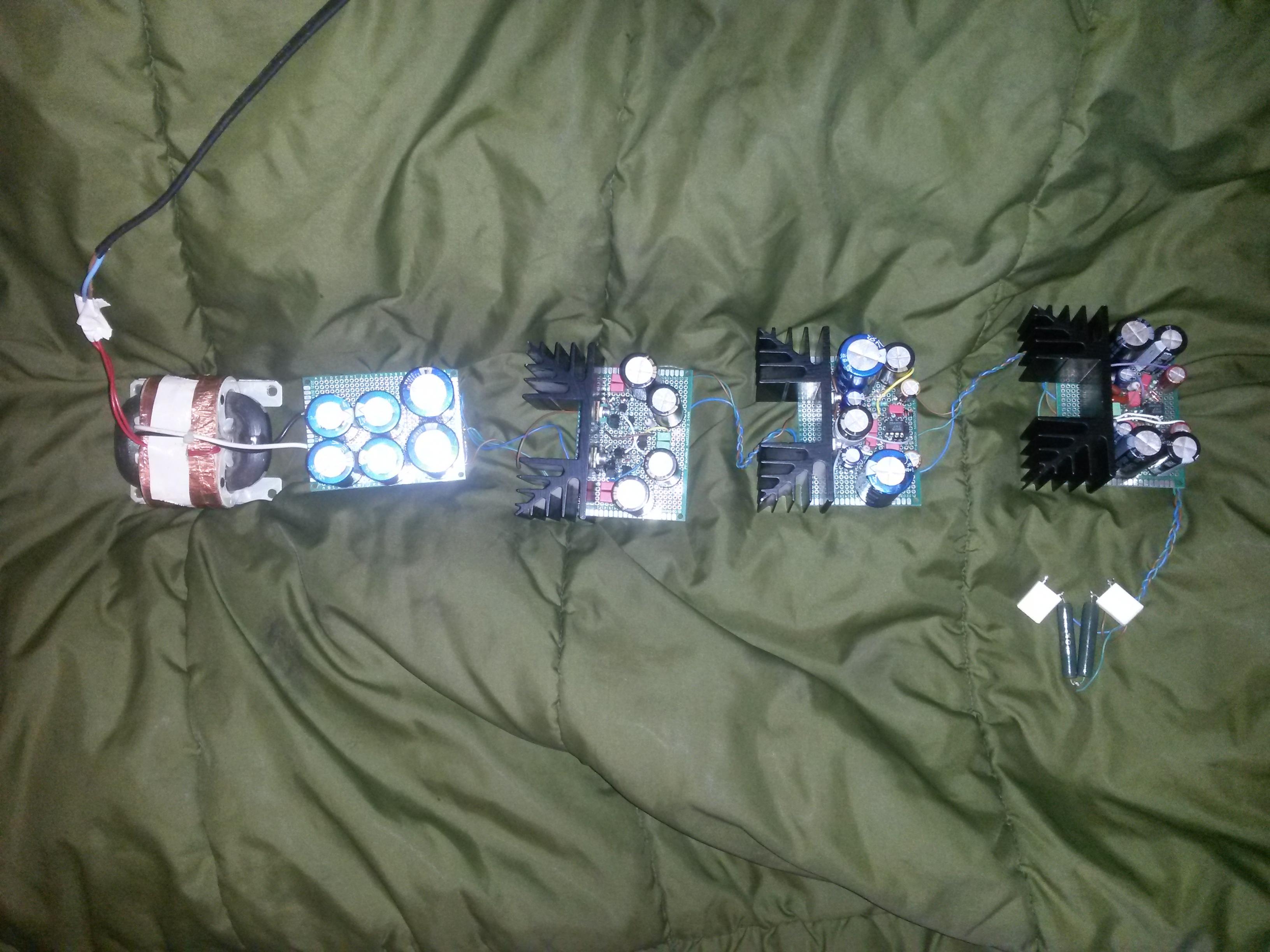

Until now the nakamichi, no feedback loose regulator proved its benefits as it signaled immediately a voltage drop by 3v from 29v to 26v dc supplying the positive lm340 regulator which was drawing some 130ma more than the 7906 Maybe it was defective or reacted badly to the op-amp denoiser...i have no idea, I didn't consider i should have made further investigations so it was replaced with mct7805, adding two more 5v1 zeners to lift the gnd pin to 15v. Consequently the voltage quadrupler output voltage got down too by 5 or 6 v sensing 130ma more load.You have the whole working schematic of the +-20v regulator and a photo of the whole supply chain for the +-43v(quadrupler), +-29v(nakamichi no feedback reg), +-20v technics denoiser, +-10v tehnics denoiser loaded with 2 x 48 ohm resistors .I moved down the chain those 1 ohm current sensing resistors to check which regulator had problems .
