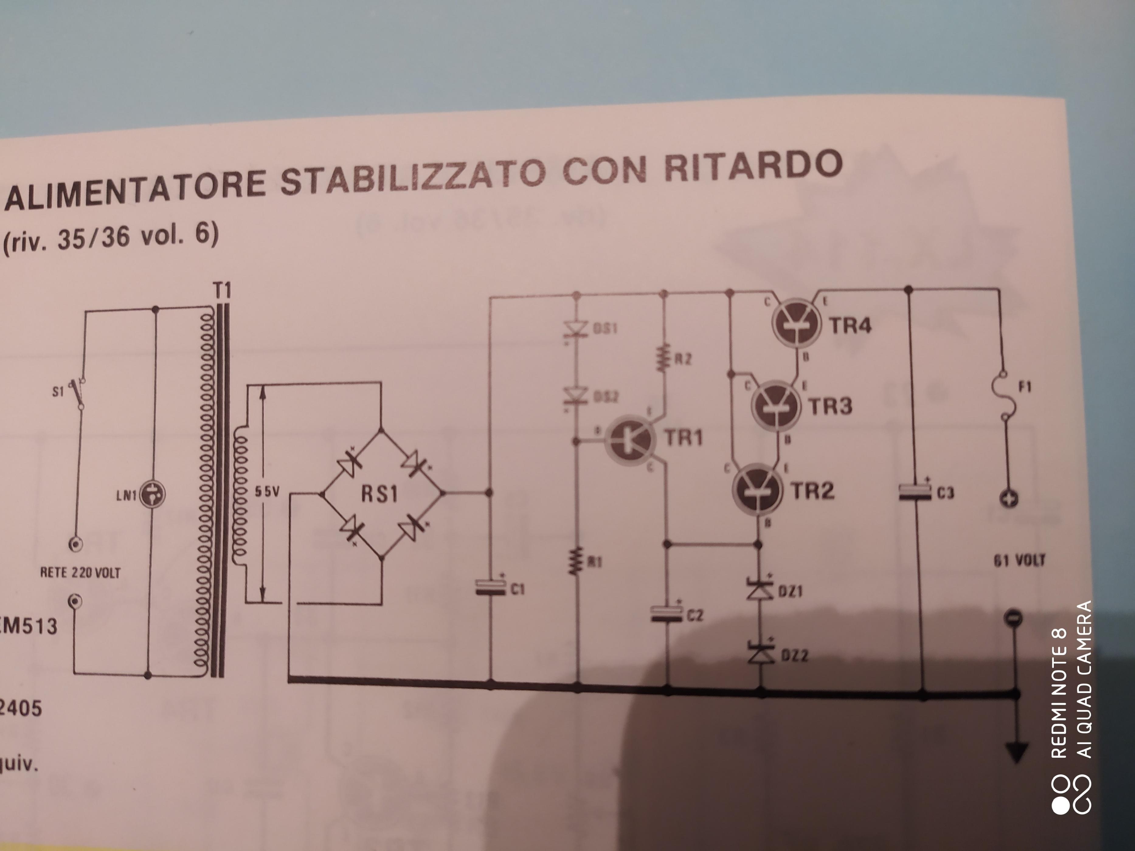

I have seen circuits with two or more bjts in series ... i am attaching one as an example
Why not using darlington instead for a capacitance multiplier ? they are already very high dc current gain devices .... i guess 500 is more than enough 🙄

I can't think of any reason not to use Darlington transistors. Actually the schematic shows a Darlington circuit, just not integrated into one device

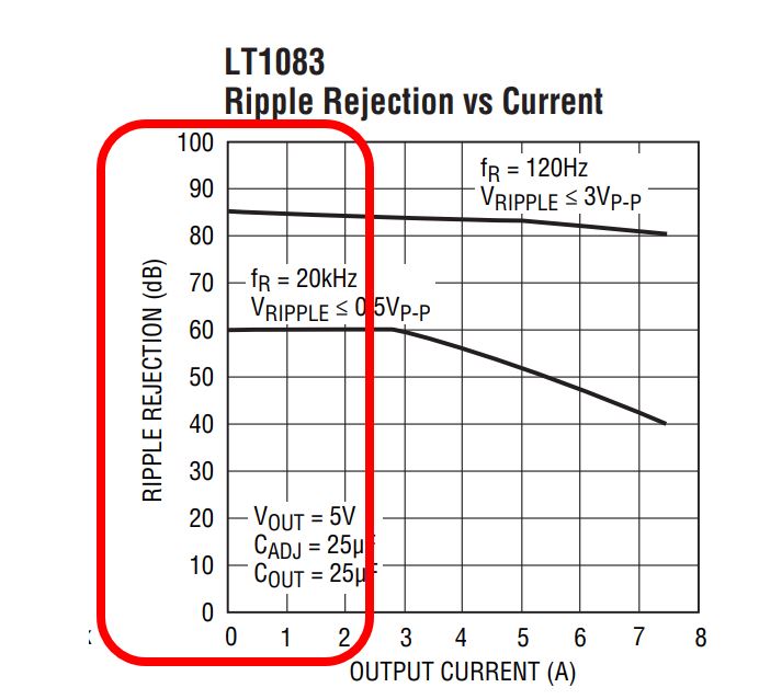

thanks for the advice. After reading how good IC regulators psrr is in the lower part of the audio range and how bad are cap multiplier i have the feeling that the best compromise would be a two stages solution using both.
Nevertheless lookinb with more attention 😱 to the datasheets .... i am noticing that some IC regulators are not that bad in the entire audio range (example attached).
Problem is that i really like to start upstream with a smps and then decrease the voltage and stop its noise. And their noise is a lot out of the audio range. So it seems that a cap multiplier is really needed. I mean ... to get rid of the ultrasonic noise from the smps.

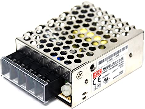

The electric noise at the output terminals of SMPS can be filtered quite easily and effectively.
The problem with SMPS is IMO the radiated noise. If you move around the SMPS a simple wire loop and monitor with an oscilloscope, you will see that the switching elements and the transformers emit a lot of HF fast rising pulses.
The SMPS has to be kept at a distance from sensitive audio circuits (and oriented properly toward them) and/or enclosure shielded. Else, some/all of radiated EMF will be picked up by the nearby circuits and cabling.

Thanks ! i wonder if putting it in a metallic box could help to block radiations
I will search about this. I am using the kind in the picture
