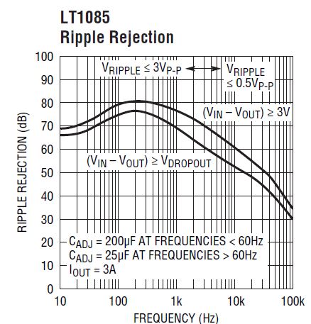

For lower Hz the usual lm317 (or a lt1085) provide some 70dB of psrr ... more than enough i guess

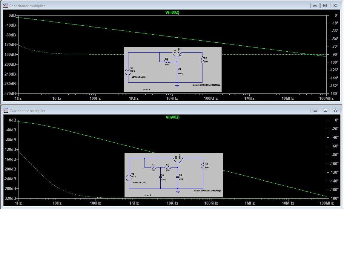

If you build one, take notice of the improvement in HF filtering properties of the cap multiplier you can have by simply using a 2nd order RC filter at the base of the transistor instead of the 1st order we usually see (same voltage drop on both scenarios)

Dear George i thank you sincerely. If i understand well the white lines are the psrr of the circuits vs. frequency ? how did you get those ?
Are these plots the outcome of a simulation ? which SW do you use ?
i will buy it immediately hoping that is not very difficult to use.
The second circuit performance is very impressive

And i guess that the same circuit can be mirrored for the negative voltages as well to do a dual power supply ?
Thank you very much indeed. Please tell me the name of the SW.

impressive indeed. But considering that the parts are few and cheap i could even put two identical active stage in series like i have seen elsewhere Not that i need more psrr of this ... i am amazed by how simple circuits can tackle the noise in such efficient way Unbelievabletake notice of the improvement in HF filtering properties of the cap multiplier you can have by simply using a 2nd order RC filter at the base of the transistor instead of the 1st order we usually see (same voltage drop on both scenarios)

But looking at the basic LM317 datasheet i already see a 70dB psrr at low Hz with a decline at higher Hz.
If i block these higher Hz noise with a cap multiplier i guess i am done.

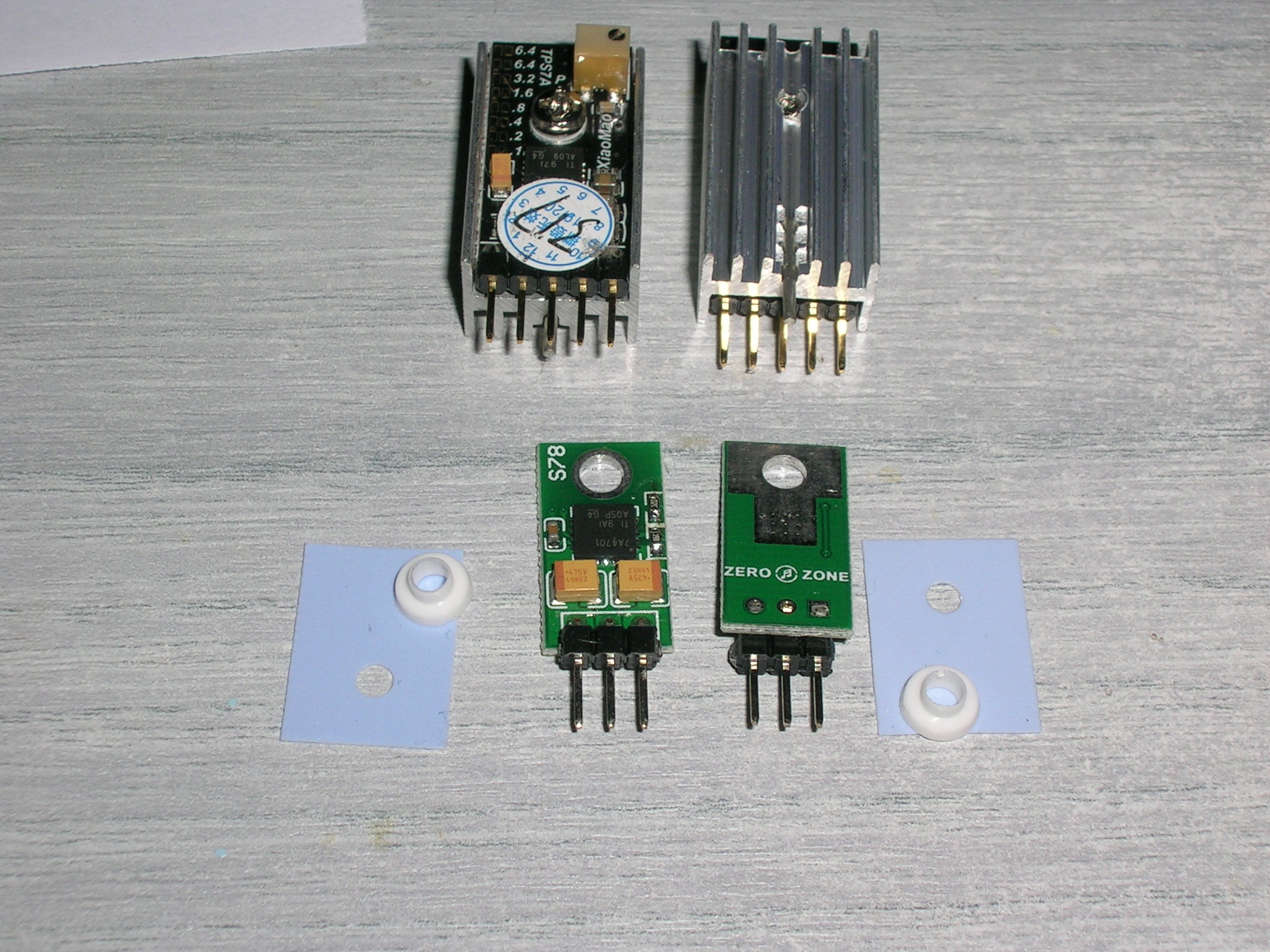

Last week I received four TPS7A4701 modules that I had ordered more than a month ago (28Euro in total).
In the near future I will test them in some low level applications against the older technology designs, although I have to admit I don’t hold my breath on the outcome.
