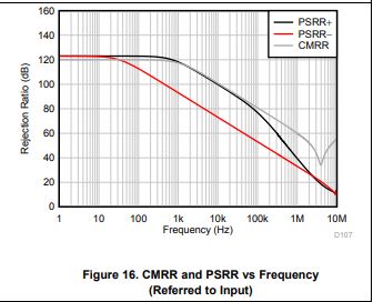

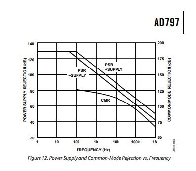

I have seen around very impressive noise floors ... i guess a lot depends also on some new op-amps that have an impressive psrr wideband. Like the opa1656 very popular these days
But also the old ad797 is quite impressive psrr wise.
I have no clue about discrete circuits psrr performance.

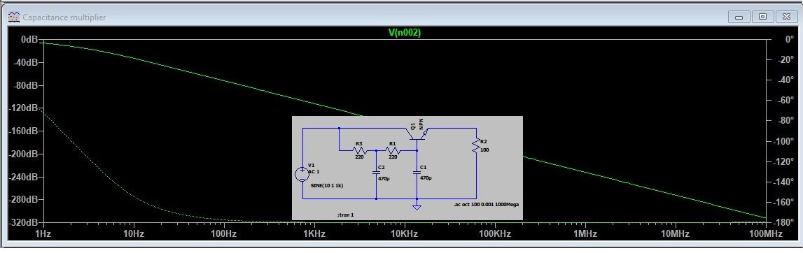

Hi ! thanks a lot for the valuable advice. I promise myself to study a little more but now my main aim is LTspice applied to psu I have the feeling that it is a very powerful tool ...

LTspice is a very powerful tool indeed. But, as with all simulators, you need to know what to feed it and how to interpret the results correctly. Don't make the mistake I did myself when starting this hobby, spending too much time with the simulator without understanding sufficiently the basics.
Hi ! thanks a lot for the advice. Let's say that the plot is very promising
And moreover i have seen darlingtons with 1000 to 5000 of hfe ... they seem born to multiply capacitance :eek:
I could try a two stages regulator ... the first stage with a zener diode to set the voltage needed and the second a CM ... both with the same darlington
And skipping on the noisy LM ... hoping that the darlington is less noisy :eek:

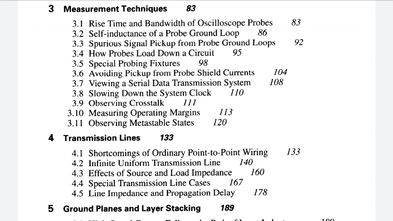

"High Speed Digital Design" is indeed very good, but seems to have a narrow focus which has no overlap with this thread, or indeed most audio.
- No, I don't agree. A half or more then a half of the book is about how to do things right (but not about digital design). A difference between low-speed analog cirquits and high-speed circuits is minimal.
Here is a part of it's content:
