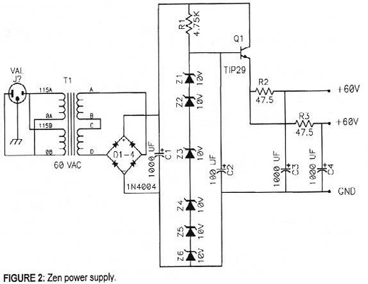

Years ago i was playing with a Bride of Zen preamp by Nelson Pass
Its power supply uses zeners followed by RC filtering (schema attached)
I think i could use the cap multiplier (CM) instead of the RC filter and get a greater psrr ? that CM will take care also of the noise from the zener diode ... hopefully
And the preamp was quite silent after all.
I would prefer the tip142t to the tip29 for its much higher hfe.
I would use just one zener ... even if i read that higher voltage zeners are noisier I have great expectations on the CM ... really great after seeing the results from sim Unbelievable psrr

Believing is done in church. I never simulated anything but built stuff and it got me there. Of course simulation can save time (which is the goal after all) but IMHO the knowledge should be in the head not in a program and experience is gained by doing stuff and measuring what you have created.

Hi point taken ... i should have said trust. I trust math and i trust also measurements. 😱
this is not a little thing. In a matter of second you can change some parts value and see if the circuit is stable or not ... its distortion ... calculate its gain Zout ... for me stability is the very key ... i do not understand at all the concept of stability.
