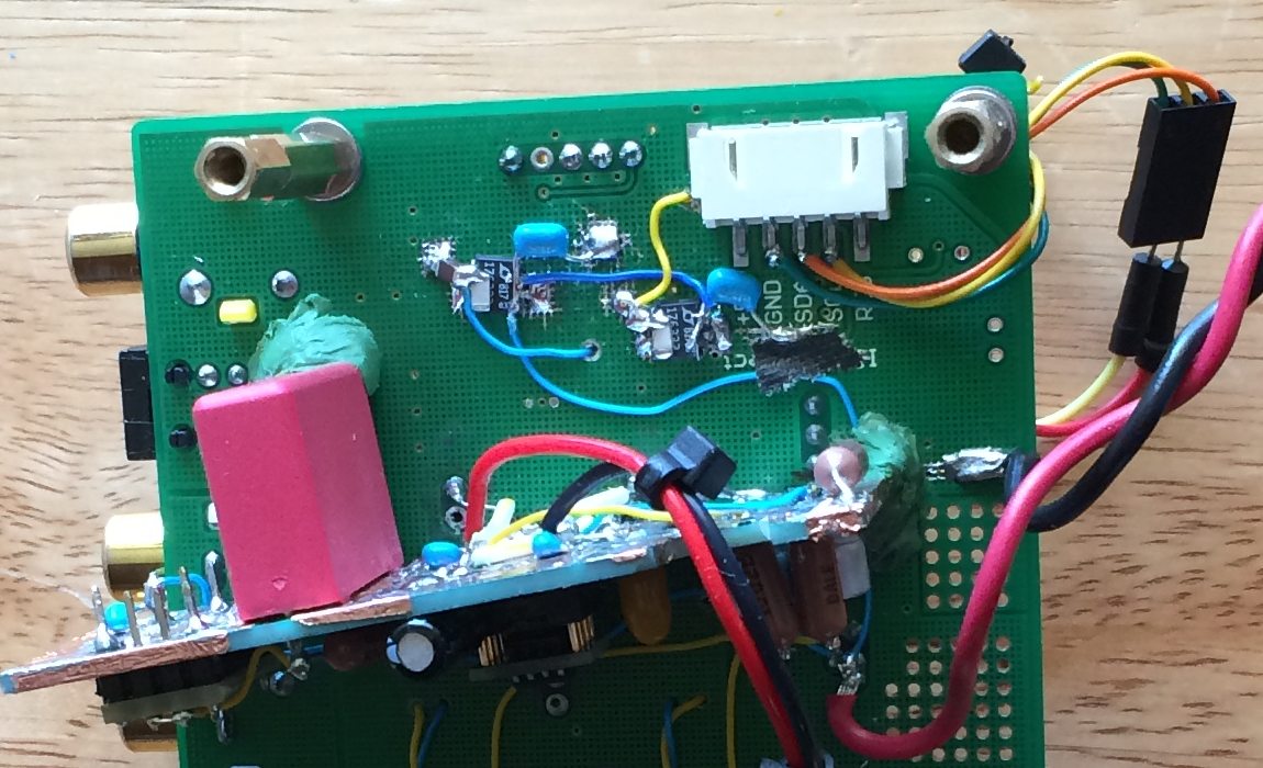

As Jean-Paul said layout is very important. If this picture is a representation of how you evaluate regulators it is quite clear that your results cannot be used even as anecdotal evidence.I would suggest to try LT304x for AVCC in an ESS dac. Then try a Jung. Which one sounds more like real music to you?
https://www.diyaudio.com/community/attachments/th_lt1763-jpg.710267/
* picture was part of this post https://www.diyaudio.com/community/threads/es9038q2m-board.314935/post-5577671
Other people in the forum have already done the experiment. LT304x always loses. Well implemented opamp buffers or Jungs sound better to most people. tps7a4700 sounds better than LT304x too.

The LT304x are sensitive to pcb layout for best performance as the AN points out and as Ive found. That could be one reason why they might be a sonic difference. I dont understand
why they dont apparently work well with the ESS if its not that but ok. It should be perfectly possible to see why if its affecting the AVCC. I was only pointing out that there other Linear regs out
there and I used the LT 304x as an example. There are others.

LT304x can sound very good for certain audio applications. Not for AVCC.
One problem with regs ike LT304x for AVCC is that they typically need C-II ceramic output caps for stability. Such caps are highly nonlinear and piezoelectric. IIRC KSTR reported AVCC draws current pulses at half the clock frequency. ESS dacs are probably most often clocked at 45/49MHz. How does LT304x with a C-II output cap look to the load at 22/24MHz? Also, its further complicated that AVCC has zero PSRR. KSTR also reported that high impedance at half the clock frequency increases dac audio output distortion. What is exactly going on with LT304x and AVCC that sounds bad? So far I haven't seen any good, complete explanation of that but I and others have tried LT304x for the obvious reason that it looks good on its datasheet. Other regulators were tried too. LT304x did not get the design win. Sorry.
