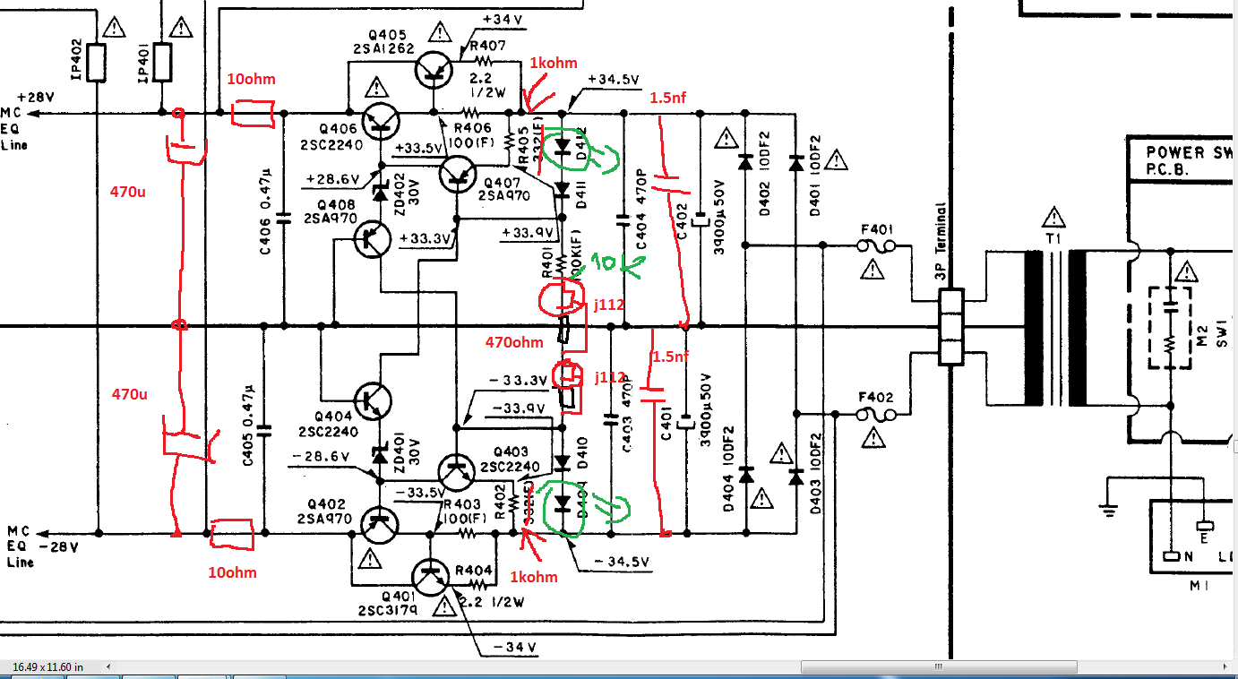

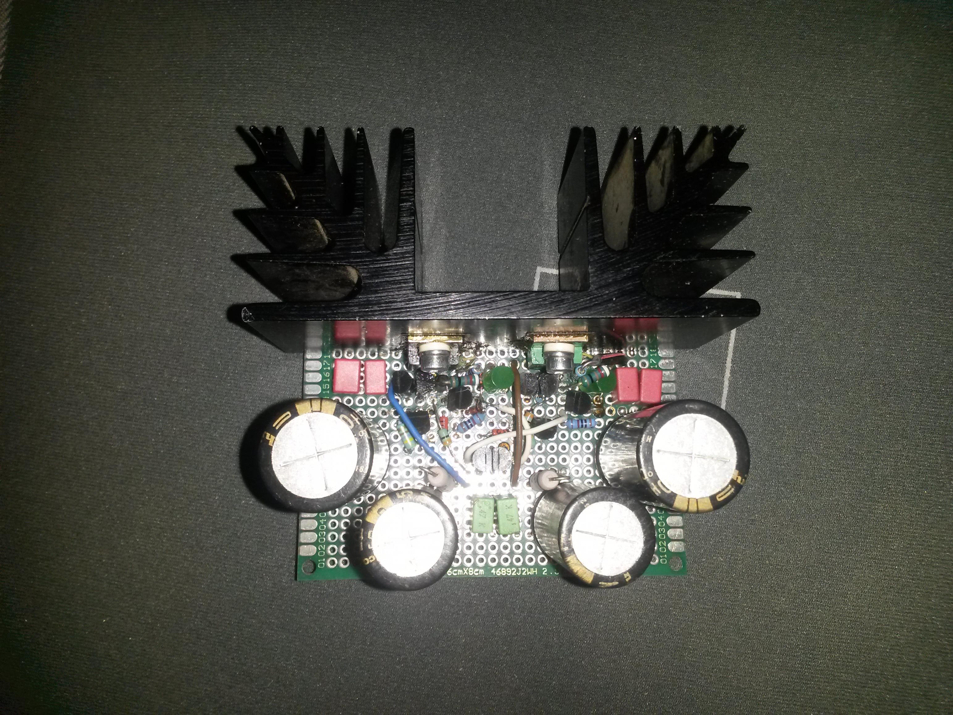

As this topic is Ginetto61 topic who was kind to send me a Nakamichi CA50 manual who's regulators happened to be very interesting for me i'll just show one that i finished today with some small modifications as i started with one design ,ended with another and didn't want to change the mods.I used Didden's idea for a green led refference biased with some j112 j-fet current sources of 2ma instead of the original Nakamichi 0.6v diode biased at 600ua , but i run te same bias current for the sziklai pair bias: 1.8ma by using a 1kohm emitter resistor which gives slighty higher noise, but better linearity for the current source biasing the sziklai pair.

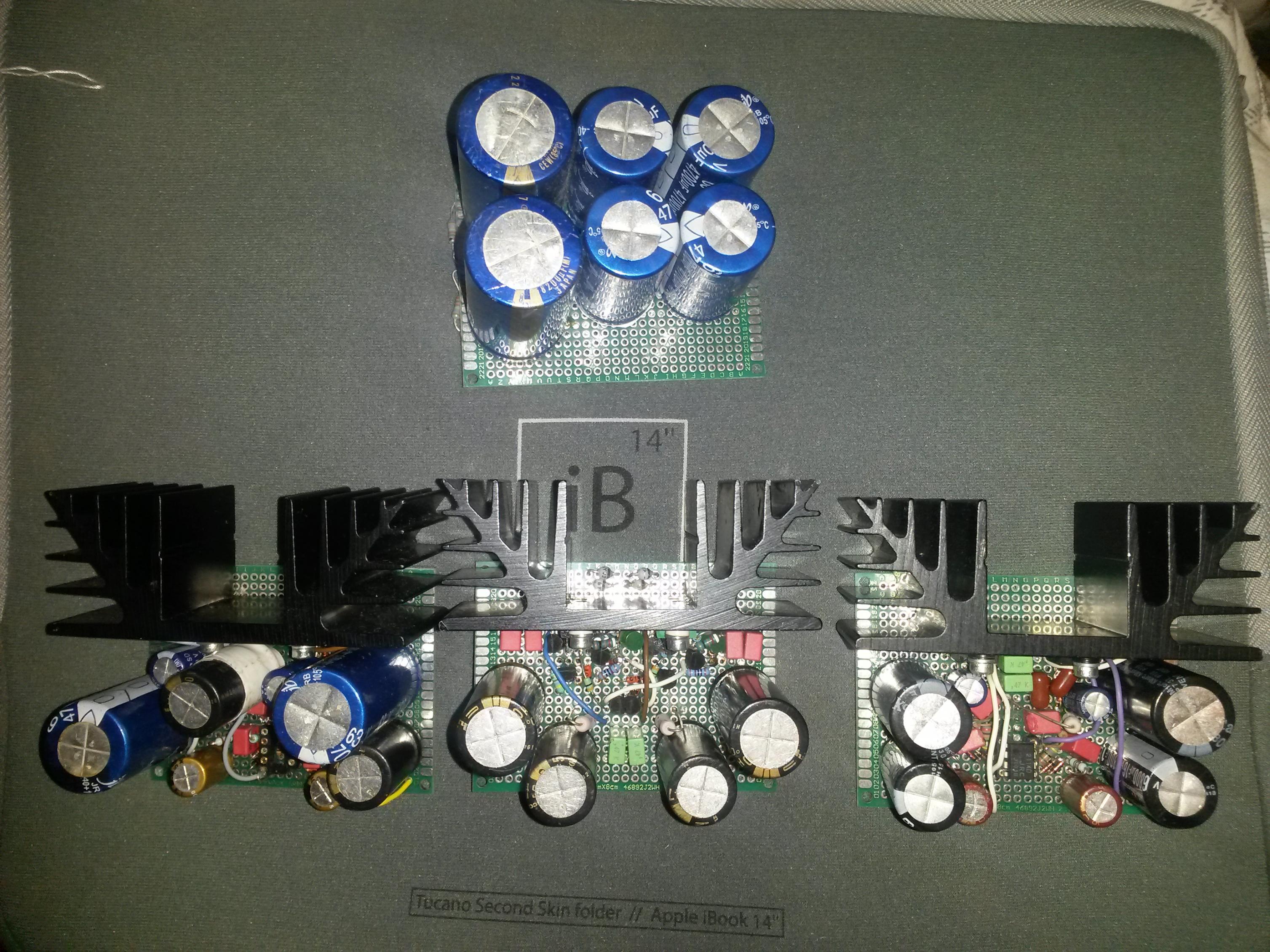

Thus i'm finishing a trio of voltage regulators,one +-30v,one +-20v andone +-10v that will be cascaded and supplied from a voltage quadrupler giving about +-43 v unloaded .The heatsinks aren't really needed as the multiplier can't hold those 40...43v for more than 200ma .

I think the R401 is only a start-up resistor.Replacing it by fets is useless.I used Didden's idea for a green led refference biased with some j112 j-fet current sources of 2ma instead of the original Nakamichi 0.6v diode biased at 600ua ,

I just wanted to make sure that the LED has a constant current through it but the base current of q403/407 needs to be noise free too as those transistors are providing the current to the output sziklai all the time.There's no feedback from the output and thus no start up ... just a continuous start up

i have no idea...What's bugging me is that in the schematic i see virtually no capacitor at those regulator outputs while if you see a photo of the real thing , it has tons of big capacitors...Interesting from a technical view but I wonder what it does for the quality of the regulated output

The current through D409,410,411,412 (or LEDs) doesn't come from the R401 but via ZD402-Q408 for D409,410 and ZD401-Q404 for D411,412.That are the currents from the sources Q407,Q403 minus the base currents Q406,Q402.I just wanted to make sure that the LED has a constant current through it but the base current of q403/407 needs to be noise free too as those transistors are providing the current to the output sziklai all the time.There's no feedback from the output and thus no start up ... just a continuous start up

Yes, you are true about the original design...i just left the jfets there because i started with a different regulator in mind , switched to this one , then just thought that they can't harm as removing them is quite a problem due to this type of pcb i am working on , but i agree they are kind of useless due to q404/408. Now the start-up sequence is suspended due to continuous bias done by the j-fets.I might remove them later if i consider so.The green LED are actually in parallel with some 5v1 zeners as removing the zeners now from that pcb is a horrible task.The current through D409,410,411,412 (or LEDs) doesn't come from the R401 but via ZD402-Q408 for D409,410 and ZD401-Q404 for D411,412.That are the currents from the sources Q407,Q403 minus the base currents Q406,Q402.

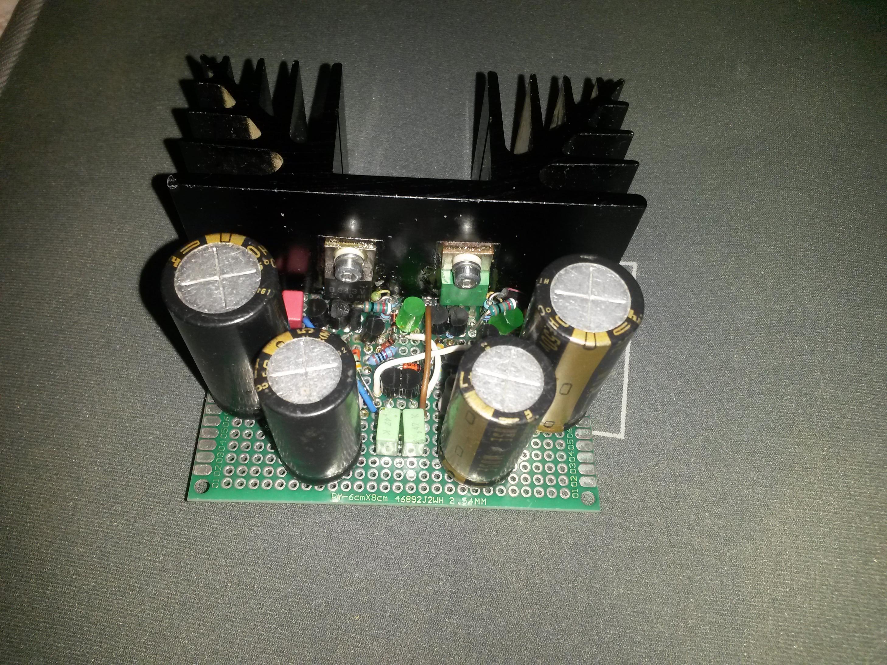

In the end i needed to revert back to the original design as the fets weren't equal and the voltage multiplier couldn't hold the +-43 v under 250ma load, dropping to 31v leading the regulator to go down to +-26v instead of +-29.The current through D409,410,411,412 (or LEDs) doesn't come from the R401 but via ZD402-Q408 for D409,410 and ZD401-Q404 for D411,412.That are the currents from the sources Q407,Q403 minus the base currents Q406,Q402.

final measurements: 29.2v into 150 ohm load with an input voltage from the quadrupler of +-34v which is good enough for me.I won't probably use more than 100ma in all the circuits i need to supply.In the end i needed to revert back to the original design as the fets weren't equal and the voltage multiplier couldn't hold the +-43 v under 250ma load, dropping to 31v leading the regulator to go down to +-26v instead of +-29.
