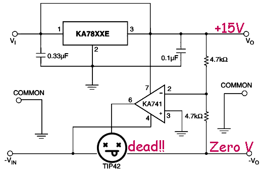

...tracking is good when one rail fails so that you won't get dc current at the output of an op-amp or worse when left with one rail only.....
Tracking is *usually* one-way. Negative tracks the positive, or the other way. In the example attached, if the + fails, the - will fall very low; but if the - fails (for example a blown power transistor) the + is not affected (does not even 'know' the - has failed).
Yes, there are cross-cross-tracking systems so any failure kills all. (Usually for more complex many-rail systems.)
Your point about asymmetrical clipping is valid, but how different do you expect your two rails to be? 1%, who cares? 10% is hardly audible. 25% is "a sound", and a fuzz-guitarist would care..... but regulators normally hold 5% of nominal or else dead. Anyway clipping is (except in fuzz music) "bad", and avoidable.

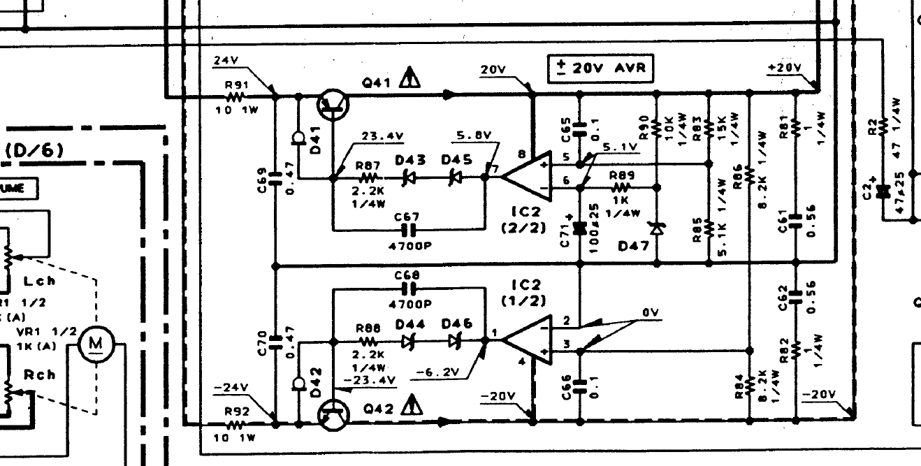

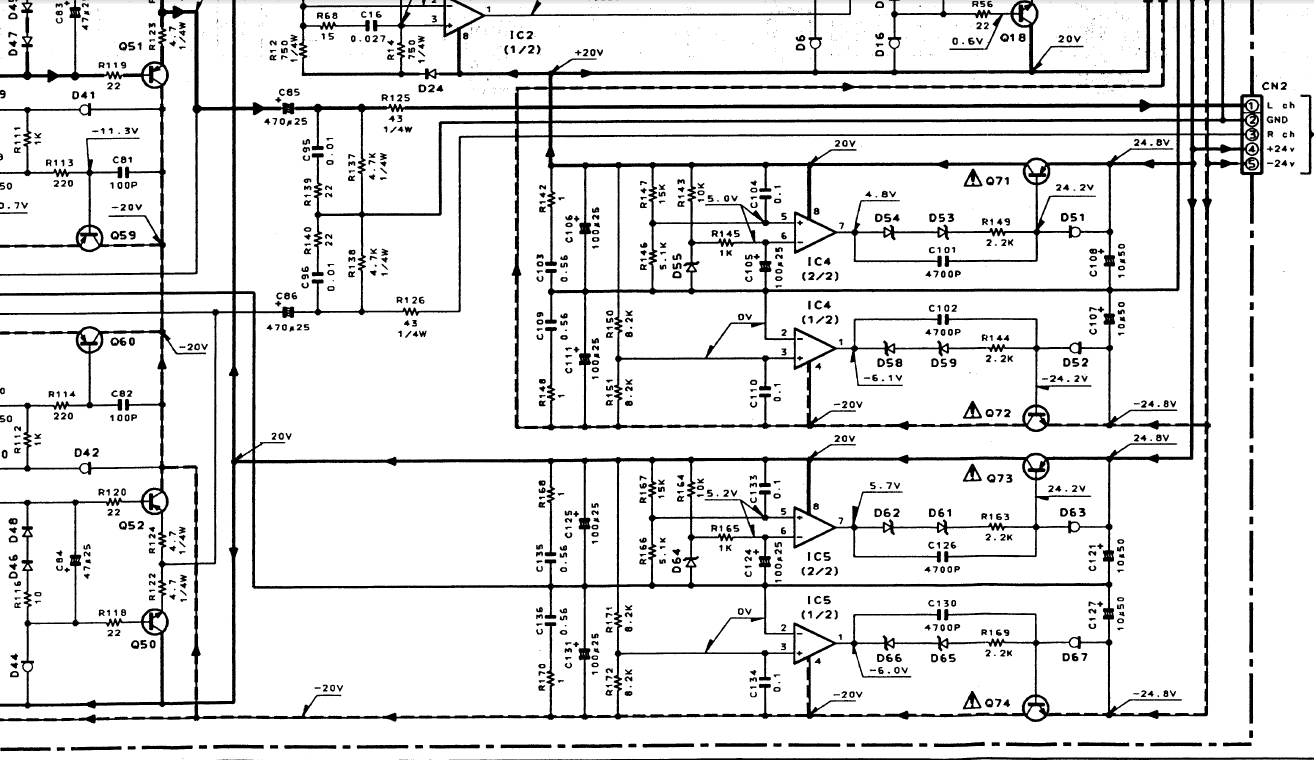

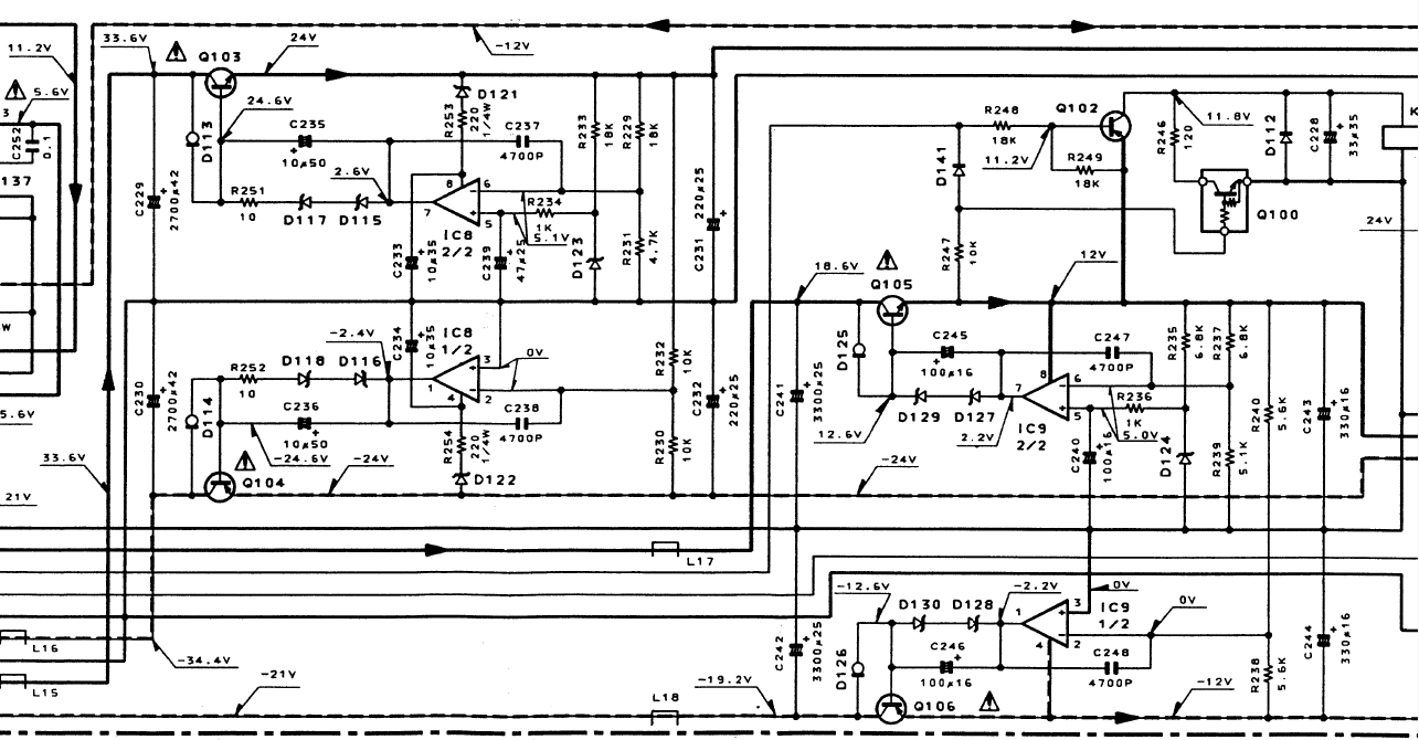

I just saw something different in the kenwood regulators.So that amp (kenwood l-a1) has two general regulators generating +-24v and +-12v supplies.The +-24v regulator is supplying two other regulators of +-20v for the lower noise stages.
Now here's the interesting part: the +-20v regulators have the power transistor's collector and emitter reversed for more gain, while the +-24 and +-12v regulators are the clasical regulators we all know with some more compensation .Could somebody explain that choice?

Power transistor emitter collector reversed....
I see all is symmetric Plus Minus wise. Nothing reversed.
For a series regulator there are two ways to do it at the power transistor. Emitter at the load side or collector at the load side.
Collector at the load side is used when looking for Low Drop. This for single or Darlington, another story which Slizar ( pnp + npn ).
the phono preamp and first stage of the amp regulators have the collector at the load, but i'm not sure they did it for low drop reasons...having higher gain makes the ripple lower but that can make the whole regulator oscillate ad that is probably why they used c65,c71, c104,c133
