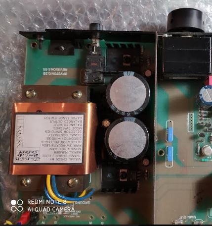

Changing the transformer solved the problem, the spike and buzz was largely gone. The replacement was the same VA size and physical design, it must have had a/ better quality iron or b/ ran it at a slightly lower magnetization level.
