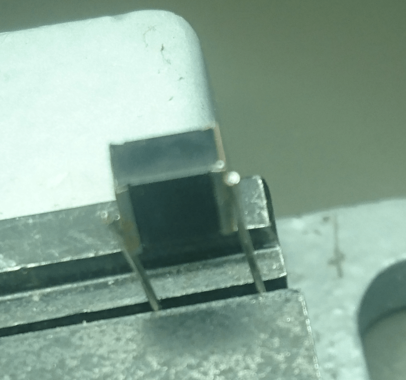

I wonder whether SMD film capacitors indeed have substantially more inductance than similarly-sized SMD ceramic capacitors. I would expect SMD film capacitors to have a stacked construction, similar to multilayer ceramic SMD capacitors. Of course other disadvantages of SMD film capacitors are that they are relatively expensive and that some have a dielectric that easily melts during soldering. Any through-hole capacitor will have substantially more inductance than an SMD capacitor because of its leads.
I have cut one open, if I remember correctly, made by WIMA.
That was like a normal standing foil capacitor with the wires
bent upwards on the thin side again with a clip welded to each side.
Not too impressive. PE probably does not withstand the temperature
needed for direct face metallisation and board soldering without
the wire.
Non-PE may be better.

That's a similar one. You can see the solder clips. I did solder wires to it
to put it on the bridge. 470.1 nF @ 1KHz.

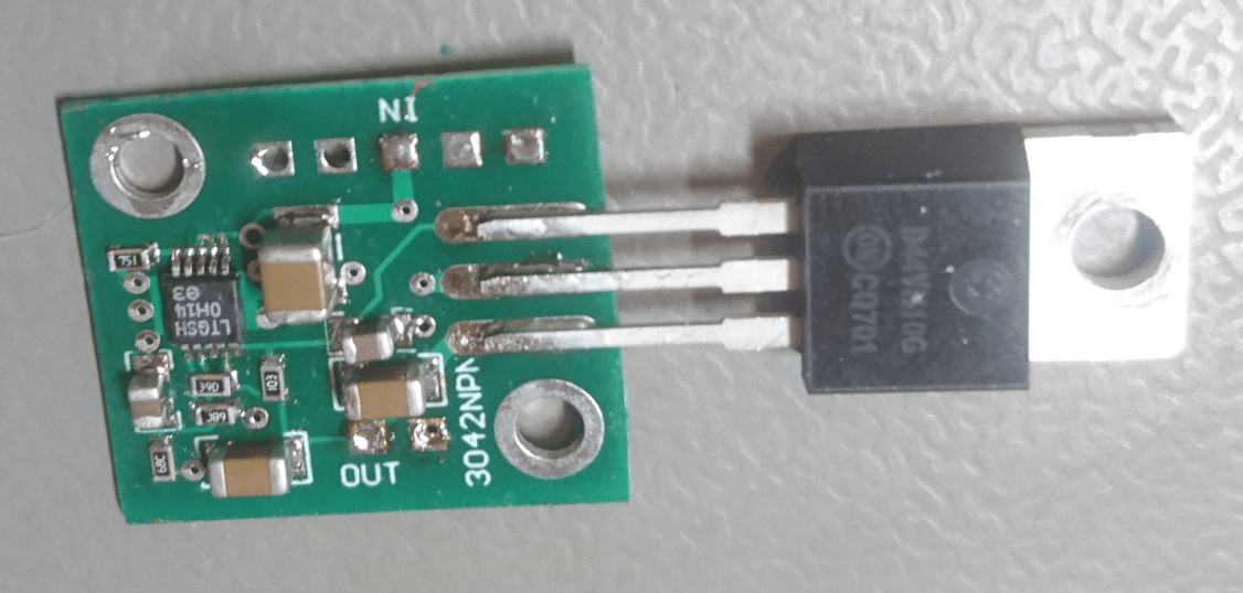

@ chris719 : no, I did not try this. The follower of the 3042 is quite week;
I could use an op amp just as well with less solder problems.
What I'd really want is a lt3042 for grown up men. Say TO-220-5
even when PowerGood is missing. The pic to the right is the circuit with
the npn from the data sheet. Practically the same performance as the
barefoot chip.

But no longer LDO ?
Patrick
6.35Vin for 5.0V out @ 3 Ohm load minimum. That's what it took to feed my crystal oven until it is hot.
Probably I had more voltage for making the noise measurements.
