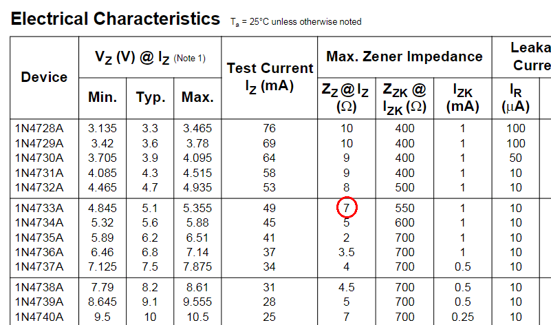

Calculate the -3dB rolloff corner frequency when the zener's dynamic output impedance is "R ohms" (from datasheet) and the parallel capacitor is "C=100nF". That's the frequency at which the capacitive bypassing poops out, and ceases shunting the zener noise to ground.

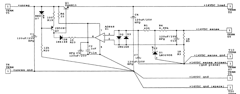

There's a reason why Walt Jung uses an RC ladder filter in the Super Regulator instead of a bare naked capacitorr.

Just so folks get the reference -- from "High Performance Regulators, Part 3" :There's a reason why Walt Jung uses an RC ladder filter in the Super Regulator instead of a bare naked capacitorr.

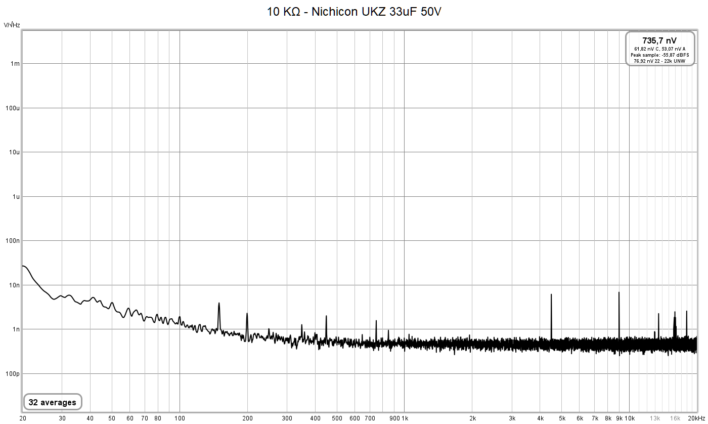

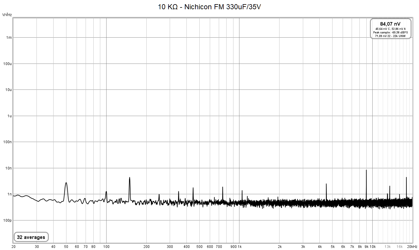

Here are some measurements using LNA with 0.445 nV/sqrt(Hz). Capacitors are Nichicon UKZ 33 uF/50V and Nichicon FM 330 uF/35V. Respective measured leakage currents at 2.5 V were 0.33 pA and 1 pA. Measurements were made with 44.1 kHz sampling rate. With 33 uF, total noise is considerably higher due LF noise contribution.
With 330 uF, noise is almost the same as LNA noise floor which produces 68 nV noise (22 -22 kHz).
I verified suspiciously low leakage of Nichicon Panasonic FM 330 uF/35V. There was 3 remaining in the bag and all have 1 -2 pA leakage at 2.5 V. I don’t know whether that is “golden batch”, as other various FM/FC series capacitors in 120 uF – 220 uF and 35/50 V range has an order of magnitude higher leakage, or this is usual for this specific capacitor.
Datasheet specified leakage numbers are for the absolute worst conditions (tolerance, max. temp. and voltage). Actual leakage numbers for room temperature and fraction of rated voltage are, IME, up to two orders of magnitude lower. Measured leakage numbers were obtained 5 min. after applying voltage.
