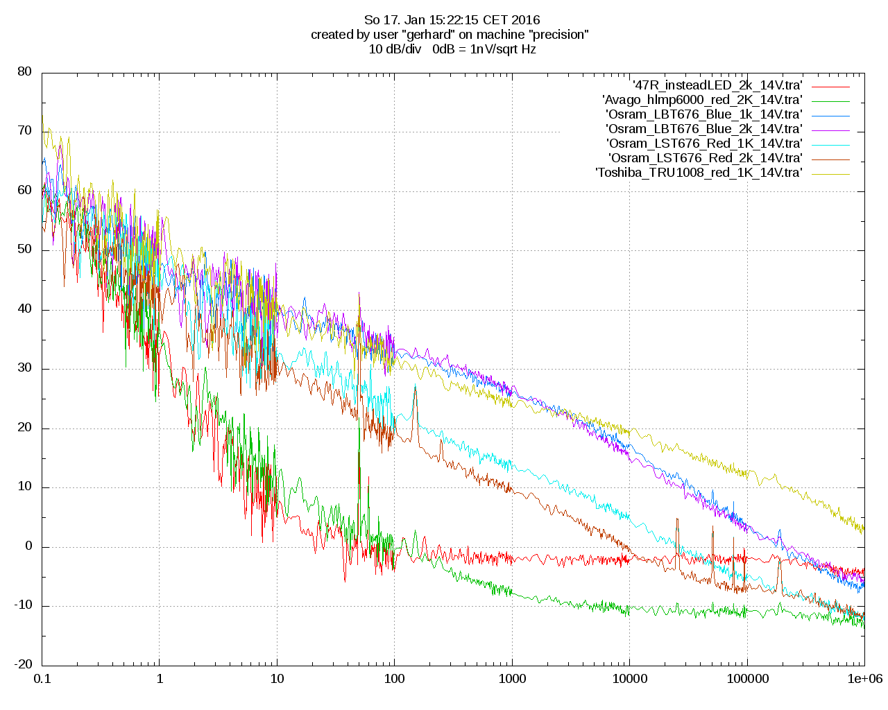

I suppose voltage reference is not for some instrumentation DAC and some small and slow temperature related drift is not a problem. If so, why not to consider Walt Jung’s LED based voltage references. Noise density for a basic 2.5 V GLED reference is from 2 to 4 nV/sqrt(Hz).

@JensH, I've been using Walt Jung references for a long time and I think they're worth a lot more than that one ZTX and the green Lite-On LED.
An ordinary zener diode can be used instead of an LED if you want to achieve precision, but then the noise is higher .
If you are interested in the exact temperature drift of the GLED431, I can measure it for you this week, I use them in all regulators for 5V in my DAC.
The best LED, noise wise, that I have seen is the hlmp-6000.

0 dB is 1 nV/rt Hz, bias is 1 or 2 KOhm NiCr wire from 14V NiMH cells.
The trace with the 47R shows that the bias supply does not add any significant noise.
