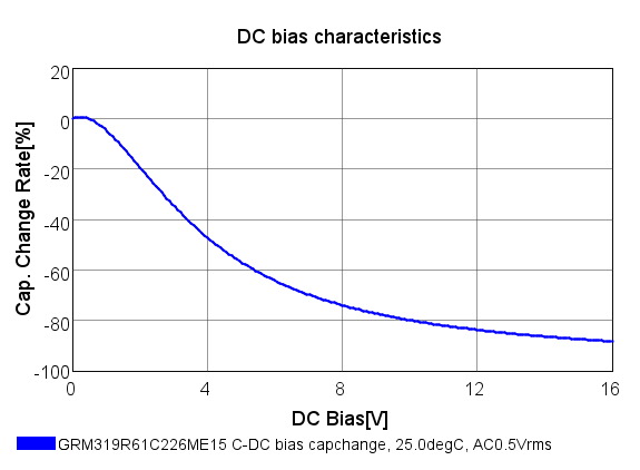

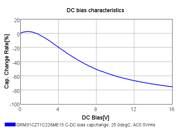

Murata 22 uF 16 V 1206 X7R
Murata 22 uF 16 V 1206 X5R
Both are pretty awful to me, even though the X5R capacitor is indeed worse than the X7R in this example. The working voltage and manufacturer also make a big difference, most of Murata's class-II capacitors are even worse than those of their competitors. You typically have to search the websites for characteristic curves to find data like these, the datasheets barely contain any useful information.

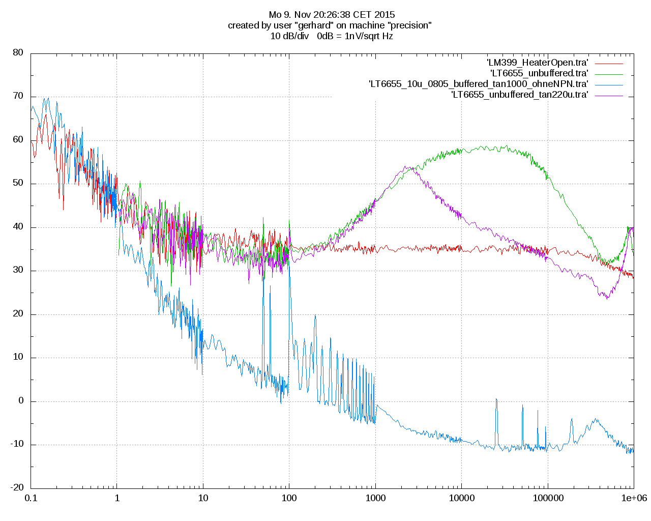

Then why a precision refference and an op amp buffer with very high psrr and cmrr(if low impedance is needed) wouldn't be ideal for that?
You actually get quite far with filtering a precision reference, even a noisy band gap such as a LT6655. For a band gap ref , the LT6655 is actually quite good, but still far away from LT3042 etc.

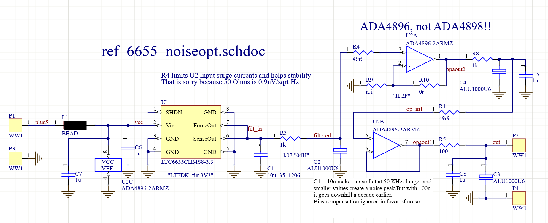

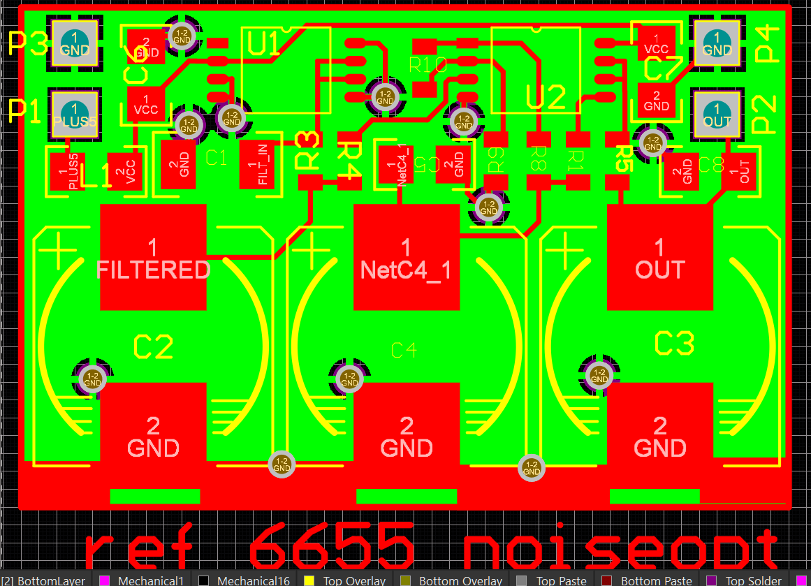

This here is a quick & dirty test because I might have needed a ref for LT2500-32 ADC and had some free space on a board that had to be done SUBITO.
It is measured laying open on the lab table, and fed from a channel of a R&S NGT20 power supply. Therefore there are lots of 50Hz harmonics. I was only interested into the noise. 0 dB is 1nV/rtHz, about the input noise of an AD797 or LT1028.

Marcel, I fully agree with you. I was mainly trying to correct the IMO invalid claim of Jean-Paul's regarding XR5 being substandard.
Which turned out to be valid. So again, X5R is inferior to X7R as it suffers more from capacitance loss with DC bias so one has to derate even more than usual. Therefor X7R is a better choice. There is almost no reason to choose X5R but choose X7R and upward!
Both are crap when compared to C0G and film but we have to use them in some cases.
Slightly inferior = inferior. I would not call it slightly BTW. Why choose them?
Yes both are crap as already stated. It is like choosing which s**t stinks less. Capacitance loss with DC bias, Piezo-effect, some are hygroscopic, some develop cracks in them after some time with some brands, bodies of the caps becoming loose from the contacts. Things one will not experience as much with, for instance, molded TH film caps.
Their main qualities are low ESR, low ESL and of course key parameter low price.
Updated unfiltered voltage reference noise list, extended with the LTC6655:
85A2 (glow discharge): 648.8 nV/sqrt(Hz) and 85 V, so 7.633E-9 Vref/sqrt(Hz)
National Semiconductor/Texas Instruments LM723 (Zener / avalanche diode), June 1999/April 2013 datasheet: 86 uV from 10 Hz to 10 kHz at 5 V output voltage, so 172.1E-9 Vref/sqrt(Hz)
LM317 (bandgap): 0.003 % of Vout from 10 Hz to 10 kHz, so 300.2E-9 Vref/sqrt(Hz)
uA7805 (bandgap): 40 uV from 10 Hz to 100 kHz at 5 V, so 25.3E-9 Vref/sqrt(Hz)
LT1236 (buried Zener reference): 2.2 uV from 10 Hz to 1 kHz at 5 V, so 13.98E-9 Vref/sqrt(Hz)
LT3081 (unknown, presumably bandgap): 5.7 nA from 10 Hz to 100 kHz at 50 uA, so 360.5E-9 Iref/sqrt(Hz)
LT3042 (unknown, presumably bandgap): 6 nA from 10 Hz to 100 kHz at 100 uA, so 189.7E-9 Iref/sqrt(Hz)
Diodes Incorporated TL431 (bandgap), June 2021 datasheet, not recommended for new designs: 230 nV/sqrt(Hz) at 2.495 V, so 92.18E-9 Vref/sqrt(Hz)
OnSemi TL431 (bandgap), August 2021 datasheet: 48 nV/sqrt(Hz) at 2.495 V, so 19.24E-9 Vref/sqrt(Hz)
Bandgap reference based on 1960's Electronics Letters article, schematic attached to https://www.diyaudio.com/community/threads/return-to-zero-shift-register-firdac.379406/#post-6881707 (bandgap): 29.784 nV/sqrt(Hz) at 4.96 V, so 6.005E-9 Vref/sqrt(Hz)
LTC6655: 17 nV/sqrt(Hz) at 1.25 V (Analog Devices datasheet page 7): 17 nV/sqrt(Hz) at 1.25 V, so 13.6E-9 Vref/sqrt(Hz)
The LTC6655's white noise is pretty low and it has a very low 1/f corner frequency, well below 10 Hz.
