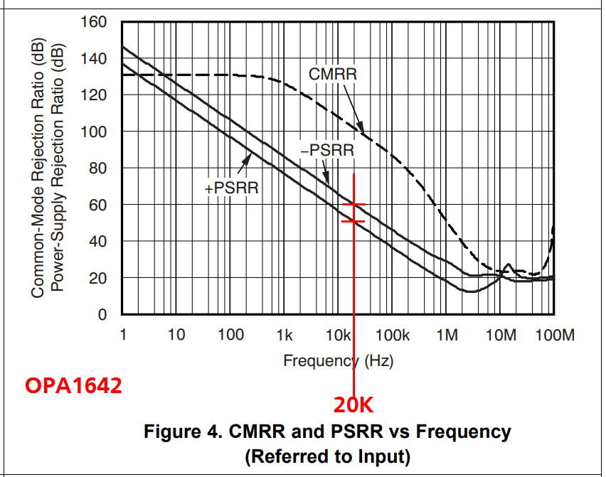

If your [modern] opamps stages have say 80 dB PSRR at 20 kHz (and 20-30 dB better than that at LF)
Here is the OPA1642 ; 50 dB PSRR at 20 kHz in the worst case
