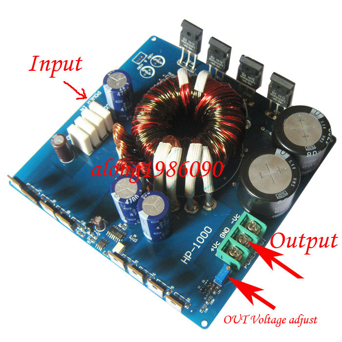

1000W Switching boost Power Supply board
PCB size:160mm*152mm
Input voltage: DC9-16V
Output voltage:±48V——±60V Adjustable (at 12V input voltage)
Regards
Juan

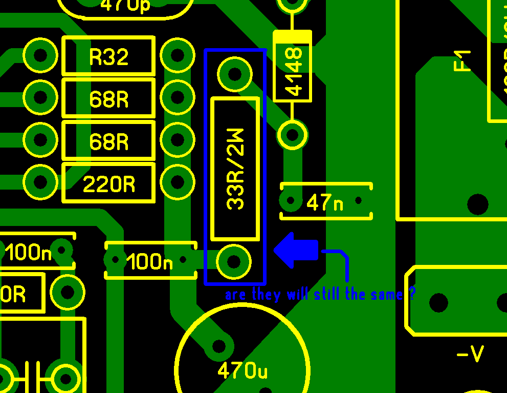

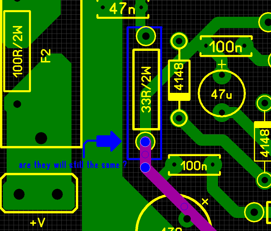

Hello Sir, I,m not so sure that using those diodes in place of the resistors is such a great Idea. If the fuse should blow this will place one rail of your supply on the output. I know dcv don,t sound so good. Evette
that is a suggestion from Carlos I still going to use the 33R resistors but I'm writing all tips from him and this forum all info from you guys has a lot of value for me.

Uops!..... Joe is right!
Do not install resistors.... the way Joseph said, if fuse blows we gonna have supply rail in the output.😱
Sorry, my mistake.
Thanks Evette.

33R 2W will still as the original schematic
😵 uhm? I'm scare now je je je je ok got it! is all good..... hey wait! about the resistors... do you mean don't install those diodes in place of the 33 ohms 2W resistors isn't that correct? ay mama mia! " Mario " je je je je

Yes...put resistors back in place.... 33 ohms and 2 watts
Sorry man.

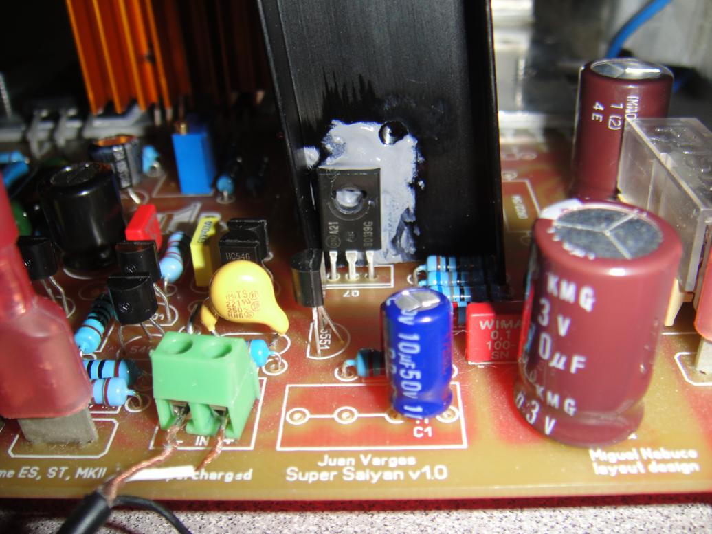

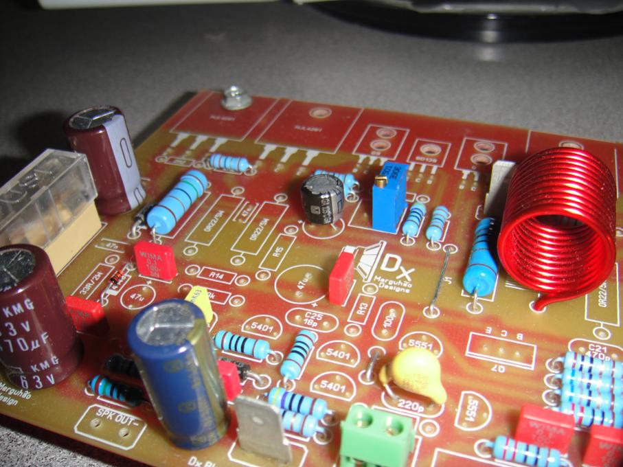

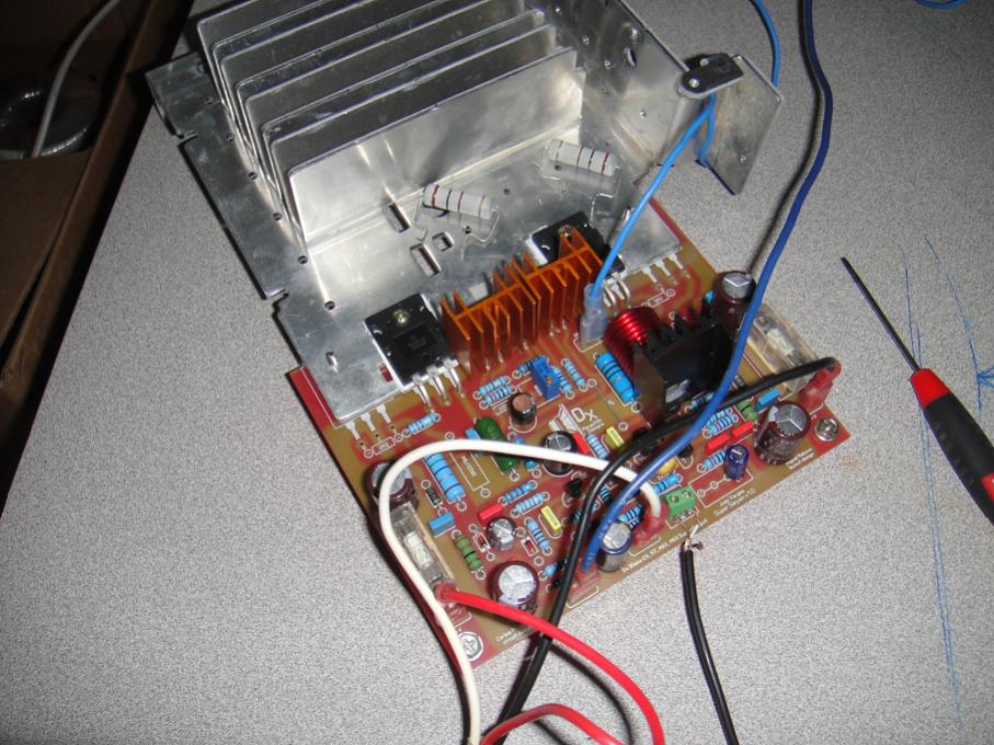

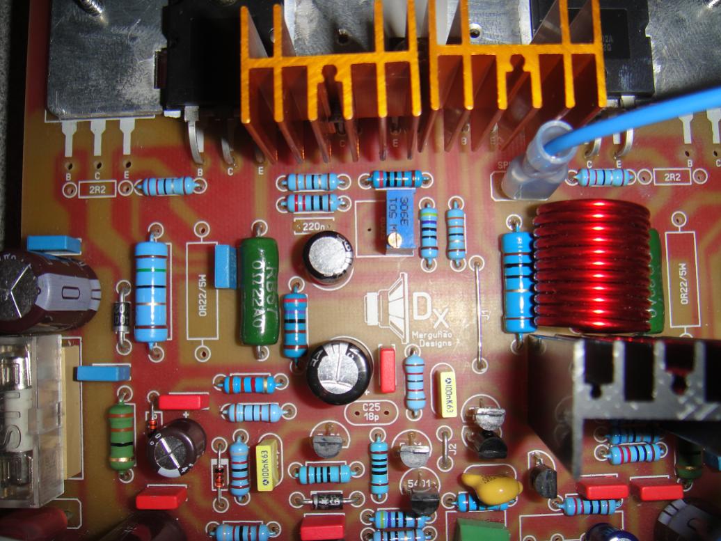

I got Dx Blame ST working but...
Hey Carlos when you get a chance I have Dx Blame ST multiboard working but it does not sound clear tweeters and mid range, maybe because I'm using low voltage supply I only have +24 0 -24 supply or maybe I by mistake place a wrong resistor or cap, but sound of bass is really clear and deep bass here is my " test station" images 😀 also there are no distortions and no heat up components, no burn out, is just that I don't know why it does not sound clear is like it has a low pass filter or something I got check tomorrow with patience at least I got it working 🙄, also to be more descriptive a place my ear close to the speaker and there is no humming sound at all just like Dx Blame MKIII Hx maybe you know what part of the area is controlling the trebles and mid I'm not sure where to look for if you can help me out I really appreciated.
part that I use tranies:
BD139
BD140
BC556
BC546
MJL3281A
MJL1302A
Regards
Juan

I see a single electrolytic used in C1 and think this may be wrong. You need to use a non polarised capacitor in c1 or you can use 2 electrolytics with some track mods. In that case the 2 electrolytics become a single non polarised capacitor. If you use the second method you will need 22uf electro's to make a total c1 of 11uf. Please see attached pdf.
Regards
Simon

weird things happen I got to check...
But the cap I'm using it is BP non polarized that is the weird thing 😱 , but the thing is, all work fine I can adjust the trim pot with no problem it does respond after a check the voltage it does what it suppose to do, also check the output voltage in AC reading and give me 0 volts just t like the instruction in the website, but at least I got to work the first time that is weird too lol because I always build something and I got it working almost 99.99%, and this is the ST I could just build the Supercharged if I want it but I already have MKIII Hx, " that Army MOS 94F" got me going on lol, well my friend thanks for point me out that I'm going to try two caps to see is that the is reason I don't have the highs and mids clear, " bass is good" excuseme for what I'm going to said, " I'm happy like a mother fuc#$%$^**# for this build lol 😀
Regards
vargasmongo3435
Regards
vargasmongo3435
0V as measured at the output means nothing.output voltage in AC reading and give me 0 volts
A DMM that reads 0Vac or 0Vdc is telling you that the voltage at the output is less than half a least significant bit.
That is equivalent to saying the output when the reading is 0V is actually anywhere from -499mVdc to +499mVdc or upto 499mVac.
Yes you right my dear Andrew I just cut the detail explanations I just writing in plain simple English I'm not trying to sound too technical lol and yes my multi reads 0.034m's "something", is cool bro but I still have the problem I change the C1 to a really small size 1uF and not respond so now I now is not C1 the problem what could be ?
