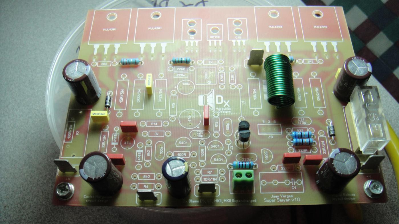

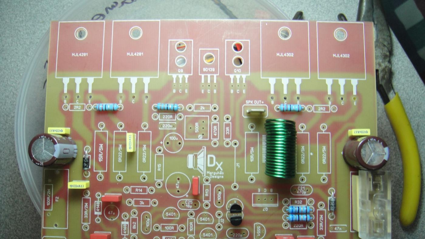

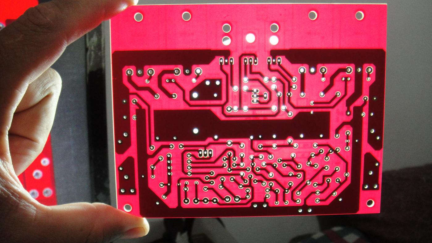

just to see how it looks some parts
I'm just testing how it looks with some components so far so good...😉 don't mind the yellow capacitors is just to check if the 5MM pitch is correct lol

About the pcboard dear Juan
It is a compromise the decision about copper track size.... yours are very thin, this is good because increase clearance in between copper tracks, this reduces a lot the capacitance.
But, as sub product of this, if you put too much heat, they will detach from the fiberglass base...this happens when we make substitution of components, soldering and removing the solder to replace parts. then the copper track, and the component lead island, goes detached from the substrate.
I would increase copper track thickness, at least 50 percent, in order to help to dissipate heat while soldering....i know...now it is too late to do that.
Everything can be improved, evolved, developed.... one day we must decide to stop..about these pcboards i have stopped..but you have re started...so, if you offer these pcboards layout and details for people to build, then please, increase these copper tracks thickness...not the copper itself, but how large it is, decreasing a little the clearance in between them but making them better to receive heat without detach from the fiberglass sustrate.

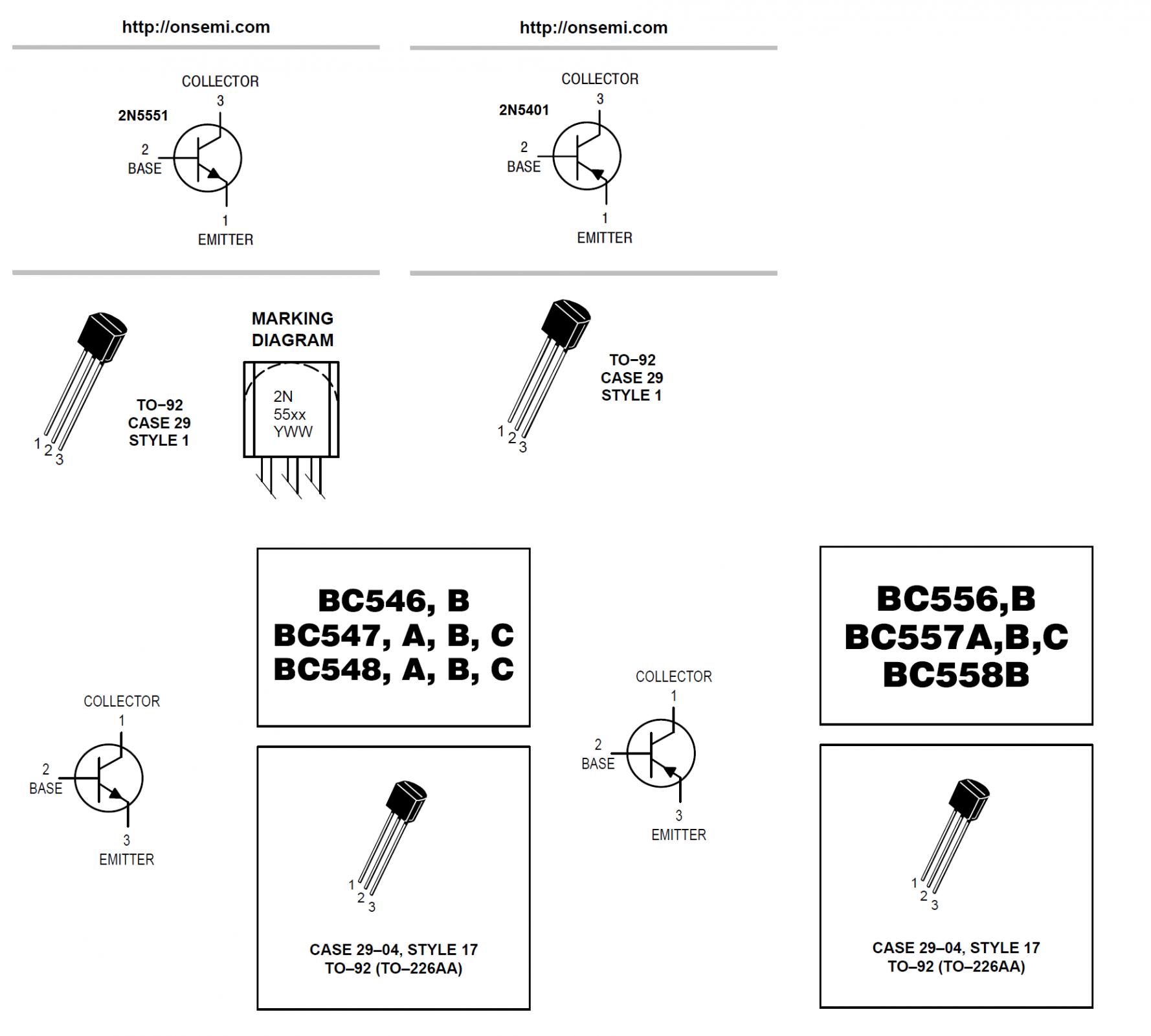

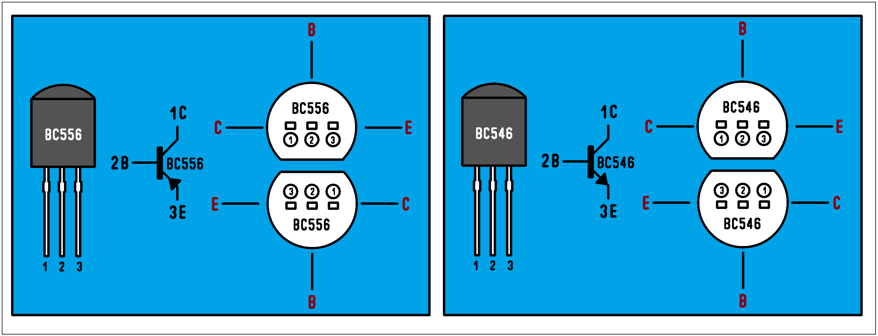

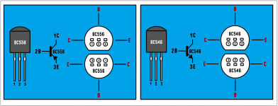

By the way Joseph...when she return, then ask her to replace transistors by BC546/556 and also BD139/140 into your 30 to 42 volts supply amplifier...do it one channel only and tell me about the difference.... the video in the signature line below shows you the output...try these ones Joseph (i do think you have sent them to me...am i wrong?) ...new charge of energy will be going soon..but will be small power charge but longer time one, avoiding blood pressure to increase, avoiding pain this way.... this time only me will transfer some energy.

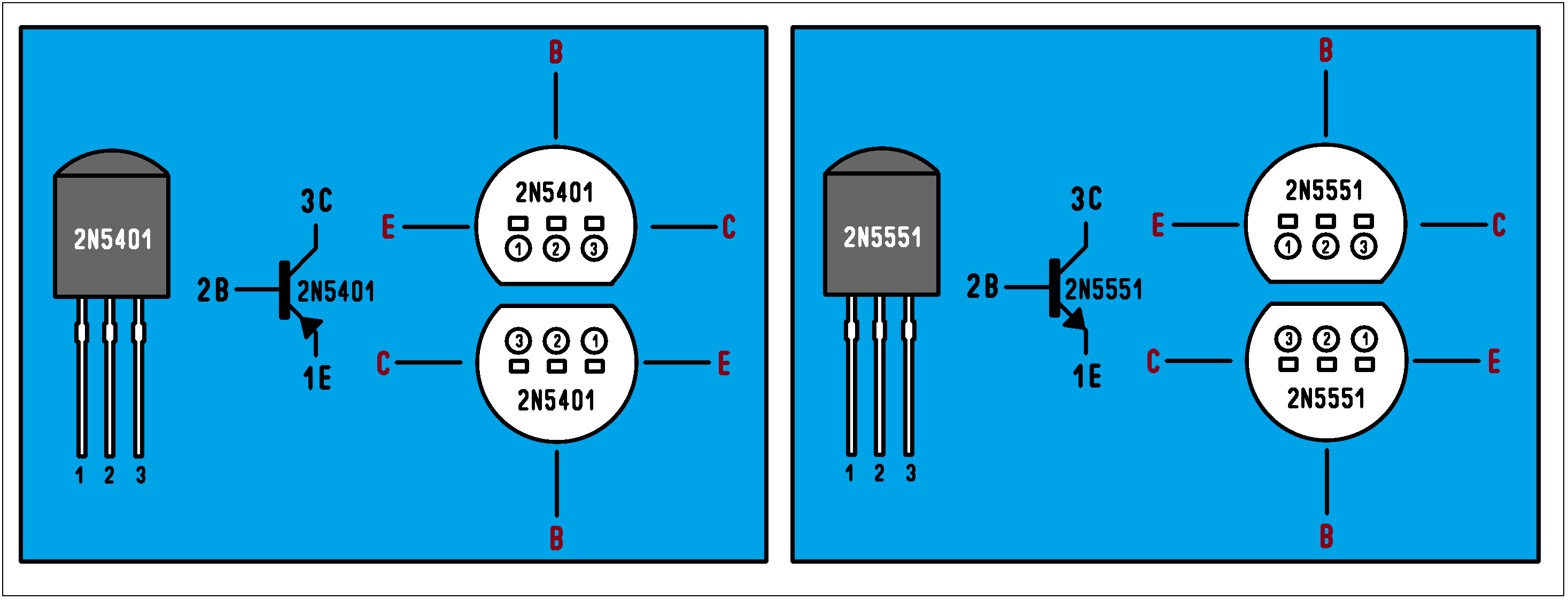

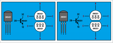

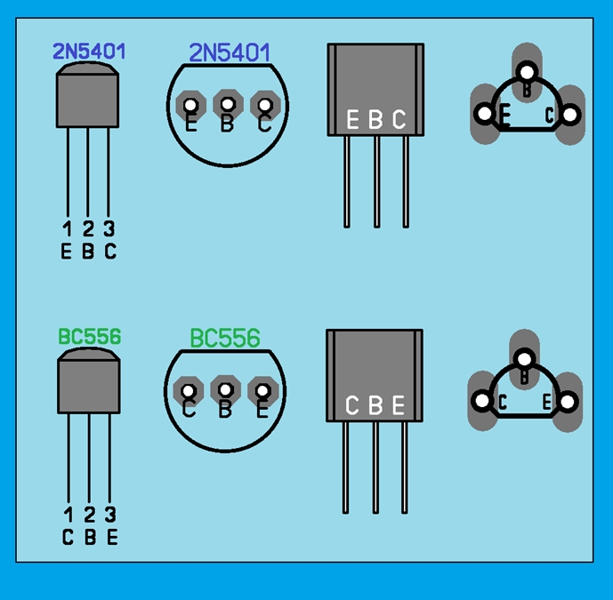

Found and error on my drawings
Hey guys found an error in my drawings here are the correct ones. 😀 so the orientation change 180 turn if you are to use BC556 instead of 2N5401.
Regards
Juan
Thank you Juan, as you have fixed the drawn
I do suggest builders from Dx amplifiers to try BC transistors...i do believe they result better, a better match with the circuit and voltages..... a better sound in the reproduction.
But this should be used if your supply goes from 30 to 42 volts only...to other models that uses higher voltage supplies, then keep the suggested 2Nxxxx and MJExxxx models.
