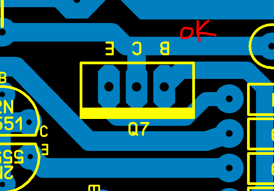

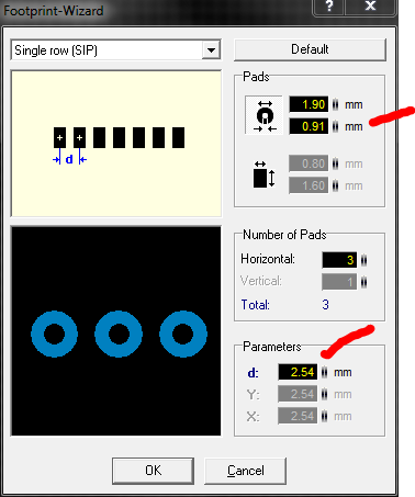

If you are asking for plated through holes, then the drilled diameter must be larger to allow for the specified plating thickness.
Through pad or regular pad?
Hey Rudi I like your style on your PCB really unique! 😀 , hey man I got a question for you, is better to have the "Through pad" or just the regular one as you see in this images, and Andrew yes about the pads for the transistors I was referring to the hole diameter I made a mistake and make them too small I just want to point out that but now they have the correct hole diameter, something similar happen with Dx Blame MKIII Hx the 1N4007 diodes the hole were too small so that can happen to anyone and you know Alex MM is a [PRO] on that about layouts, ok about the "through pad question" I want an opinion from you guys what is the best choice "though pad" solder on both sides, or just regular bottom solder?
Regards
vargasmongo3435
Regards
vargasmongo3435
"Plated-through-holes" means: double-sided PCB, which costs much more than a single-sided PCB and is more difficult to unsolder a component, in case you did an error.
I would go for a single-sided PCB, if I were you, even if there are a couple of tracks that you will have to solder manually using small wires.
Best regards - Rudi
Best regards - Rudi

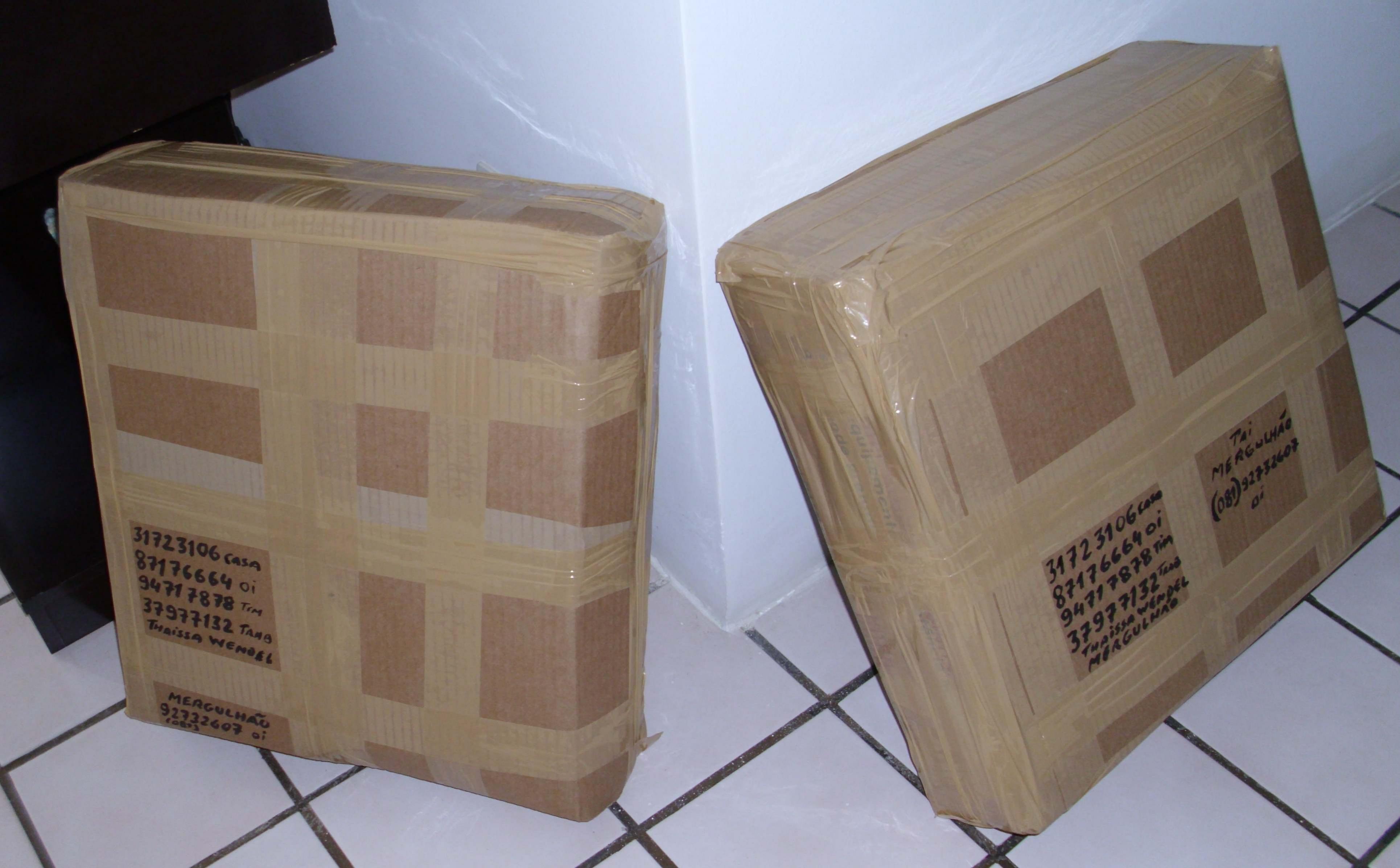

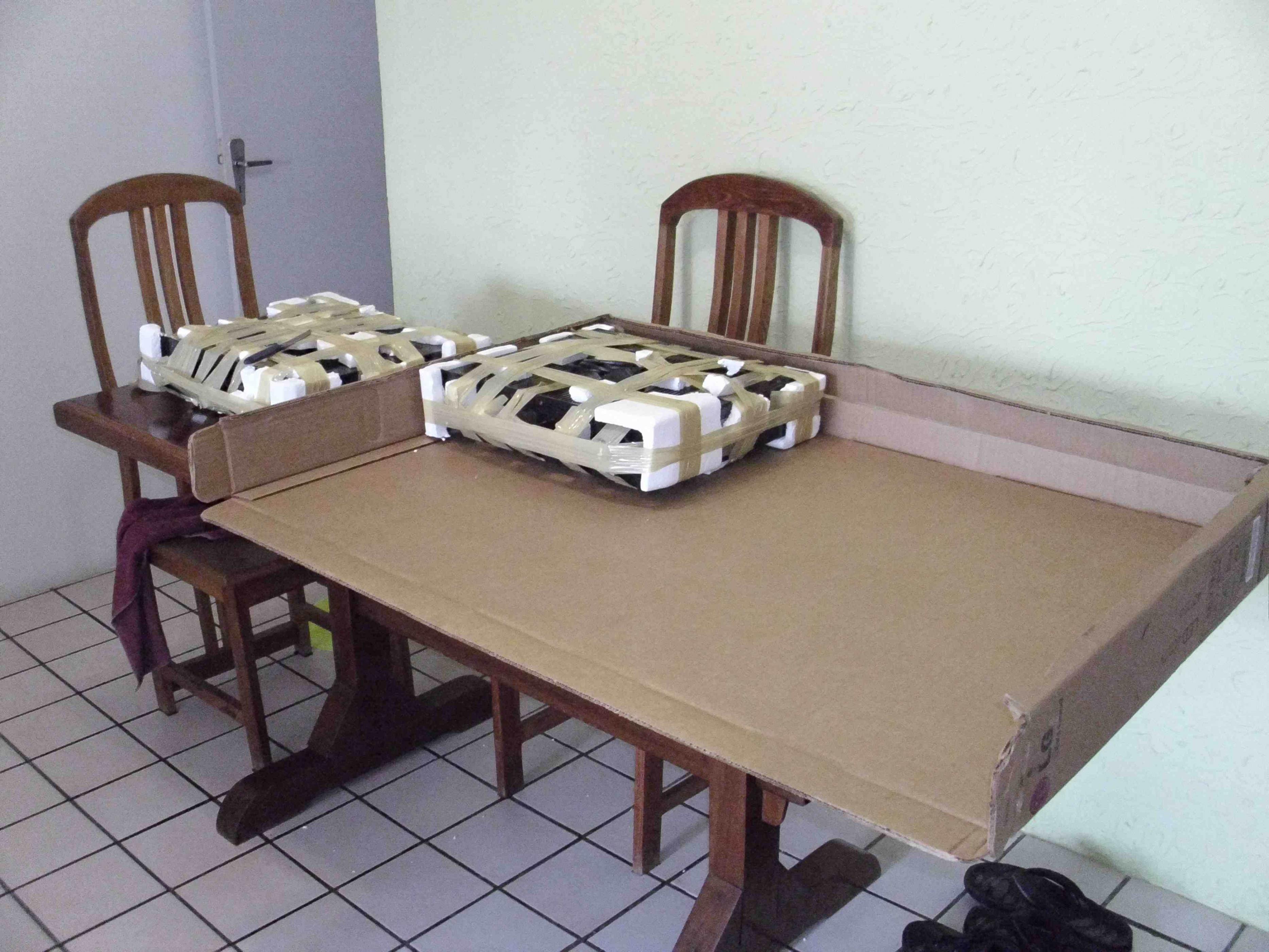

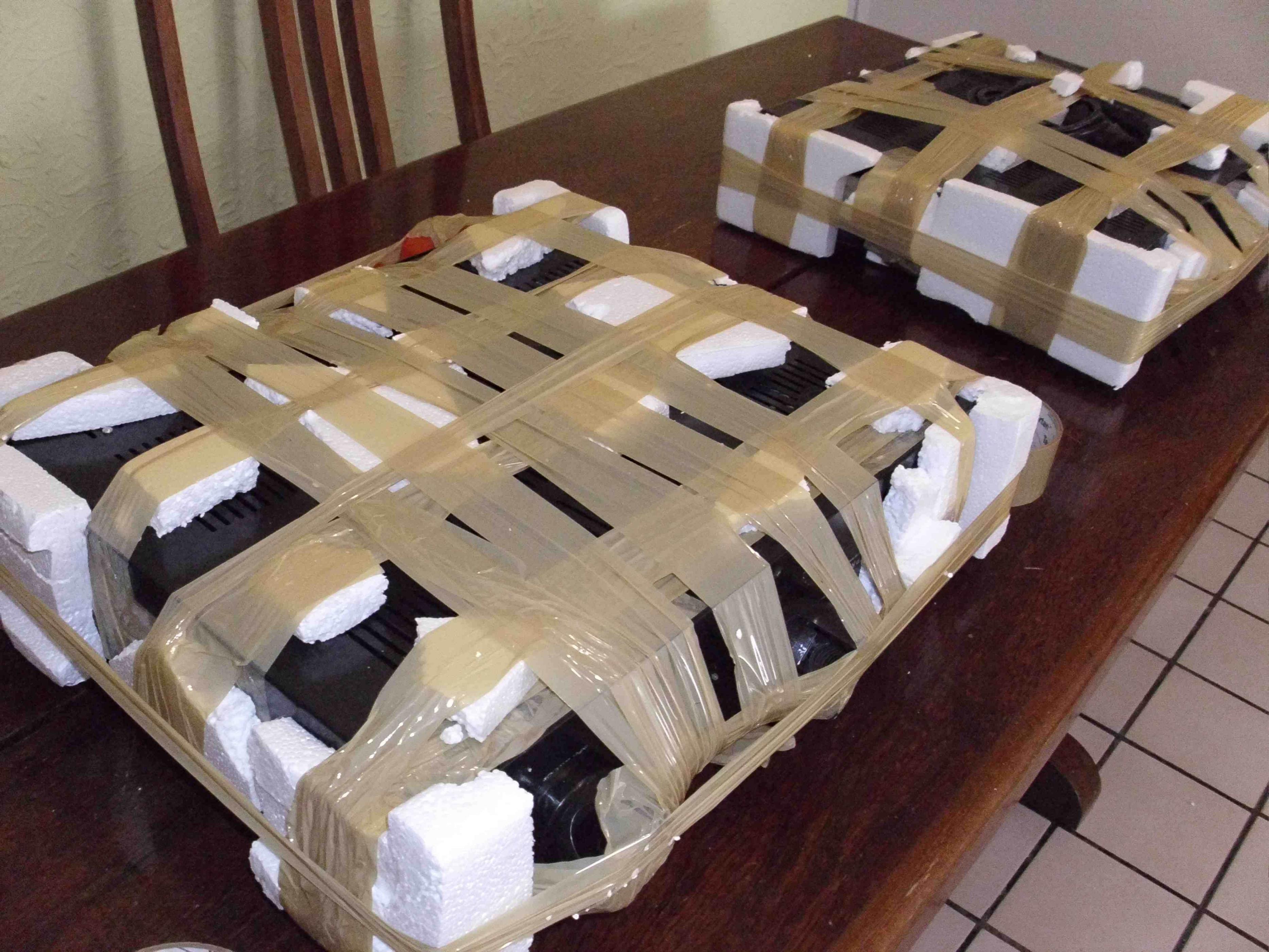

I do trust in my amplifiers because they were deeply tested and tortured...i am sending two units to Rio de Janeiro, a gift to my sons, together the amplifier there's a pen drive with videos ... and i am told to my kids:
- "Take care of this unit, all schematics and documentation goes together the package...this is the best you can have in audio amplifiers, it is huge and will survive your daddy...enjoy!"
If i did that to my own sons, you can imagine how i trust and appreciate this unit....if you have a son you will understand what this means...we never give bad things to our sons.

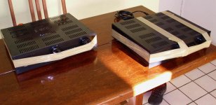

Getting ready for stereo!
I'm ready for "stereo" I was putting together the other board and at least I solder must of the resistors, and I have to take a break my eyes were really tired because I'm not only check the color code of the resistor I also check with the multimeter to make sure is the right resistance, because sometimes when you in a hurry you look away for a second and grab the wrong one by mistake it does happen, but yesterday I was chilling listen to the other channel playing some Sade wow nice!,
but talking about resistors next time I'm going to use the 1/4W ones because looks more nicely on the board but in the same way this 1/2W blue ones don't look that bad at all so is 50/50 😀 yes I'm crazy 😛 . About the MICA capacitors this time I have the right ones two 100pF and one 220pF this time no like the last time that I installed two 100nF and I didn't get treble sounds I be like WTF! 😛. This time I'm going to replace R20 to 150 ohms instead of 470, on the first board I keep the R20 as 470 ohms, that is why the adjustment I have to turned so many times because of the 1K trim pot but still able to adjusted to 3V, after the board is completed and going to adjust the bias to 3.3V, "I mean the best I can" lol, so I'm really satisfied with the sound quality I was playing music for about 3 hours yesterday "with normal volume of course" really nice and I don't have expensive woofer or noting like that, all the speakers I have are "recycle" so imagine how good will sound if I have two 10" woofers mid ranges and I nice set of tweeters oh Lord that would be lovely! ok... ok... sorry I went away for a minute lol, take care guys!
