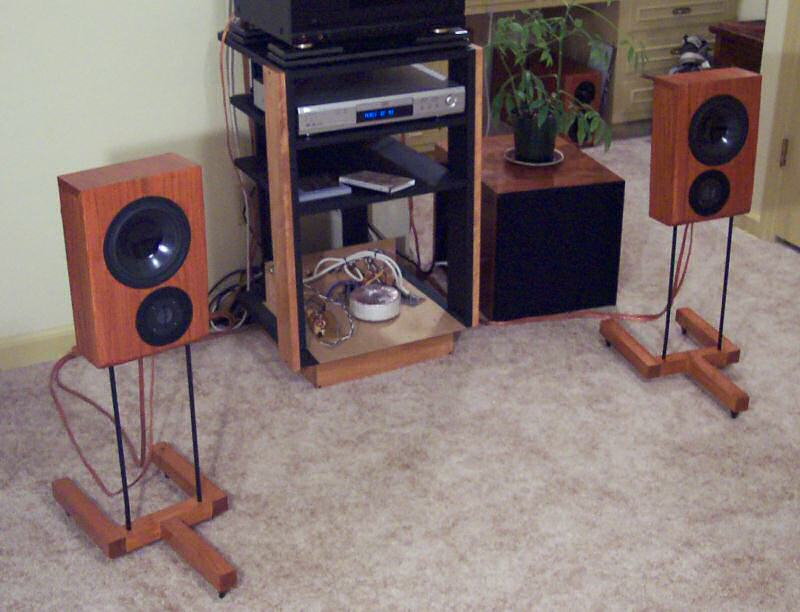

I dont know if I posted in this thread yet, but here are my open baffle dipoles. The sub is an open baffle dipole, with two 12's in a w-frame as outlined on LinkwitzLab. The Mains use full dipole equalization and are crossed to the sub at 90Hz.
-Paul Hilgeman

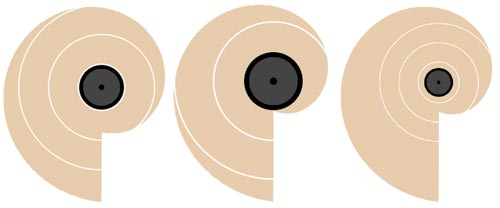

Hi Erik,
I agree with your assessment of the inherent symmetry of the circular baffle and like your concept of the spiral shape. I wonder, however, what the effect would be of the discontinuity as you reach the end of the expansion and drop straight to the smallest radius. Could be a great place to mount a long ribbon tweeter...
Not sure what you mean by droping to the smallest radius.
The way I see it is that the descent starts at the point where the wave first starts dropping off the baffle, then gradually decreases until the wave length is larger than the outermost point on the baffle. The length before the wave begins to drop off should dictate at which frequency the drop begins (at least in my mind ;) ). I wonder if I can use a baffle large enough and cross over to the sub at the point where the wave equals the baffle's longest length - with the aim of avoiding the wild peaks and troughs that would result after this point?
Another thing to take into account may be something that Kuei mentioned about wavelaunch, which may dictate the minimum point from driver to baffle edge.
RE. Linkwitz site. I coudn't find the intro theory I was looking for last time I looked. Will have another sniff around.
Let me try with pics...
I've changed two variables here which I think are directly related to the point where the drop begins (second image), and the rate at which the drop occurs and ends (third image).
I'll be the first to admit that I know very little about all this. So please tell me shut up if I'm chatting rubbish (and correct me).

An oblong or egg shape would have the same symetrical issues as a circle I think. If there really are symetrical issues.
Yes the reason people have the baffles go to the floor is that you get a free lunch- the equivalent of a a very large baffle, which keeps the baffle overall from needing to be as big as it would otherwise (which would be very big I believe)
I was also trying to point out that tilting the driver so that it isn't on axis with can be a good thing- it rolls off the upper frequencies
which is something a lot of wide range drivers emphasize. Sometimes too tilted wil creat an uneven response however.
So my interest is how to best transition from the part on the floor which is a huge edge of the baffle, to any other side, which is much shorter.
