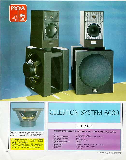

For anyone designing a dipole sub, have you researched the Celestion 6000? Very interesting design!
