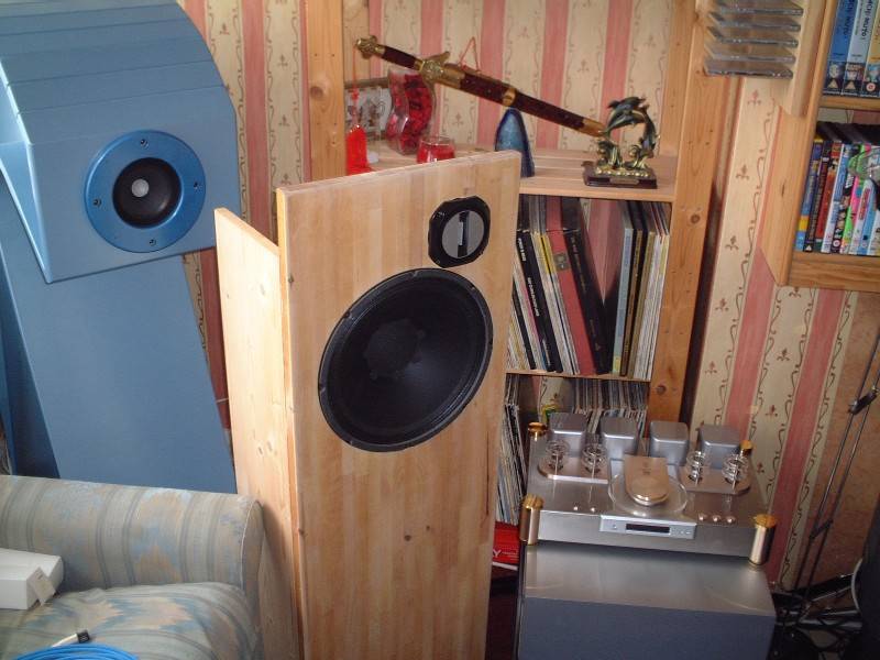

Playing now and sounding astonishing (after re-locating the driver to the Baffles front and messing up my nice routed out and rounded off rear mounting hole to cure a certain nasilty likely caused by my excessively thick baffles). Have a look.....

More....
Konnichiwa,
For those interested in details, the Speakers use a pair of 12" 'Wideband' Drivers custom made by Eminence for Bastanis Audio and further modified by Bastanis Audio, combined with a Beyma CP-21 Slot radiator.
These are on an Open Baffle for which I used Ikea Pronomen Solid Wood (butcher block type) Kitchen worktops, 124cm X 38cm 36mm thick.
Crossover is a single capacitor and series resistor on the tweeter, nothing on the woofer.
To go with that you get a pair of 12" subwoofer drivers and a Thomessen (Germany) Subwoofer "Plate Amp" rated at 175W/4Ohm with a very large number of adjustments (variable phase 0-270degrees, adjustable LF EQ are the more unusual ones).
I put these into a slightly undersized enclosure (compared to the recommendations by Bastanis) which is in fact the silver Box under the Shanling SACD Player (the player is not in the system, just parked). I've added a small RC EQ circuit in the subwoofer inputs to EQ out the increased System Q.
More on the Kit at:
http://www.memphis-highend.de/memphis.html
Last time I looked cost was €1,250, well worth it.
Sonically this system reminds me a lot of my 15" Tannoy Monitor Reds in corner enclosures, but with in some areas SUPERIOR performance, though also some small problems whic I hope will reduce with burn in....
Sayonara

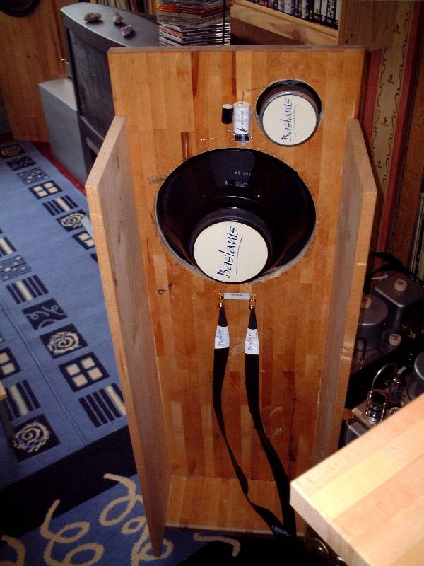

I did so by placing both woofers and fullranges in "clamshell" arrangements and wiring them out of phase (this kills most of the noise), then playing high level pink noise literally for several weeks.
Rudolf said:
And he asks for the FR speaker to be mounted behind the baffle.
I did try this but suspect the thickness of my baffles (more than twice the originally suggested thickness) caused problems. I did check with Mr. Bastanis about it, he thought it should be fine, my ears diagreed so I moved the drivers to the front of the baffle and the problems vanished.

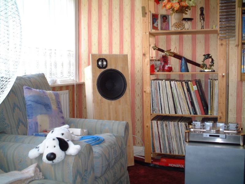

Listening impressions and positioning
Wow, I didn´t realize you had them already "burnt in".
Can you tell us some more about their imaging qualities? Your baffles are quite close to the corners - my own selfmade OBs would require much more distance to the front wall for optimum sound quality. Have you played with other positions in the room? And how wide is the area for pinpoint imaging in your listening position?

Konnichiwa,
Peter Daniel said:
What's the approx crossover point to the tweeter?
The tweeter rund with around 13KHz -3db point, but it has a slightly falling response between 10KHz & 20KHz so will likely be a little lower acoustically.

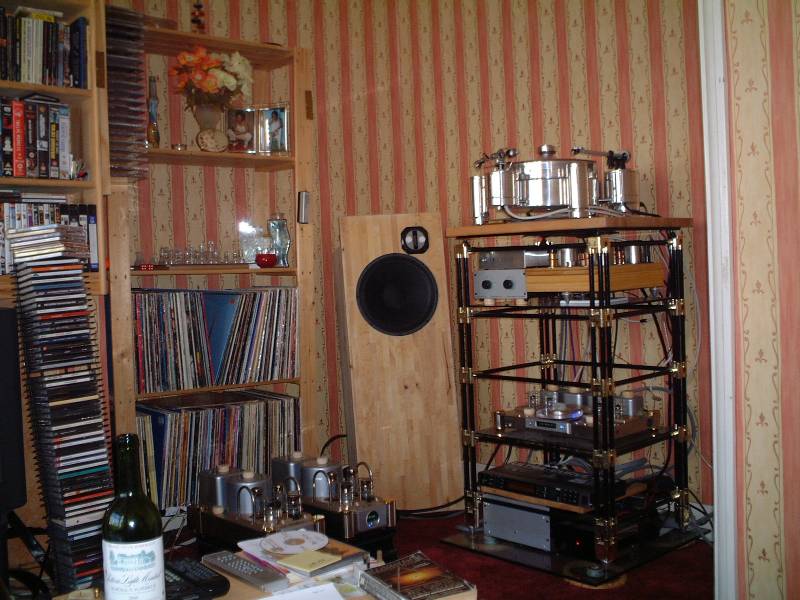

I hope it's a bottle of french wine, on the last picture
Le vin est un Chateau Bricolo d'un excellent millesime..j'ose esperer.
