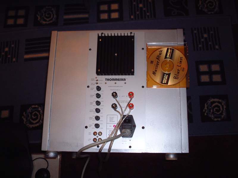

While I am showing projects off, here what I did with the Thomessen Module and the two 12" Woofers from the Bastanis "Prometheus" kit. The woofers appear based on the Eminence Delta 12LF but are customised. However, I suspect the Delta 12LF will work okay in a similar arrangement.
Rear view of Thomessen Module (probably one of the best and most flexible plate amps) attached....
Sayonara

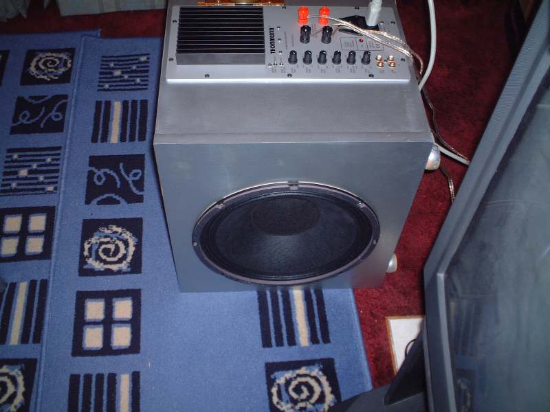

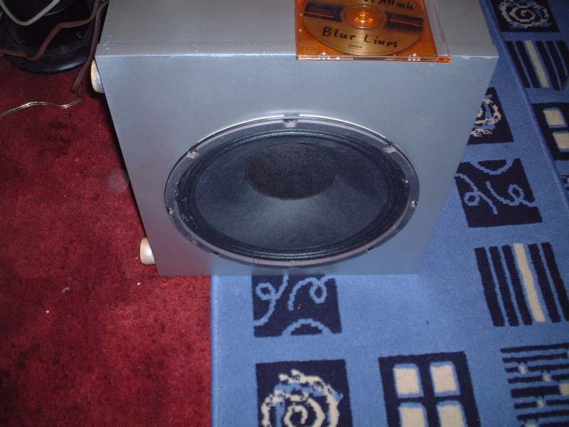

Konnichiwa,
This sub has the "speed" and SPL ability to belnd in with either my open baffle semi full range speakers and also integrates well with the Beauhorns. Not bad. Drivers are in the two opposing sides, keeping them from too direct view and canceling the forces. Material is 5/8" MDF. Left hand side of Sub attached.
Sayonara

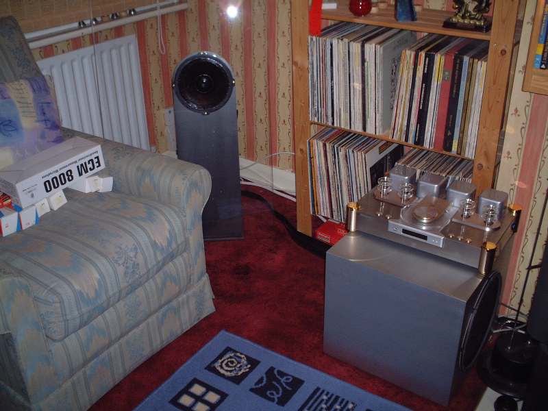

Finally, the Sub as it normally operates. The effect of the Sub is VERY notable with any of the speakers at hand now when playing for example Saint Saens Symphony #3 or anything heavy on upright bass or lower piano registers.
