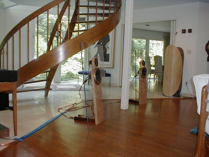

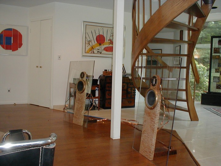

Since Steve dragged up photos of my prototypes on Tubeaholic, I felt a need to show that I have made progress with my homage to the LuiLui.
Here's a shot of the completed baffles. Switching to 1/2 lexan really tightened the sound compared to the 1/4 inch plexy.
Being a lover of fine wood, I used 5/4 quilted maple for the upright support, and figured walnut for the base.
While the PHY is run unfiltered, a 4th order highpass for the tweeter is hidden in the base.

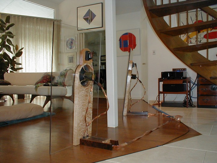

Another pic...
Here's some of the rear detail...
I don't EQ these speakers, so bass starts to roll off ~160 Hz. Like Konnichiwa, I find that due to the shallow slope of dipole cancellation, I get usable bass down to 60Hz or so.
The bass tone is excellent and will be augmented soon with a dipole subwoofer that is under construction. While the baffles can be quite satisfactory without a sub, they really are amazing with the extra cones and EQ down low.

Not only are you're speakers stunning your living room and artwork are just the things I like...
Great stuff, congratulations.
Cheers,😉

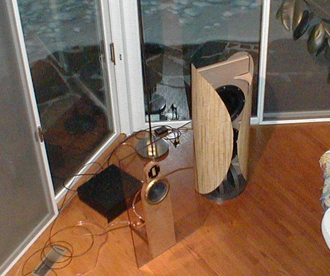

BTW - That odd looking thing seen on the far right of post #63 is the prototype of my dipole subwoofer (seen from the side). I credit Snkby with the k-tube concept, though I believe at 21+ inches diameter, it is the biggest one in existance. I've posted another angle to give a better idea.
I'm currently at the stage of applying veneer to the curved side panels (PAIN!), so I hope to have it assembled in a week or two. I'll post details if anyone is interested.

Kohjin -
1. I have only worked with 1/4 inch plexy and 1/2 inch lexan, so comparisons are difficult. I think the plexy is more brittle than the lexan and is more prone to cracking when you work it. Get a drilll bit designed for plastic. Most woodworking tools will mill the plastic just fine, but the material is murder on the blades. Cut quickly or the plastic will melt...
I had the lexan cut to size by a plastic shop for ~US$150 per panel. Plexy would have been 50% less.
Lexan also finishes to a dull grey on the edges (which I like). Plexy will be clear on the edges (if you polish it enough).
I think thick glass would look and sound fantastic, but would weigh a ton and be very difficult to rabbit for a flush mounted tweeter.
