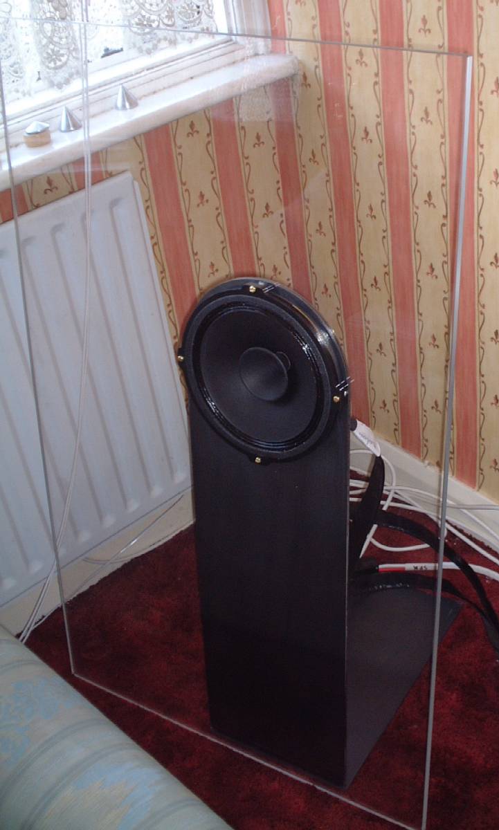

Another Baffled Speaker
Konnichiwa,
After major hassle with both Metalworkers (they claimed a maximum of 10 Days but too over a month to cut two simple metal pieces) and Interlink/Parcelline (they where supposed to deliver the metalwork last Saturday) and finding that most of screws holding the wooden box within which the metalwork was delivered having their heads stripped I have FINALLY managed to get my acrylic baffles with the Supravox 215 Signature Bicone playing.....
The design and build is about as straightforward as it gets, speaker cables plug directly into the Driver, one acrylic baffle (appx 2' X 3'6"), one metal L-Piece, 4 Brass screws and nuts - Voila, a most excellent speaker....
Sayonara

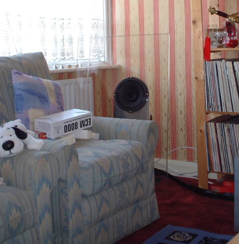

Okay, so we have a speaker playing. What's it sound like?
Excellent. The sound is coherent, open, well balanced and these speakers are clearly full range enough to not need either subwoofer or supertweeter. And that is with drivers having minimal play time (no spare Amp's to break them in with pink noise).
In terms of sensitivity I feel they clock in slightly louder than the Bastanis Baffles AND my Tannoy Monitor Red's and NOTABLY louder than the Beauhorn B2.2 Revelation package.
Adding the Bastins based Sub set to 40Hz X-Over, 6db boost @ 30Hz and at rather low levels adds a massive visceral impact, without slowing down the system. Brilliant. You should see my grin....
Again, the system runs without EQ, non needed. Dipoles work well enough in even difficult rooms that room modes do not become a major problem.
So, Supravox Signature Bicone Open Baffle - go for it, it's great stuff. :cheerful:
Just make sure to NOT use any British Companies in the manufacture of the Baffles, otherwise you will be effectively delayed several weeks and under NO conditions allow British Freight carriers to get involved.... If you do the hassle will take years of your life... 😡

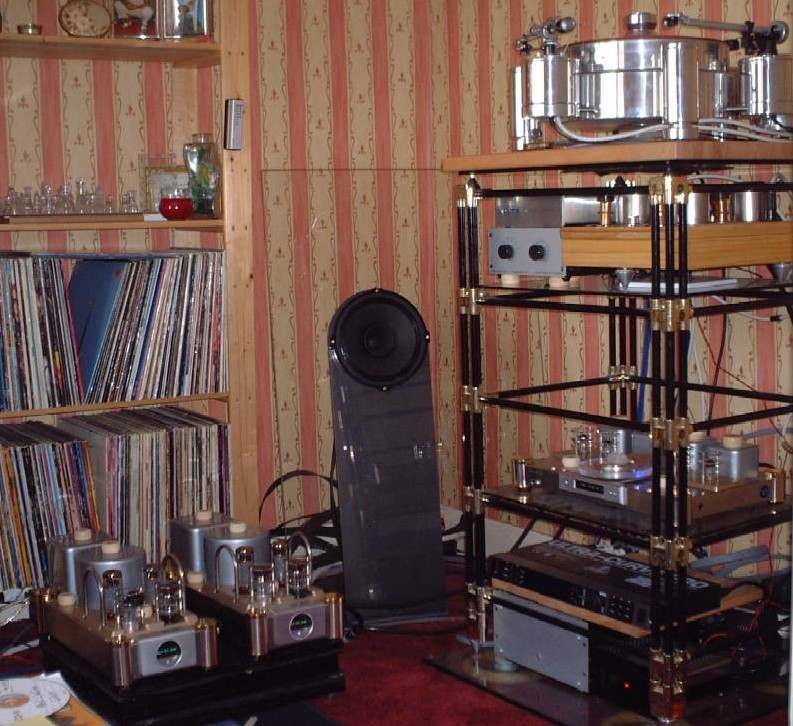

So, what's next? Well, I should have very soon a ribbon Supertweeter and there is that big bottle of 20 Centigrade C37 lacquer around here.... Let's see....
And finally another picture of the Speakers as they appear in the room.
Sayonara
