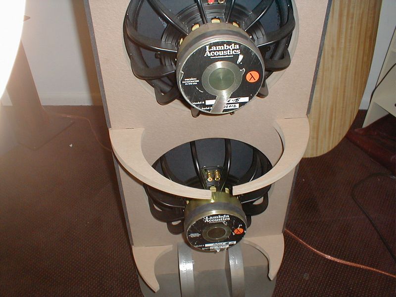

Couldn't you build two simicircles to support the wings between the two drivers? (Mostly hollowed out of course)
You mean like this?
Ahh yep, that is what I was thinking of.
Anderson International also sells fibreboard cylinders. I wonder if they are closer to MDF or to particle board. If they were more dense like MDF perhaps with some bracing (like you pictured) they would work. Save a lot of money as well.
I'll call them up sometime this week. Also need to call Dan at Adire and ask him about dipole Tumults. I'll let you guys know if anything comes of this 🙂
EDIT: Ahh ,my mistake. I see what you mean, you bought a single 102" long half cylinder (180 degrees) and had them cut it in half so you had two 51" long halves delivered. Only $135 as well, not bad at all.

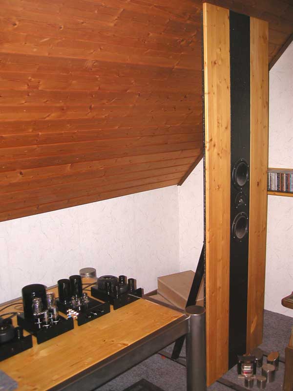

This is what I saw on a German site:
Cheers,😉
Very nice and even possible WAF for such big speakers!
