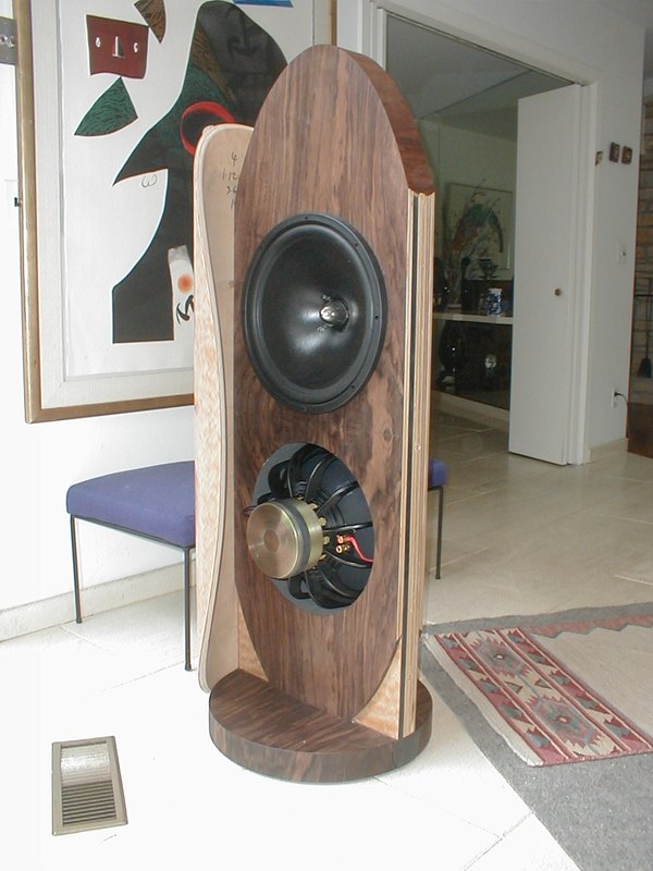

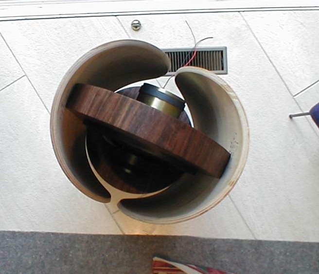

NEW OB Design
I finally finished my Dipole Subwoofer. It is modified H-Frame design with a massive dampened baffle and curved, eliptical sides.
Bass is fast and detailed. The shape provides the equivalent of a 2+ meter baffle width, so EQ is minimal. Karlson-like slots provide quasi-horn loading front and rear.
The design is symetrical, but the continuous curves and dual driver centers smooths out the response nicely.
Erik, what Xover compensation used for woofer cavity resonance
Folding a dipole baffle will create resonance cavities. A curved wing would spread out the resonance energy, but might complicate the compensation.
What measurements have you made on your dipole woofer, and what compensations have you added to your crossover? Does the tapered-pipe loading should show up in the measurement?
Do you crossover to the woofer below the cavity resonance, which seems about 500-600 Hz.
Oh Yeah....COOL LOOKING DESIGN
