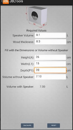

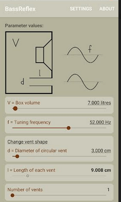

Maybe somebody can simulate this cabinet to please the OP?
Suggest port diameter and length?
Suggest a passive radiator which will enhance Bass?
Would LOVE to see results.

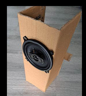

Funny you should say that. In the following video Danny creates almost exactly the same thing out of cardboard (for illustration), an his advice:
Don't do it! The sides must be of unequal sizes. I think he is for MDF.

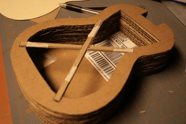

I still say that a layered or stackable cardboard enclosure has the best potential.
However, this technique demands greater effort in design and execution than simply folding a sheet of carboard.
Layering worked a treat for building this playable cardboard ukulele, and could well be utilised to produce a suitably rigid loudspeaker enclosure.

Sure enough.
Pity this one just holds air.
Not even so, being open on 3 sides does not qualify as "holding", as an open hand with open fingers or a bottom less cup does not "hold" water.
But who am I to even mention ... ugh! ..... "Reality"???
I´d still LOVE to see some measurements (fat chance) or at least simulations.
Showing the influence of ports, for example.
Bonus points for showing the choice and influence of a passive radiator.

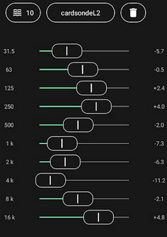

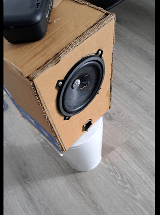

Again I spend an hour or so listening to the latest L - shaped minimalist cabinet if you could call it that, a cut-down version of the 'holds air 3 sided' speaker pictured above. The driver was closer to the supports and the floor, and so I thought I heard some reflections that did not sound very nice. This one was open on 2 and a half sides but I closed it off to three sides, and was only 26 cm high.The configuration resulted in a very bright and forward sound, I thing 'shouty' is the term for it, without EQ. I will spare you the image.
Nothing that some blindfolded EQ settings could not cure. So I EQd and listened.
Some of the songs I listen to date back to 1984, and in those intervening years I have listened to these songs over good headphones, cheap headphones, a personal stereo, a rack Hi-Fi system, and other systems.
The songs sounded great, all the sounds were there in the pleasing proportions they were heard in before. I enjoyed listening to these: without EQ I could barely listen a minute to these speakers.
Here are the EQ settings.
These drivers were meant for enclosures, so next thing is to build a box and reduced the equalization. Of course it will be finished in high gloss oak veneer, but later.
