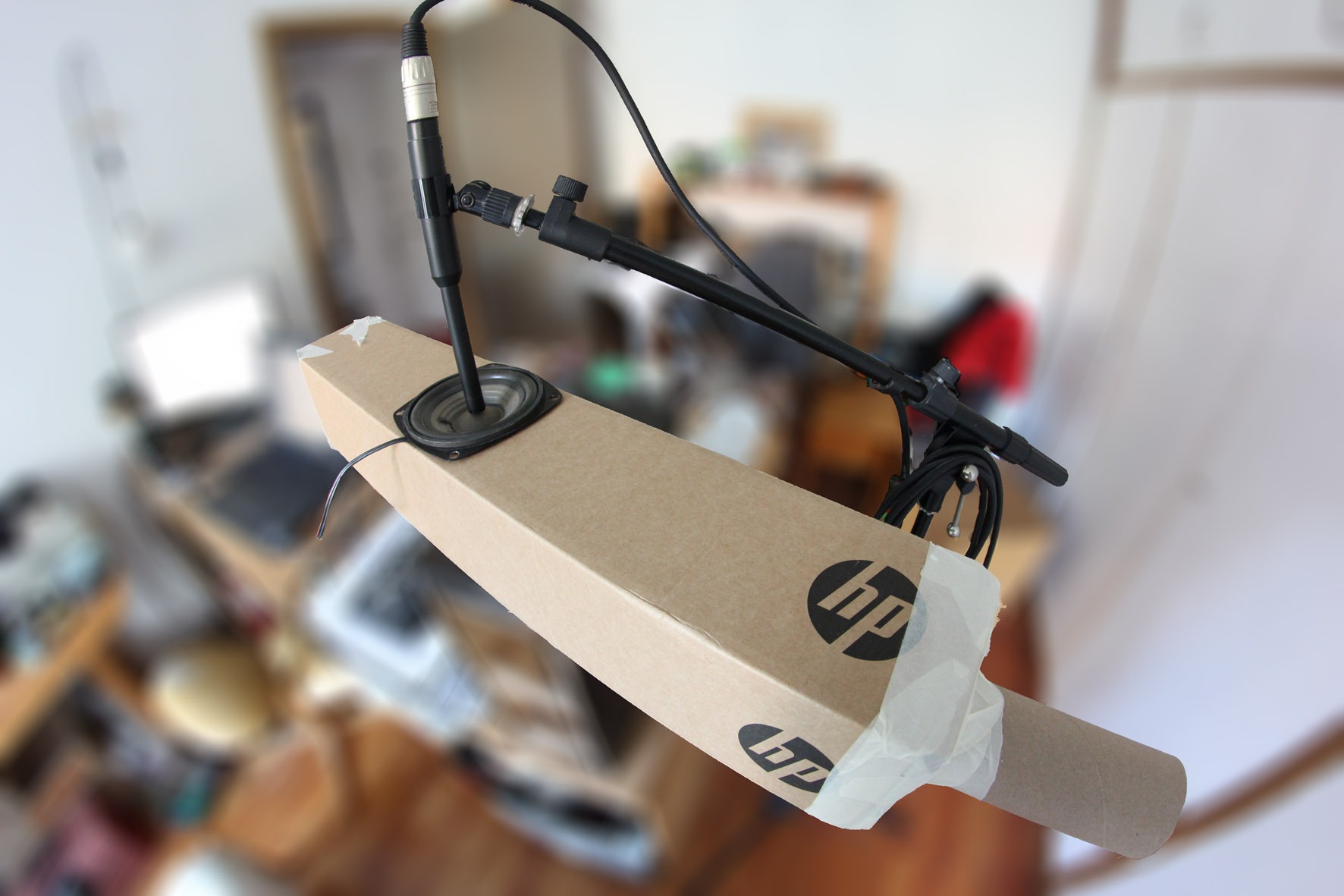

I once tested a cardboard mass loaded quarter wave resonator, see images. it worked better than i expected but as you can see from the measured response it still is not ideal (by the way the measurement shown was "midfield" with about 50 cm distance from driver and port - not driver nearfield as shown in the photo!)
the box i used was reasonably stiff, because of it's geometry. the main problem was mounting the driver airtightly in the soft cardboard.

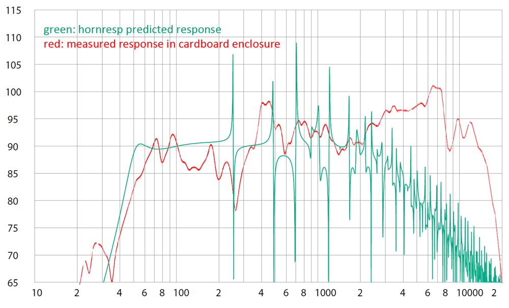

The chart shows dB level vs frequency? What is the lowest frequency - 40Hz? What do you mean by not ideal is it the uneven response - which can be EQd out or not?I once tested a cardboard mass loaded quarter wave resonator, see images.

the green curve shows the energy FR, this is why the measured red curve is much higher at high frequency (beaming of speaker).
but the absolute values do not say much, as you will have another driver and another enclosure.
the graph shows plenty of resonances of the soft cardbord faces.

yes. frequency from 10 Hz to 20 kHz.The chart shows dB level vs frequency?

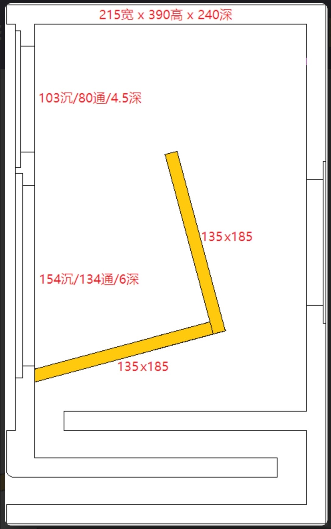

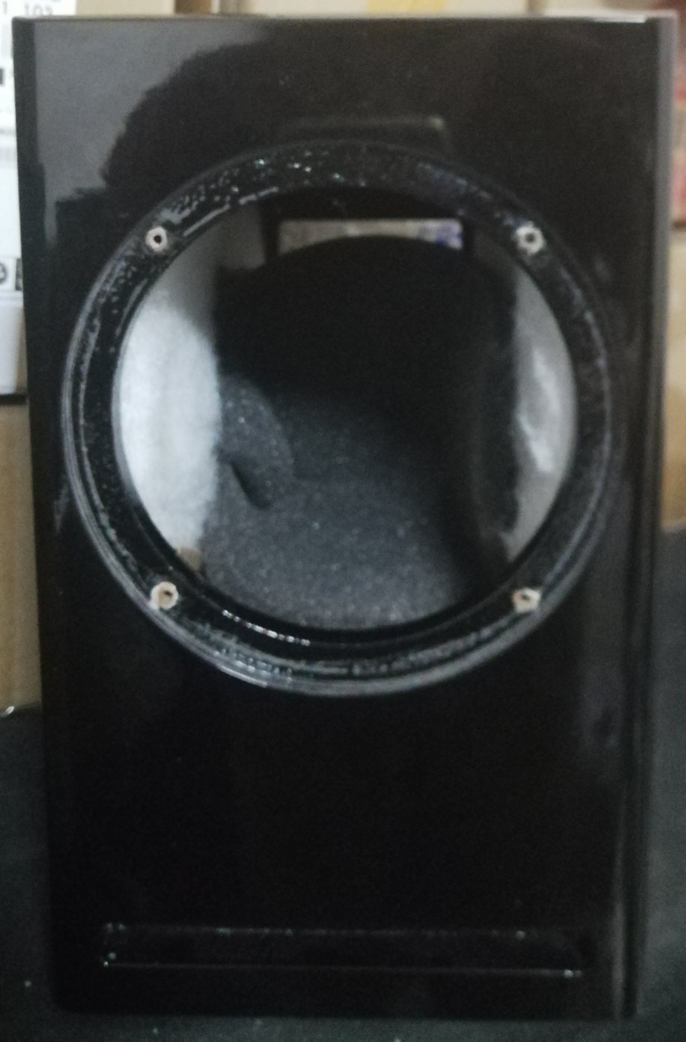

I mentioned in post #19 using cardboard for TL(onken) internal dividers and braces. Well I just swapped out the driver of one, a 5L 4.5", and placed my new 4" FE108eSigma over the hole. Earlier I had done the same with its unmodified slot-loaded BR mate and there was basically no bass. But the "cardboard inside" TLonken worked -- acceptable bass (especially for a new driver) playing organ and piano deep fortissimo. Tone sweep decent too judging by ear. Hmm. @planet10 @GM

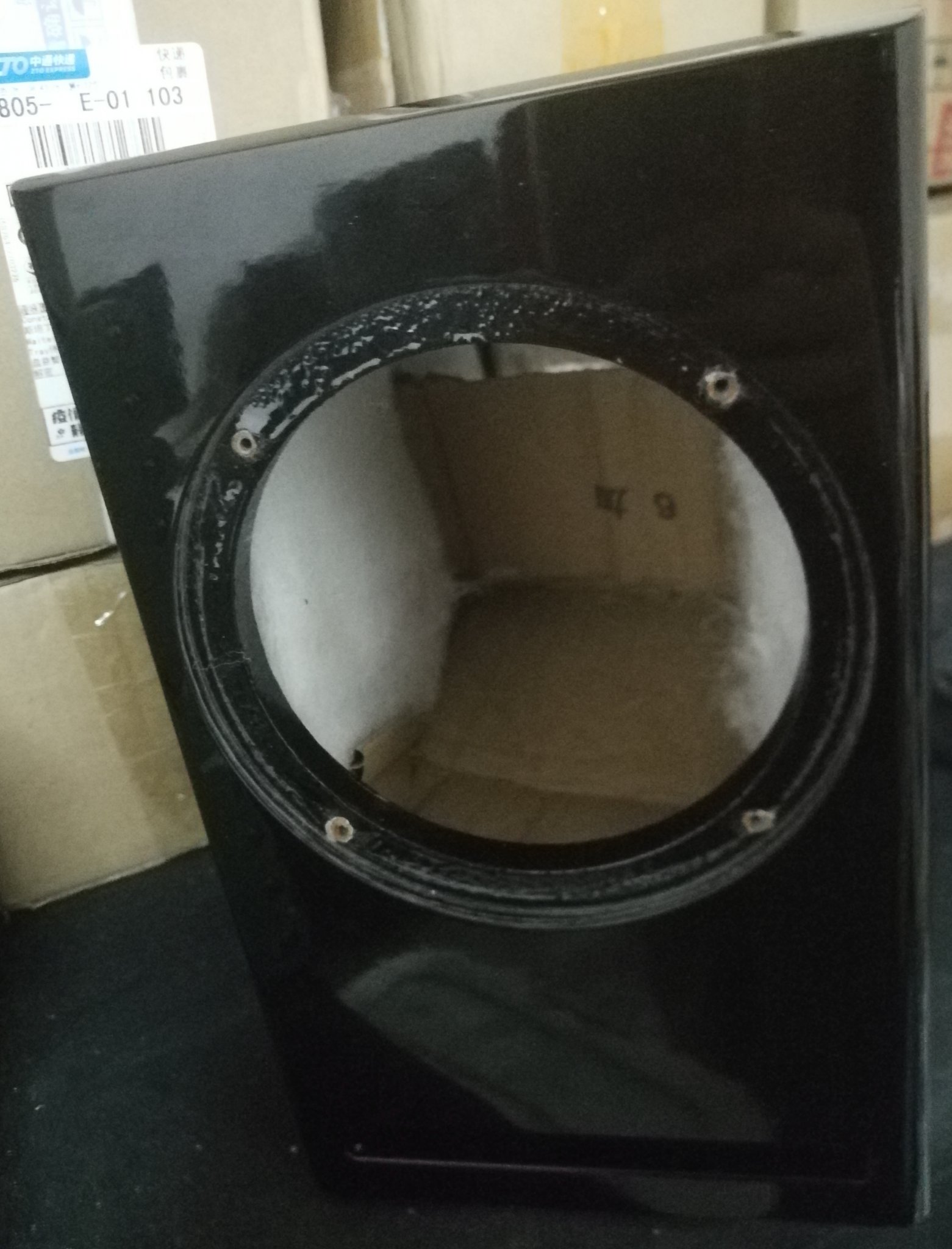

I prototyped my TLonken folded transmission lines with hard cardboard dividers, often brute-forced into place and self-braced. Much easier than using plywood. One worked so well I did its mate in ply and found only a trace of coloration (warmth) from the cardboard TL, less than that imparted by a typical MDF cab.
Any pictures of this? So the dividers were cardboard, but the enclosure was plywood or MDF? Also, drivers are important, what was the stated Fs of the two drivers and did this predict their characteristics? Fs is listed as 77 Hz. The Fostex is a solid looking speaker.
Here is a link to the famous Negaoka Tetsuo Swan folded horn design for the FE108E∑ speaker. This horn produces bass response that is astonishing for such a small speaker. http://spida.art.coocan.jp/eng-page7.htm
https://www.madisoundspeakerstore.com/approx-4-fullrange/fostex-fe108ez-4-full-range-sigma-series/
In a fit of demensia (I needed to make a de novo comparison BR vs TL) I ripped out that (nearly) perfectly good cardboard line (sob). The 10L 1.3m fingered-oak TLonken had been made/modded for 5.5" Eve Audio fiberglass honeycomb drivers (aerospace technology) Fs~53hz IIRC. Now they house Hifi-Bird aka Isred/MichaelAudio/MKHIFI "English drum paper" my favorite whizzerless fullrange driver. Both drivers have low-ish Qts.
But the 5L "cardboard inside" TLonken is intact and I will later take a picture of it. Worked well enough with the "hard to get bass out of" FE108eSigma (planet10). Its Qts is middling and Fs is pretty high.

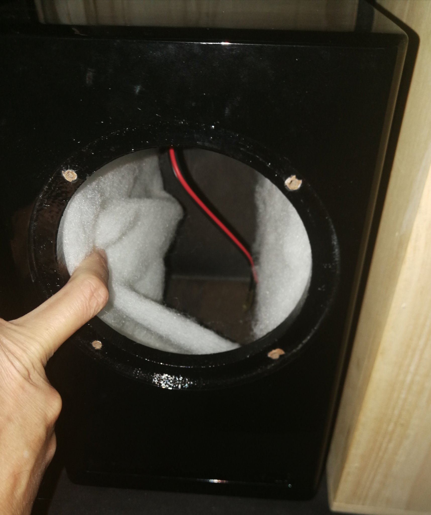

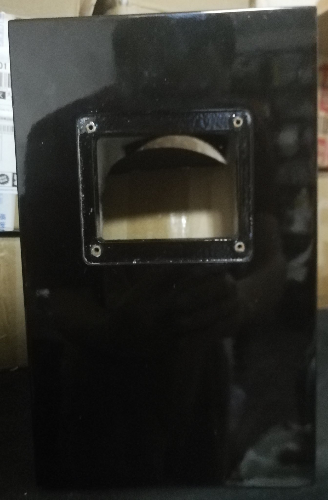

Some pics of the 5L piano-black single-slot-loaded Onken, typical of design but very well made & sold by Michael Audio with 5" (actual 4.5) drum-paper fullrange driver. I got one pair new and one pair used on Idlefish Market (both for less than half price) after hearing audio-clips. First pic is unmodded cab. Last pic is the (same) design schematic for a bigger ready-made labyrinth cab.
Low Qts and low Vas are probably best suited for the TLonken short tapered line. Best cardboard to use is probably the shiny-faced hard/thick kind, folded into square tubes and taped/self-braced.
