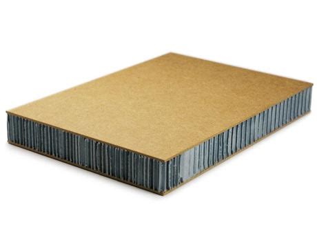

you can make a box with thin wooden walls and reinforce the panels with halved in height paper tubes glued closely together forming a matrix honeycomb alike
tested cardboard with added layer of cardboard glued together with silicone forming a type of constrained layer damping construction.
Knocking test sounds pretty well damping for such a quick and dirty attempt.
Will make a test with a cardboard box constructed like this for a listening test.
Cardboard alone is not promising but maybe you can get acceptable results with this built.
