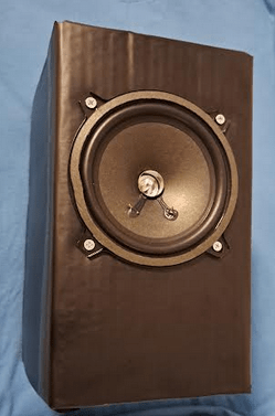

Using car speakers in a bookshelf speaker.
Not a good idea, sourced these for the cost, however these cost upwards of $20 in some parts of the world, better to use 4 inch full ranges.
That said, they sound fine to me in my installation with EQ. Note also that the tweeters are suspect - they may not be actually doing anything.

These drivers were meant for enclosures...
An aperiodic enclosure is pretty forgiving in terms of driver type and enclosure volume, so is worth experimenting with.
Cut a series of narrow slots in the back of an otherwise sealed cardboard enclosure and cover them internally with soft felt.
For the 7 litre enclosure you mention, I suggest 6 slots, each 100 mm x 6 mm, placed 40 mm apart.
Scale up as necessary for larger enclosure volumes, which may give better results.

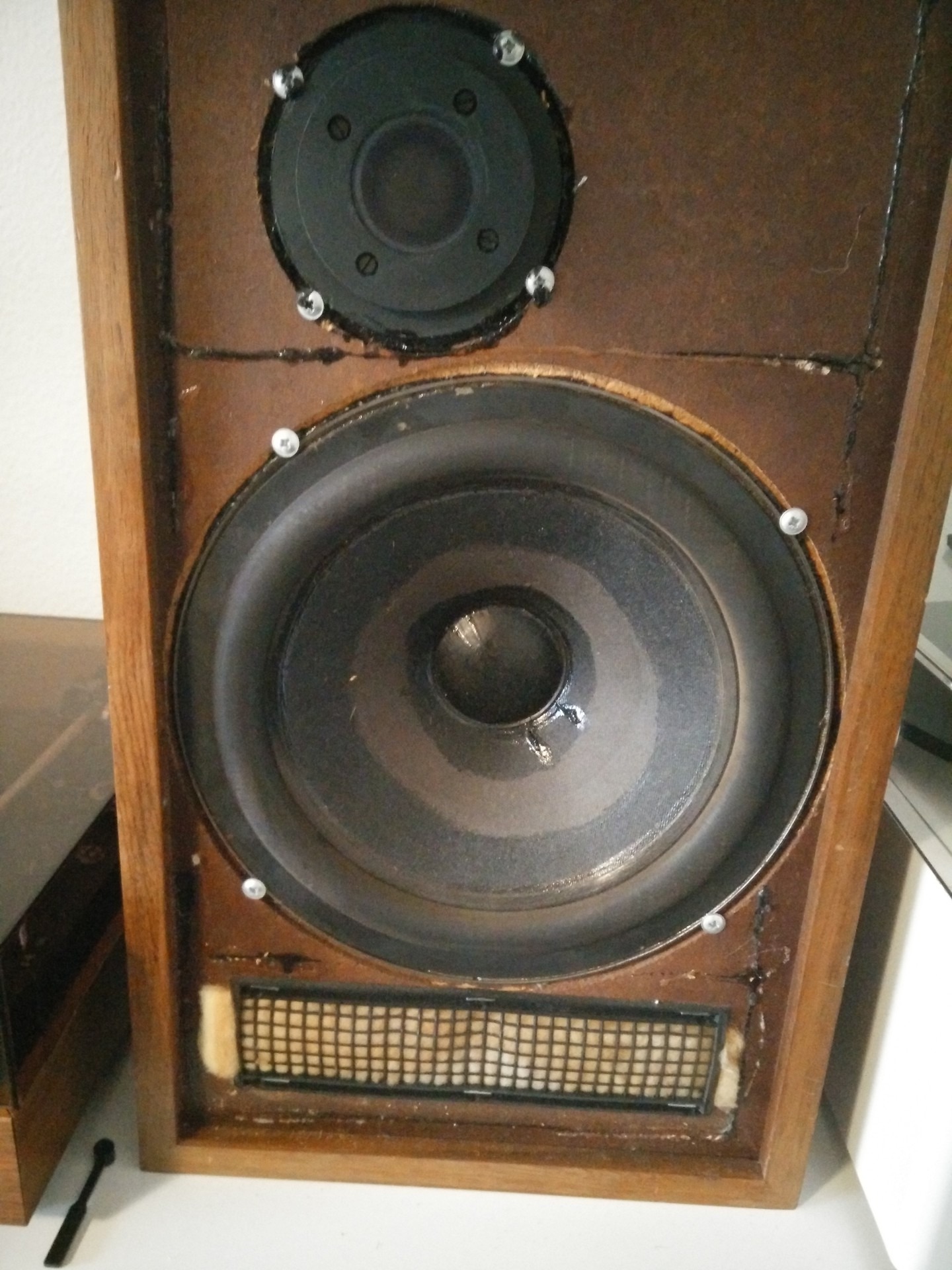

When you look at the link you mentioned, you will see front slots which are packed with fibreglass. This is another method of aperiodic loading.
Just like in the Dynaco A 25 whose image I have attached.
The single large front slot should have an area equal to the sum of the areas of the multiple narrow slots in the rear of the enclosure that I dimensioned earlier.
EDIT: This method does require a decent thickness of front baffle to contain the wad of fibreglass.

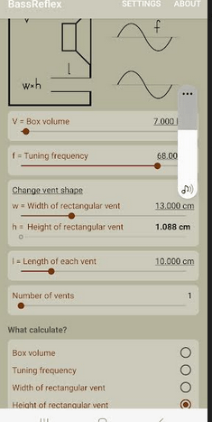

I have some calulations for a 7 litre box.
I haven’t actually pulled the woofer to confirm, but I believe the inside of the baffle has the same grill stapled in place to retain the fibreglass so you’re right about the baffle. I don’t know if there is any depth to the port.EDIT: This method does require a decent thickness of front baffle to contain the wad of fibreglass.
You are correct, Cal, the fibreglass is compressed between a front and rear grill.
There is no depth to the port other than the thickness of the baffle.
@BasicHIFI1
That calculator is very basic and much oversimplified.
How did you arrive at your entry for the "tuning frequency"?
I selected the lowest frequency that would give me a manageable vent length 10 cm. I have tried it out with another cardboard speaker, sealed this time or semi-sealed, and it does make a difference, gives bass boost, however it does not have enough of an effect to be worth the effort. It is easier to use an open baffle with wings and use EQ. The larger speaker is better even with the rear panel uninstalled, so lots of variables.

I first have to make an accurately cut set of sides. Folding will not do it.
U-shaped enclosure. Cardsonde 3U. With EQ it is quite listenable, also with bass manipulation of +15 dB. 10 should be enough. 3 is recommend.
