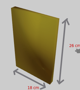

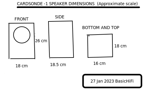

Design: Dimensions will be same as the reference speaker: front baffle 18 cm wide by 26 cm in height for proper comparison.

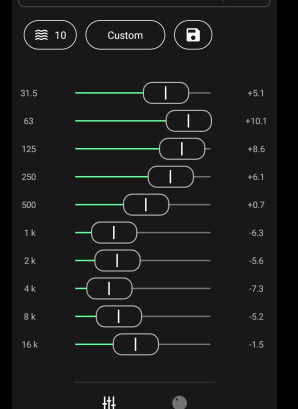

More pictures: The speaker driver in question mounted on an open baffle that was used for my earlier project. With proper equalization, bass boost, that is, I could listen all day. The clarity is astonishing. Makes me wonder, with a proper car door behind it, or, not having a car door, a wooden baffle or even a

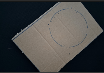

The next picture is the baffle itself, cut out with a small exacto knife, carefully as I could. As you can see one side is cut out too much at the top. It was fun cutting out a speaker front baffle, especially after I had glued two cardboard pieces together for thickness .
After cutting I duly mopped up a few cardboard pieces from the floor and that was it. No mess no fuss, no noise, and the environment loves it.

I'd layer the boards in varying 'directions' for better strength. This kind of technique was used extensively as from the 70's when we started seeing a lot of curvy furniture.
If you're doing open baffle, make the baffle larger, and forget the boxes, or compare an open-baffle with a DIY box just for fun.
Good idea to cross- grain the boards. Not making an open baffle, these will be too large, but a good opportunity for a prototype.

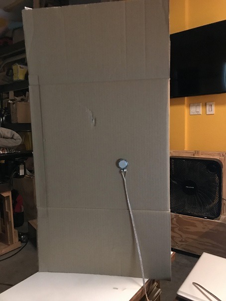

Worth trying out. I did contribute to another thread of building a speaker from scratch. The 'exciter' sounds exciting, I may buy one and try it out, recommend and publish plans, like I want to do here for the Cardsonde1.This comprised of a flat coil glued to the cardboard and which was 'energised' by a neodymium magnet.
What is the sound quality like, though, I heard that quality is not the best. There is a thread though form DML. Browsing.

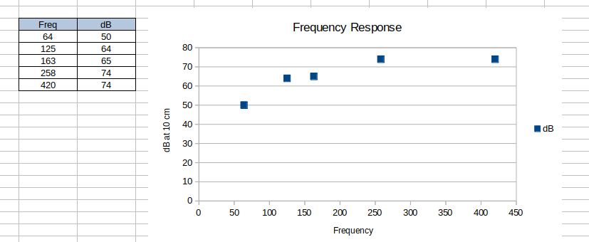

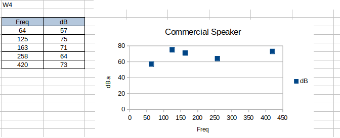

Testing: (sides, bottom and top only)
A rough plot of frequency response with flat EQ. Sounds boxy, and with a hand against the cabinet, resonant frequency of the cabinet is about 128 Hz.
Clarity is present, with some increased bass response against the open baffle.
Commercial speaker, woofer, tweeter, crossover. Same amplifier same dB at 420 Hz as a starting point. Looks like we have work to do. Oh and it is ported.

So now I need a way to increase the frequency response the lower frequencies.
1. Some sort of crossover
2. Port (3cm port on the commercial reference speaker
3. Passive radiator
Of course fully seal the box first, then add a port and see

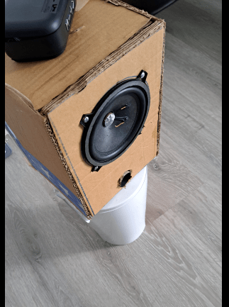

They are good. Spent some time listening to familiar tracks and I heard things I never heard before. Totally taken in by the music, with proper equalization (shown) the balance was very good: I heard all the instruments in good proportions. Pop/light rock music.
The bass? Acceptable, but the speakers have to be about a metre away from the wall. Which is a problem without speaker stands.
It's not the material but the speaker placement that was critical, moving the speakers into the room gave more bass and sound overall: a pebble thrown into the middle of a pond will generate more waves and transfer more energy to the water than a pebble dropped near the shore. That seems to be the theory.
Cardboard speaker stands anyone? I know some of you can't stand the idea. Speaker placement is essential, no point in designing speakers without ensuring proper placement.
Yes, it is placed on a garbage can. Thought some of you would like that.

well despite material choice your ignoring a basic engineering principle which is to make the enclosure rigid and non resonant, have you considered using braces to increase structural rigidity? i think if you do you will find your missing bass output....
A cardboard tube could act like a speaker stand, and port/ transmission line, kill two birds with one stone.

If you haven't tried the DML angle yet, invest 13$ into a couple of these little exciters.

Well thanks for the advice, but what would I brace it with? More cardboard? I always wondered if the airflow around internal bracing causes resonances.well despite material choice your ignoring a basic engineering principle which is to make the enclosure rigid and non resonant, have you considered using braces to increase structural rigidity? i think if you do you will find your missing bass output....
I could press on the walls of the speaker when playing, have done this before, and add more wall thickness.
I hope it does increase natural bass output (did you see the 3 cm port at the bottom? Seems to have a slight effect.
I could listen all day but I can't look at it all day, so the finish needs improvement as well as construction.
I am seriously considering a passive radiator, I already have one on the SONY XBS and it works. Let's see whats available online: The usual 60 days delivery time .. anyone have experience with these? 60 days...
