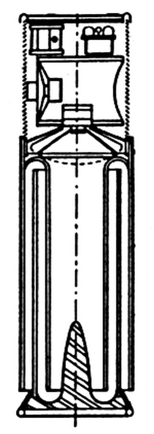

The cardboard Charlin loudspeaker had, for the bass, a line made with three tubes. The medium is mounted in an open tube at the back. On the top of the enclosure there were one or two ESL tweeters.
The cardboard tube is very heavy, like the tubes of carpet rolls.
https://charlin-lescharlinales.weebly.com/la-colonne-120.html

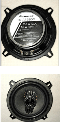

Choosing the drivers: So there is a set of Pioneer speakers for sale at the equivalent of $12 per pair. The woofer section was smooth and clear, the tweeter was awful so I actually cut it out, and mounted the woofer on an open baffle, I does fine with EQ but then these were made for door-mounting (Car door that is, although a room door.. that would be interesting)
Clarity and clean bass with EQ were the strong points of these things. Next thing is to mount them in the cardboard enclosure.

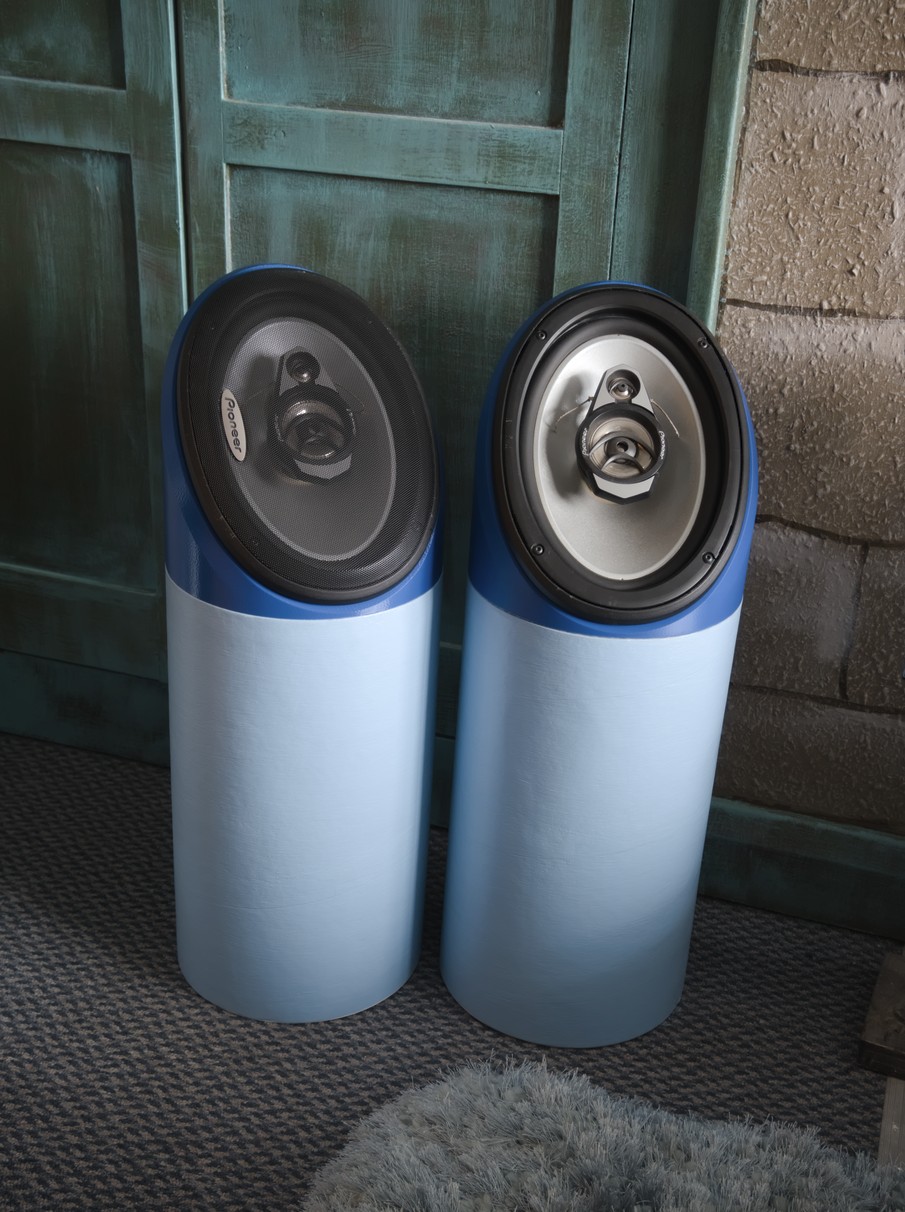

I made some speakers out of cardboard postal tubes and old car speakers a while ago. The cardboard is thin, but the tubular shape gives them sufficient rigidity. Car speakers tend not to be exactly Hi-Fi quality, but that wasn't the point here.
What was the point then, the 'application'?

The point was to make use of the old car speakers that were just sitting on the shelf doing nothing.What was the point then, the 'application'?
