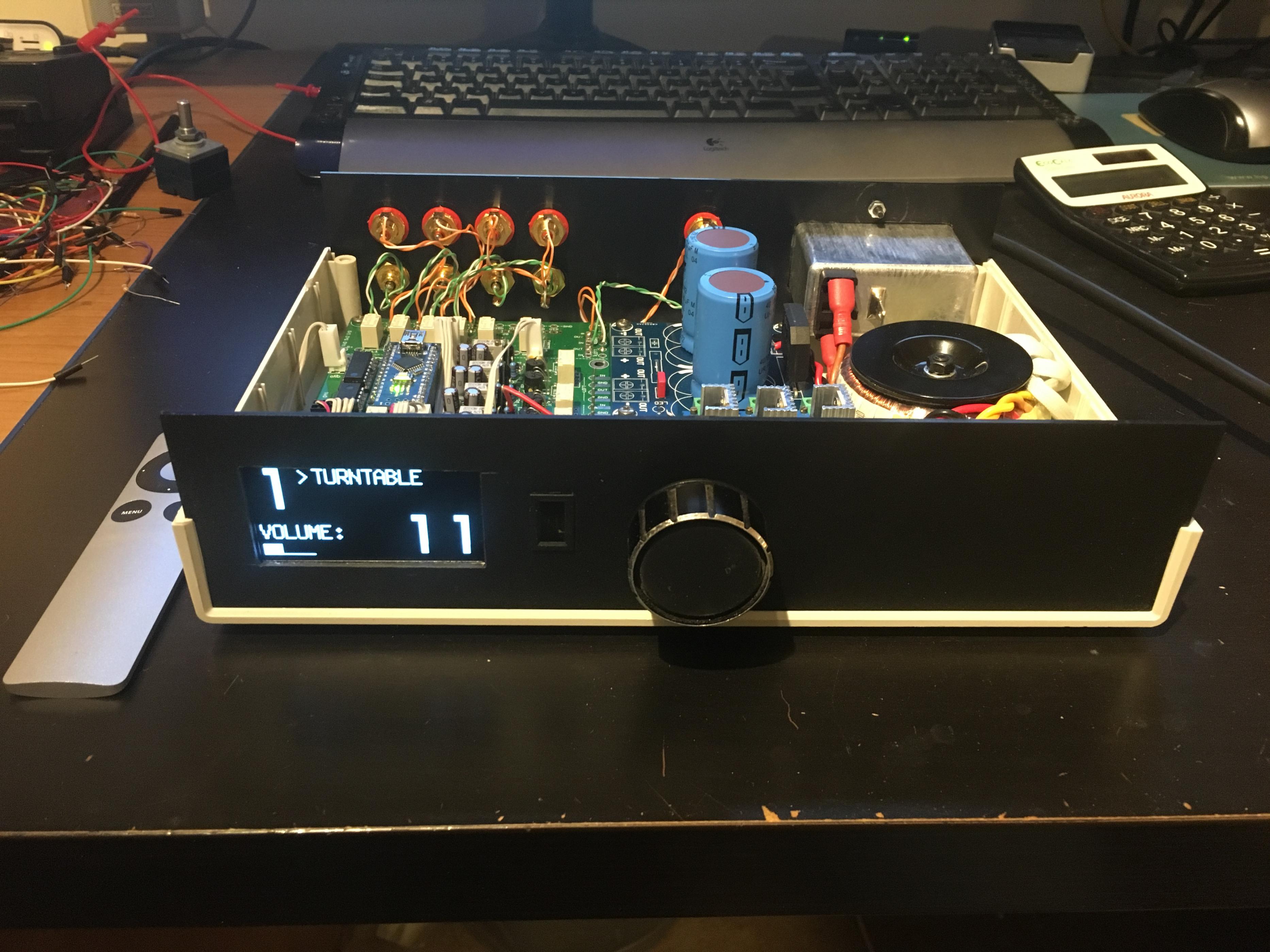

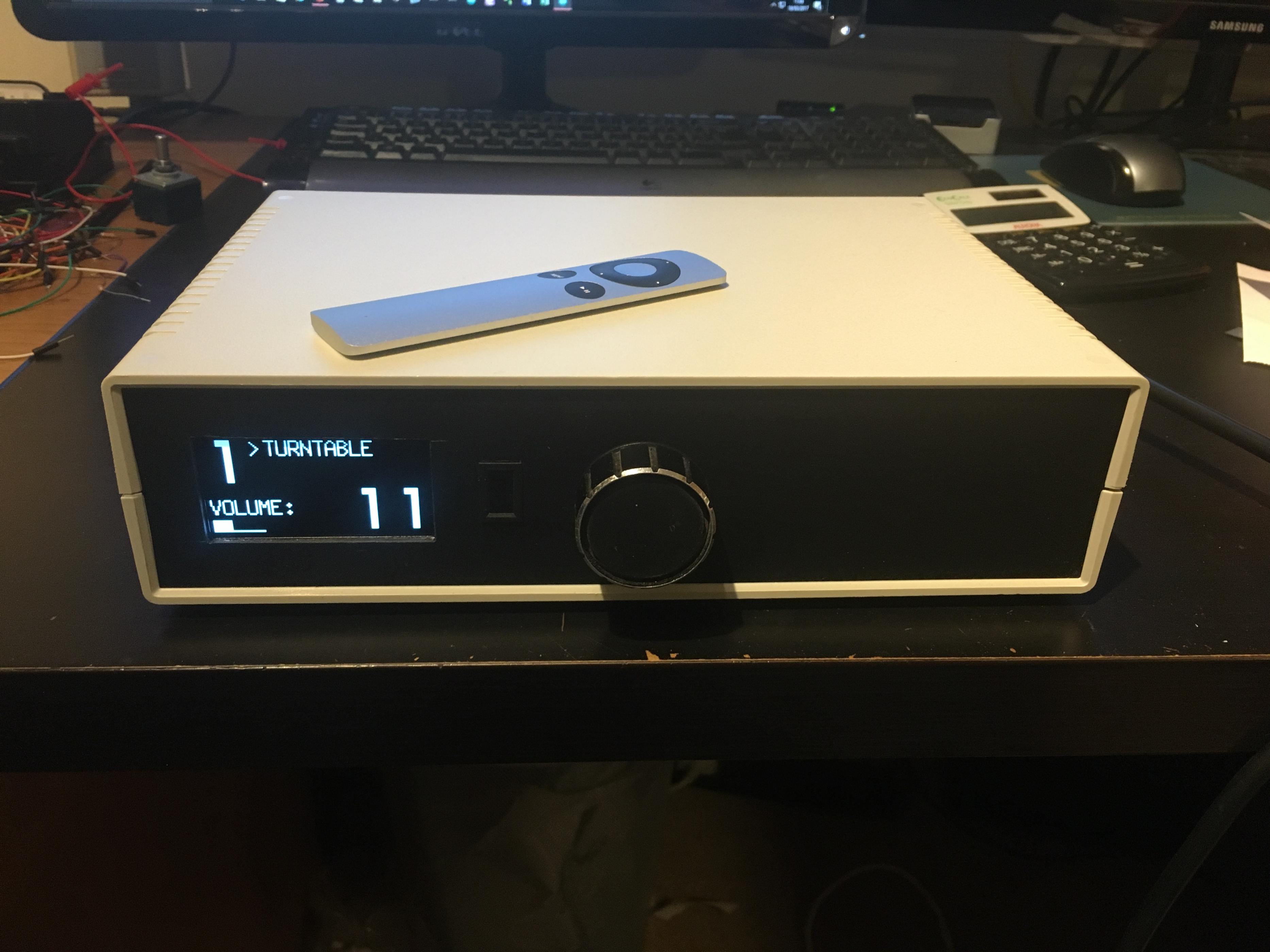

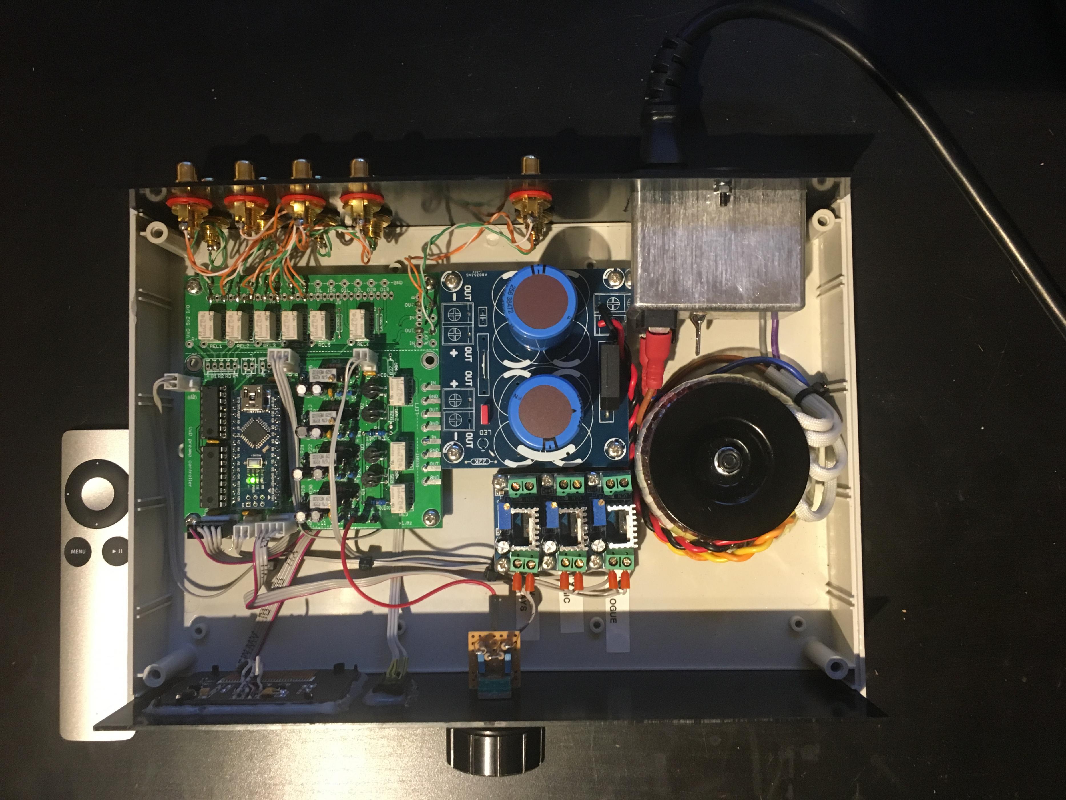

I need to get some real listening done so have now housed the boards. Nothing fancy just a basic build.
In the background I'm working on MK II, for want of a better description, it will use I2C ADC & DAC's to manage the LDRs. Hopefully this will give better accuracy and get rid of the mid point bump.
