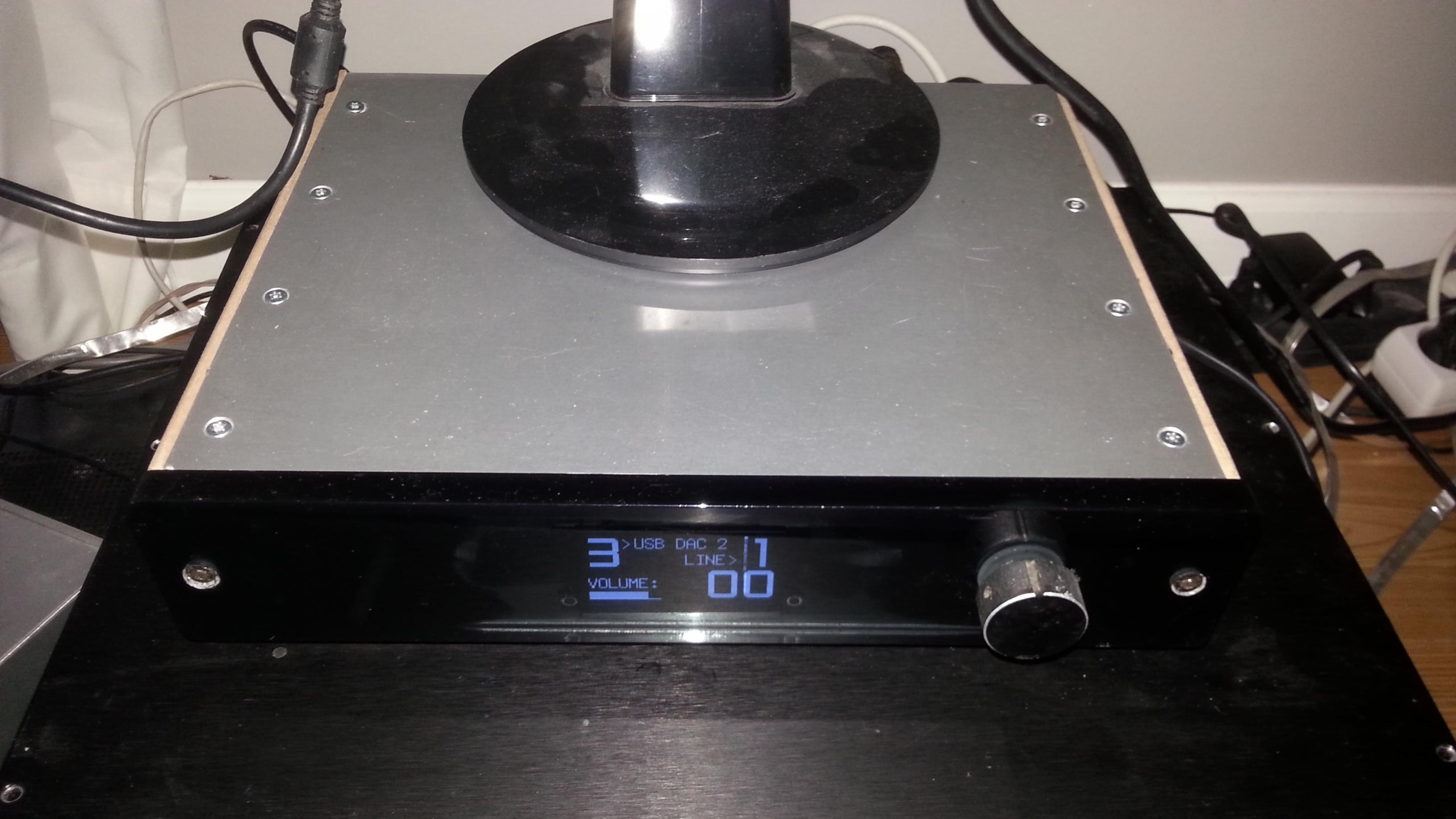

My larger 2.42" display turned up today from Hong Kong so I was all excited.

Turned out mine was blue , when it arrived, but that was ok for me.
My only problem was the vertical streak...Probably just a bad sample.
By the way, the volume control sounds fantastic, by a wide margin the best I have tried...

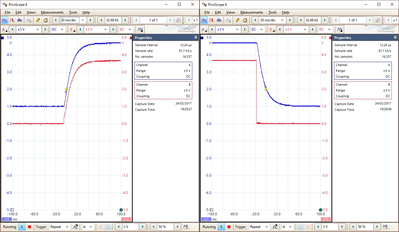

Well I took the drastic action of cutting the PCB trace between RSH BIAS line and D7 on the Nano to allow me access to the circuit. With the line open there is a huge drop in volume as the FET gets driven but no bump.
I'm definatly getting out of my depth now but could it be overshoot in the PWM filter? If place an 10uf cap between the gate and ground the bump gets larger still. Maybe there needs to be a more gradual change to the value during cross over?
Found a bit of noise on the BIAS line to the trim pots, not that I think that has anything to do with it. Most of it was cleared down by putting a 0.1uf cap over the line to ground.
Time to enjoy some music instead? (more of a note to myself 😉
Signal drop at the gate (R31) must happen at the same time with the same slope shape as voltage drop at R34 to maintain constant Id at crossover point. This is not happening. Put a scope channel 1 at the gate and channel 2 at D7; set trigger to up/down with ch1 as source and time scale at 10ms. Turn the encoder and watch the edges. The difference between two slopes will result in Vgs and Id fluctuation.
PWM pin (D3) loads a RC network, D7 has nothing on it's way to a perfect edge.

You could try to put the similar RC network at it's output though.
Or. maybe just a cap at Vgs to absorb the spike.

Back to this one, traces are attached. Yes D7 bias (red trace) is either floating or held low. The gate (blue) shows the PWM network filter shaping. So I'm not sure what can be done software wise. It is making me wonder how an external DAC would perform.
