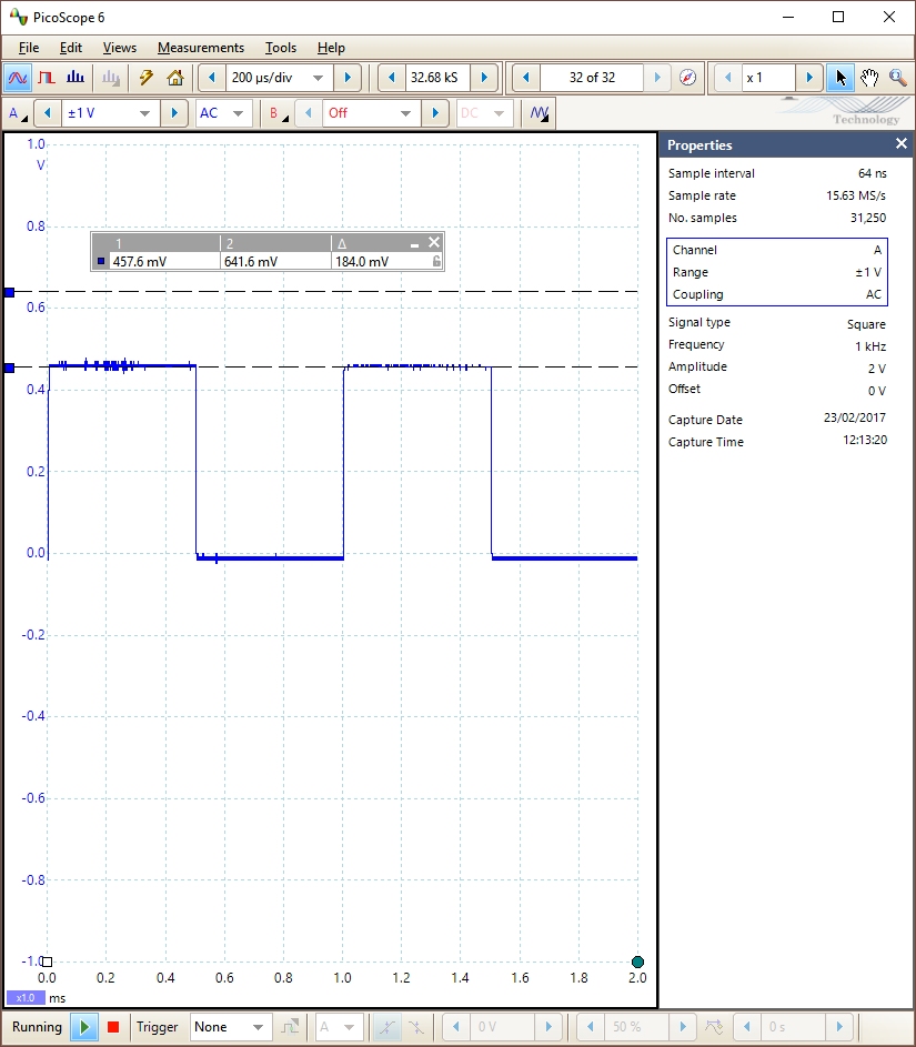

Attached are two scope traces. The Blue line is the voltage over R33 (RSH) and Red over R25 (RSE). The first screen grab is at vol 26 and the second at 27 where yoo can see the jump in RSH which results in the audible bump.
I'm currently using a tool called Meld to compare Nebs code with Vincents V1 code to see if there are any typos etc. I'll let you know if I find anything.
Thanks for posting this. The results are very interesting. I guess R33 and R25 are the current sense resistors on Neb's PCB? I think it would also be interesting to try and translate your findings into a transfer function for the current through the LDR as this is what really matters here?

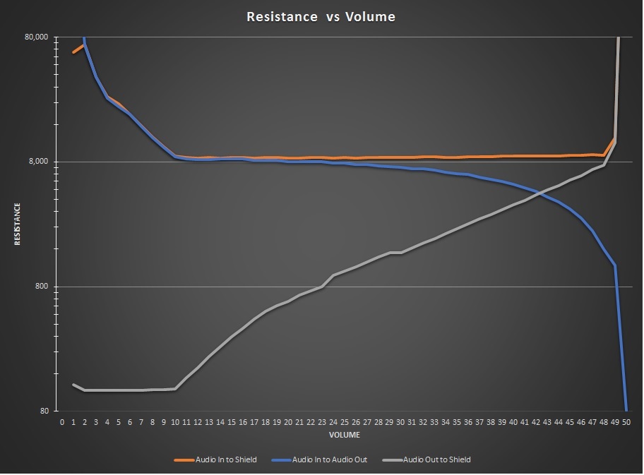

49-50 is not the same type of bump - there is just a non-linearity due to switching from calibrated resistance value to max-min one. Mute click is also yet another story - it's probably that you have a DC somewhere which loads/unloads the capacitance on connect/disconnect event.

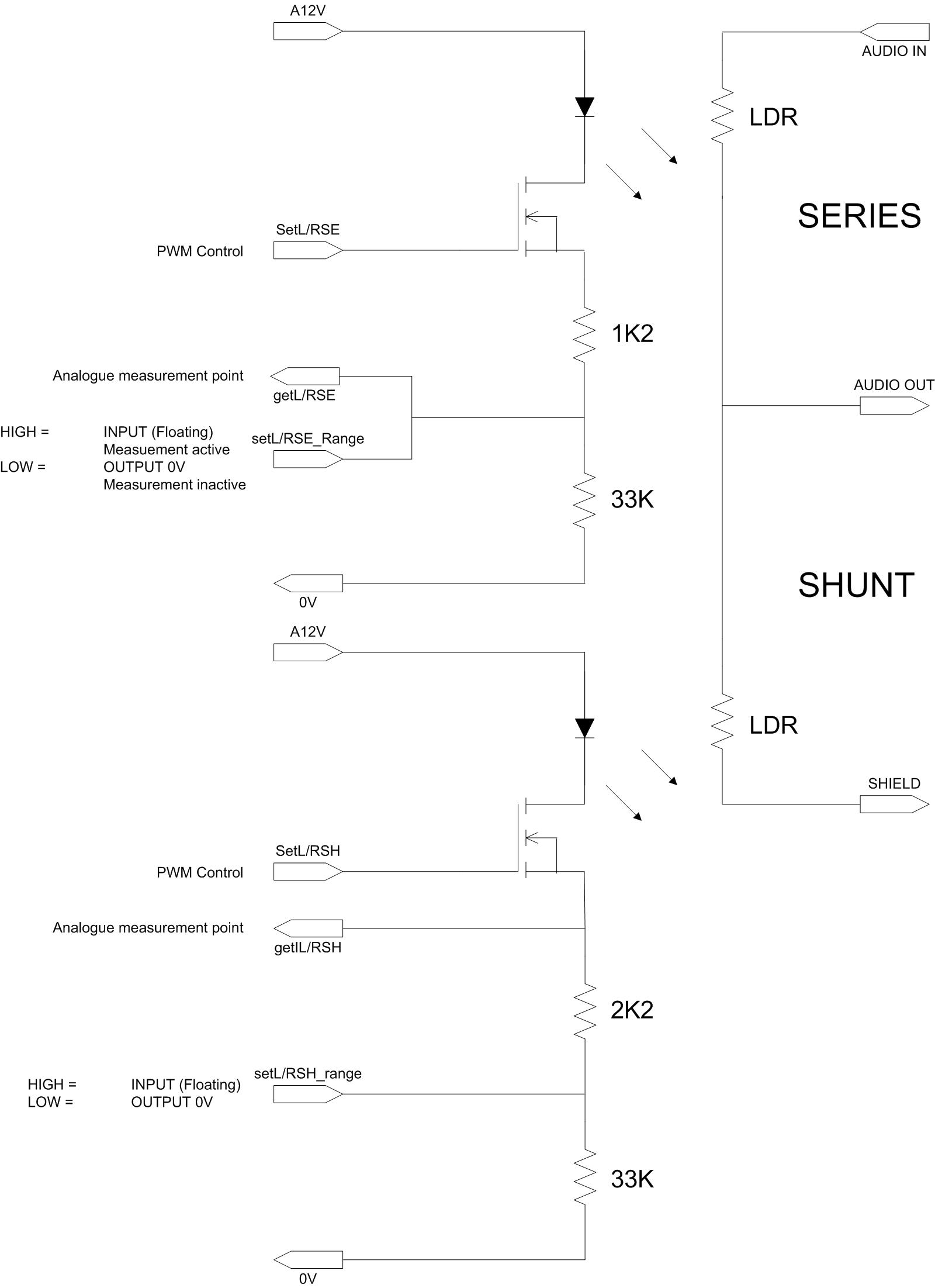

I may be getting this all wrong as I'm reverse engineering, trying to understand what is going on. And at the moment my understanding is so messed up I cannot even see where a maximum current of 7mA can ever flow through any of the LDR LEDs?
If we take the Series LEDs, the datasheet specifies a forward voltage drop of 2.5V @ 20mA, but forgetting that for just a mo we have a 12V analogue supply & assuming Q1/2 are fully ON then that 12V supply is dropping through R7/24 & R9/26 (total 34K2). So if I have my ohms law correct that is a maximum current of 0.35mA excluding the voltage drop over the LED.
When the series sampling side is not being used the Nano sense lines get switched high (+5V) so I guess we have 7V/1K2 = 6mA (Close I guess)
The Shunt side is even more confusing because of the BIAS Pins D7/8 of the Nano and where the current sense signals are taken from given that thier resolution is over the 0-5V range. The max current through the LDR is 12V/35200R = 0.34mA.
When the shunt sampling side is not being used the Nano sense lines get switched high (+5V/Vol Bump) so I guess we have 7V/2K2 = 3.2mA
I MUST have this all wrong, but as I see it the issue is then not in the volume routines but the calibation?
Time for some breadboarding tests

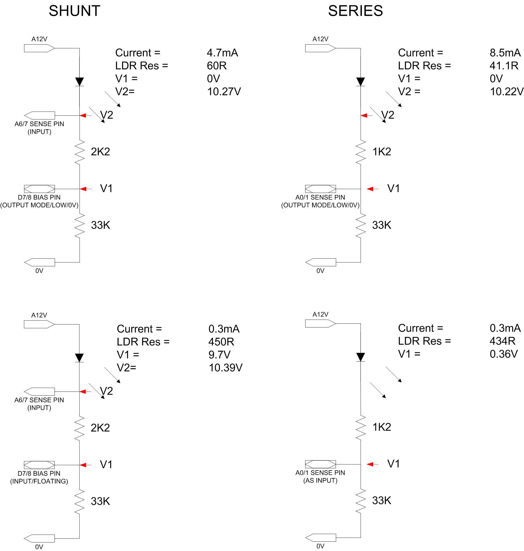

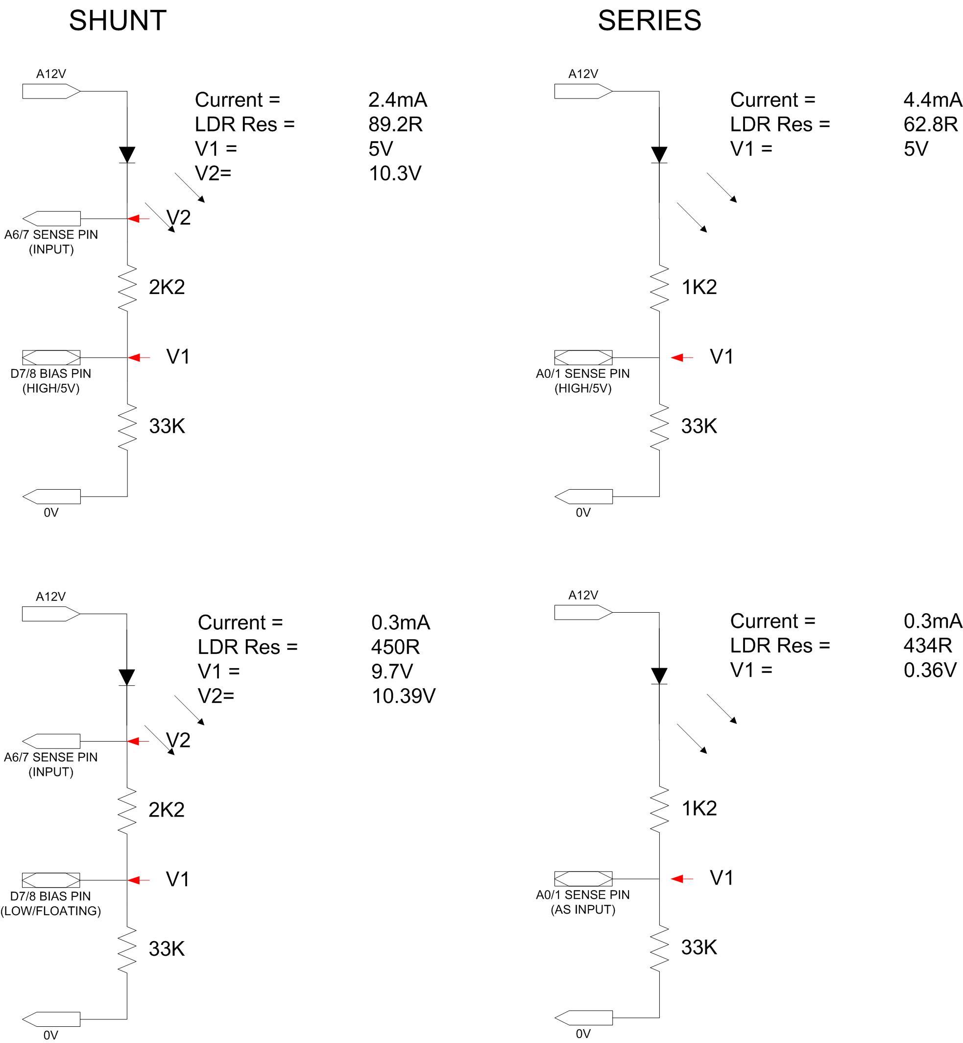

So attached are my breadboard tests. They make no allowence for the control via the transistor and show maximum LED currents/minimum LDR resistances for a given sample.
If I read the code right then some of the pins can be used to both read values and offer a 5V output.
On the shunt side if the BIAS pin goes high then the SENSE pin will see a voltage (V2) of over 5V which is outside of the AnalogRead range and could be suspect for the Nano itself

Attached is a basic drawing of the control signals and measurement points and what pins in the code they relate to. I have then gone through the 50 steps and mapped the values into a spreadsheet and plotted the results.
Not sure what it tells us fully yet but the bump at the middle and the top are a result of switching ranges. The schematic has also helped understand it a little better too.

If you look at the 26/27 crossover point on my table there does not seem to be a dramatic change in any of the resistances at least not out of step with the ones either side so as you say it must all be in the transition.
It is this same transition on the Series side at 49-50 that is responsible for the click there also. Of course that is easy to code out and in most instances will never be an issue anyway.
