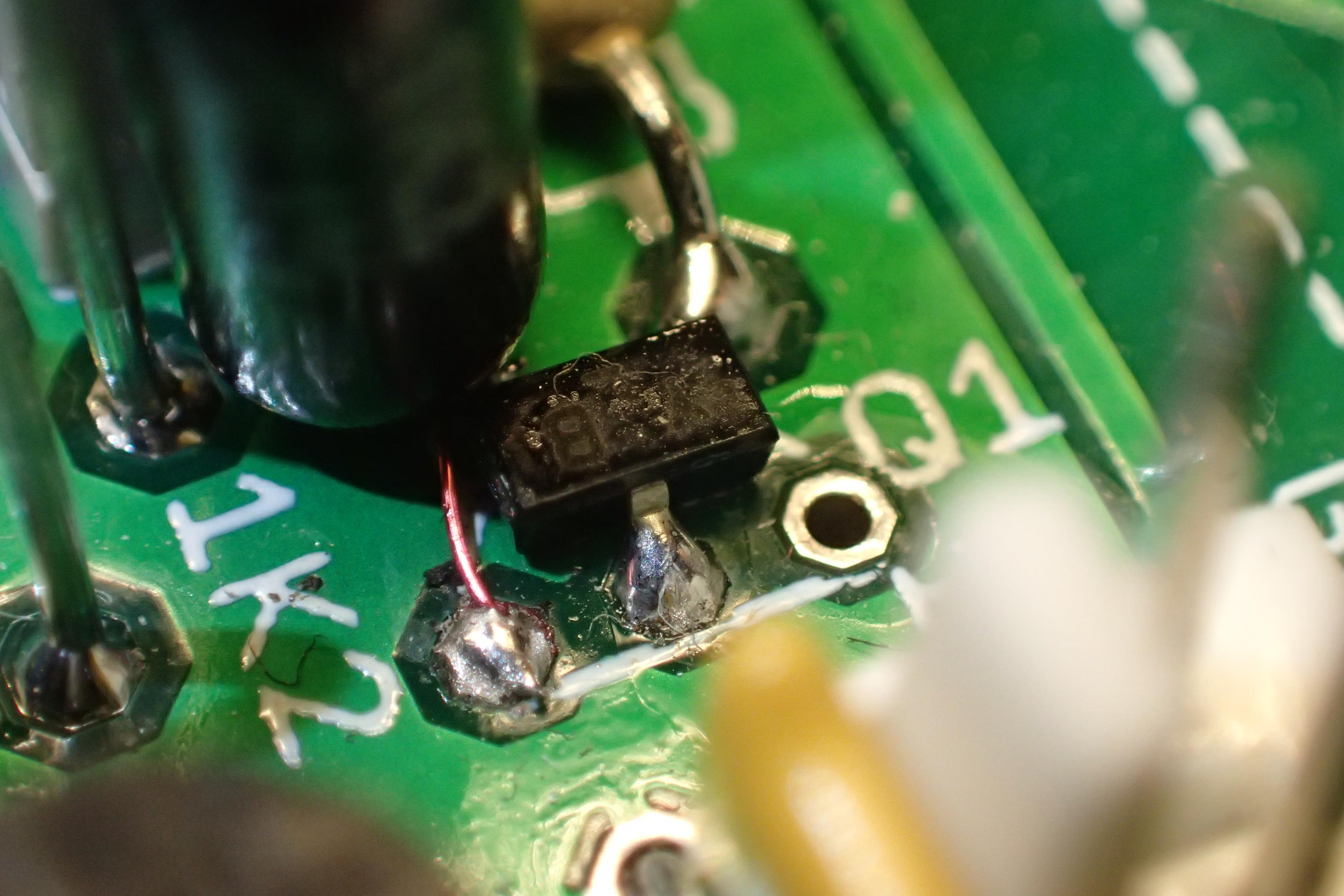

A bit crude but I managed to solder the surface mount version of the 5LN01SP driectly to the PCB. It just needed a small wire link for the source as the other pins sat between the pad and the gate resistor.

- I'd add PCB test points to the LDRs.
- Add 2K2 pull-up resistors to the I2C bus (might be an issue because of the larger display I'm using)
- Add the surface mount footprint for the transistor
Thanks garym999. Like many others I have a slight fear of smd as I've melted a few smd components in the past but I am certain I can do it and with the pin out being fine I am confident it'll be alright. If I do have to order them I will keep your suggestions in mind.
Cheers
Cheers
Age is getting the better of my eyes now but a nice fine tip on a temp controlled soldering iron & fine solder is OK for one offs like this. If you lightly wet the a solder pad first and the place the component on the pad with a cocktail stick, a quick touch with the iron will get your first joint. Then its easy.
