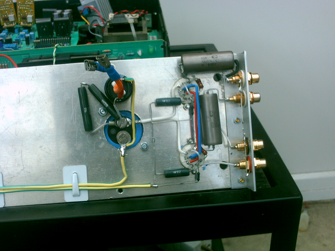

CD switched on but not playing and turn up the volume to around 12 and there's some hum. Not sure about the input resistor fancy dan loop I made and may make a separate ground for each channel - once I've got my light bulb thing working to discharge the caps 🙂
Plus rubber gloves, wellington boots and face mask
Can you see any flaws there somewhere ?

The wiring all looks correct on the tube pins. I think you have grounding problems. You have a star ground off R1 & R2. I don't see a ground from your RCA negs going to that ground. Also I don't see a ground wire going to ground from pin 9. Basically all ground points should come together at one place, then go to the earth ground at your power outlet. There should be a strong connection between metal chassi and earth ground at near the iec power inlet. In america the iec has 3 prongs, hot neutral and ground. Hot and nuetral go to the bridge rectifier. Your chassis ground and a wire from your star ground all go the the 3rd earth ground point on the iec plug. In the lapmizator guide he has a short section on grounding. All must go to the star point and from there to the earth ground. Make sure the chassis also goes to earth.
Check all your voltages. Anode should be somewhere around 180v. Pretty wide range still ok. 150-200 should work. Filament heaters should be 6.3v. I have run between 5.7 and 7.0 without issue.
I also do not see the source of power to the red and blue filament wires. I see you have these wired in parallel, so you should have 6.3v DC across pins 4&5 of each of the tubes.
Hope this helps. If you still get hum, that can be solved. Likely grounding issue. Your layout is good. There will be no induced noise.
Thanks for the feedback :
Pin 9 not grounded at all - should I ?
RCA socket grounds now have wire to star earth at IEC mains inlet
In fact ALL grounds only go to star at IEC mains inlet
R1 / R2 are on separate ground wires to the RCA's
Both L/R signal ' in ' RCA' grounds are connected to each other - should they be separate ?
I've got so many wires to the star I had to put a bigger bolt in !
Thinking this is wrong now - never understood earthing properly.

Pin 9 should be grounded.

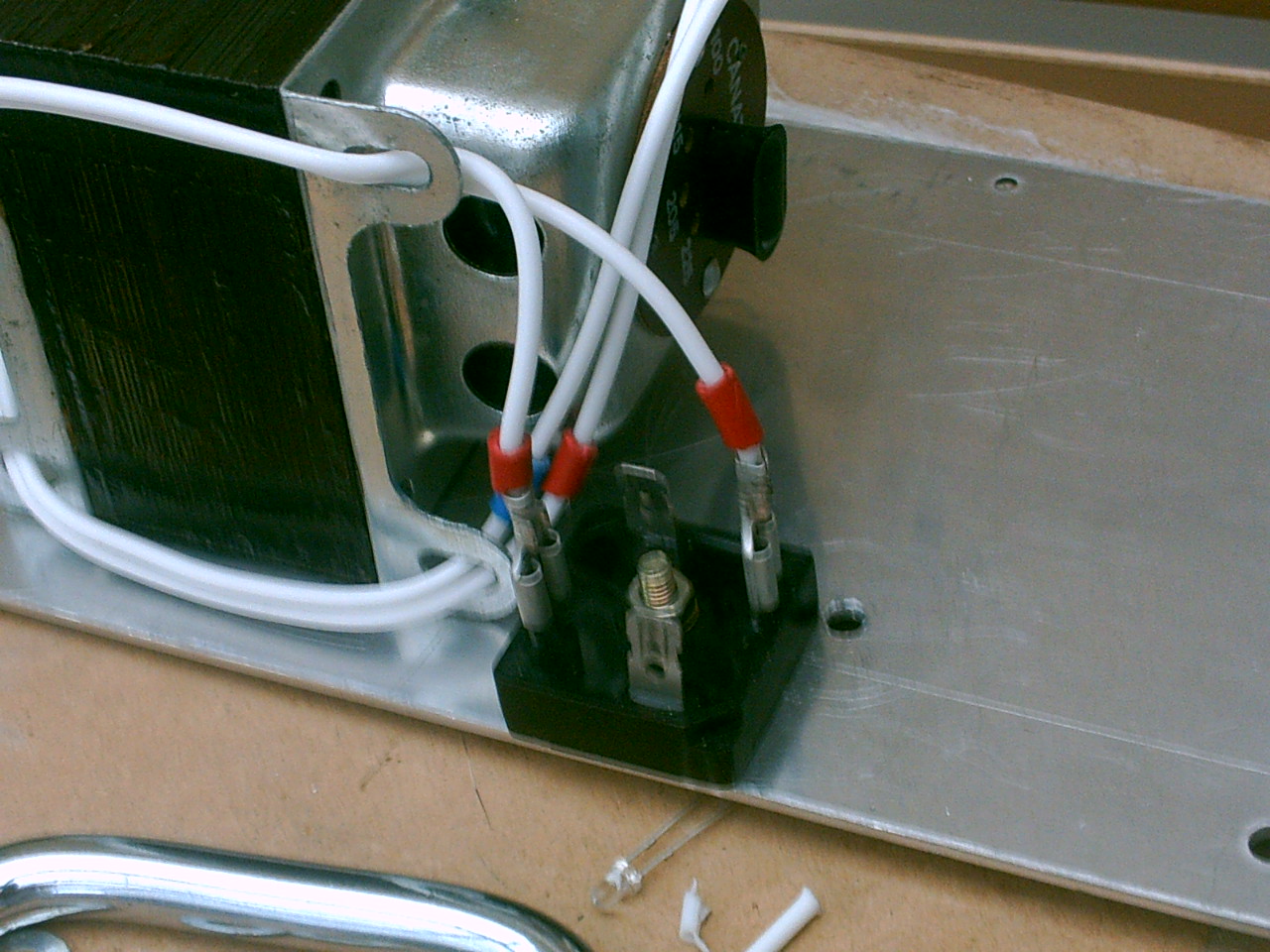

Slightly thicker is good on your main ground bus. Not critical in this set up I think. One place I read to think of all circuits like flowing water trying to find a free path to ground. It will take any path it can find. You want the current to flow away from your delicate signals to the ultimate destination which is earth ground. Not through the chassis (or you).
In my case I used the neg RCA tab as a local star for each channel and brought everything on the tube there. Then I ran those to the negative of the last filter caps.. then heavier wire to the first cap in the CRC filter, then to the iec socket. There is a short wire from the IEC to the chassis at that point. Lots of ways to do it. Mine was kind of a waterfall cascade, and as more piled on I added wire guage. Yours where they all come together at one point is probably best, but a little more wire.
Lukas has a little tutorial on how to track down hum. Make sure all your power wires are twisted. Transformer to bridge, bridge to filter all twisted.
Ultimately I went for super quiet. Bridge then big cap, then choke, then medium cap then separate rc filter for each channel. Even quieter would have been a choke per channel at that last stage. As it is with wires twisted and the three stage filter it is DEAD quiet. Ear tight to tweeter ever so slight hiss (from tube) and no hum. I mean quiet at high volume with ear tight on speaker. I also put small film cap bypasses right across the anode and pin 9 for a nice polishing touch. (this is future tuning.. just get it running for now)

If your amp(s) or Arcam have their signal ground connected to safety ground / earth then you've created an earth loop (obvious source of hum) with your new output stage. I know nothing about tubes but normally with DIY gear you will want to connect the chassis to safety earth very thoroughly (for safety) but not usually the signal ground (for the earth loop / hum reason). This is only an issue if something else in the system is connected to safety earth.
If there indeed was a loop you'll need to use insulated phono plugs and make sure there's no other connection from the chassis to signal ground, but this is an *if*.
Thanks Simon
The grounding is definitely the issue and will do some tests soon.

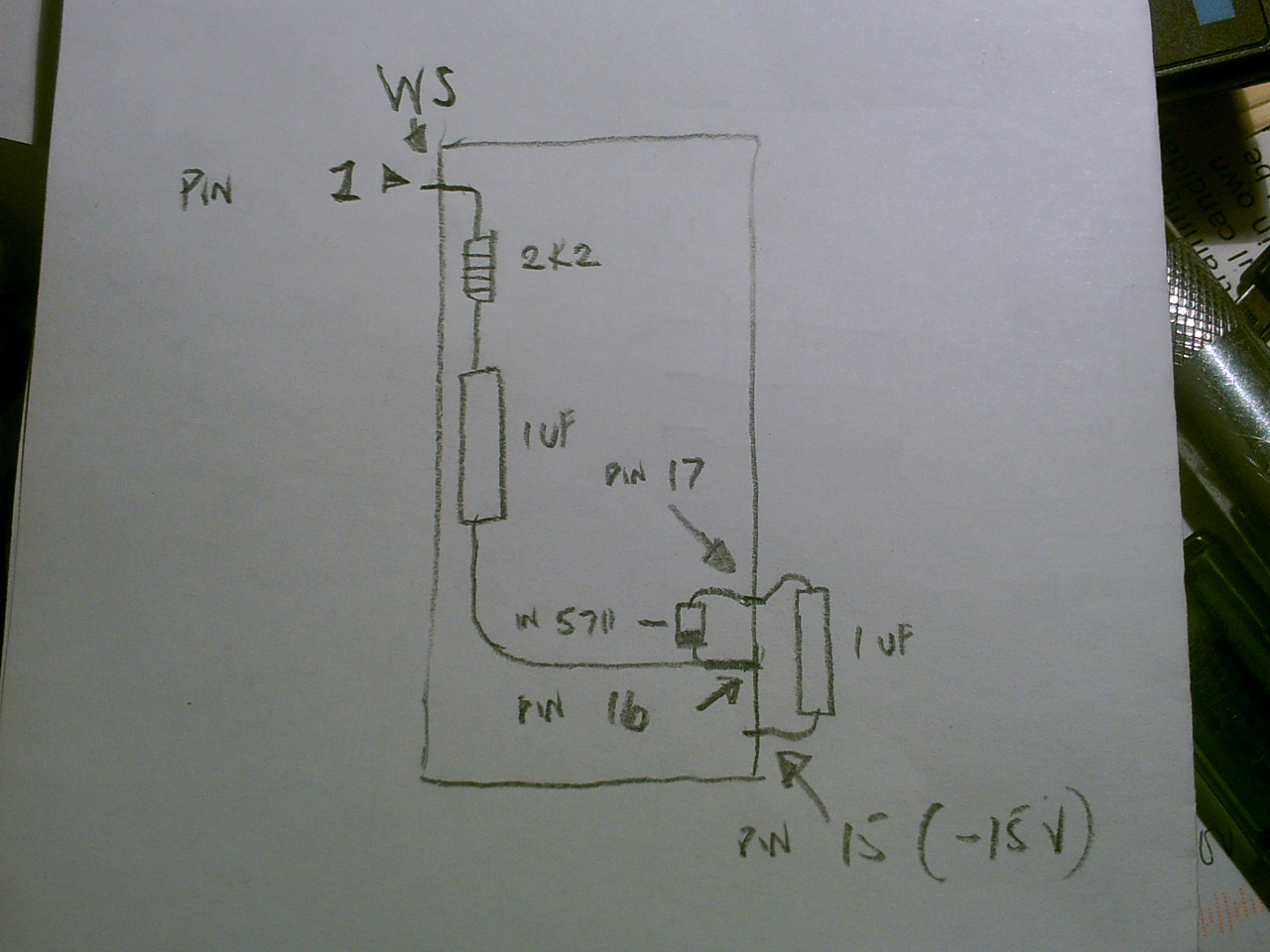

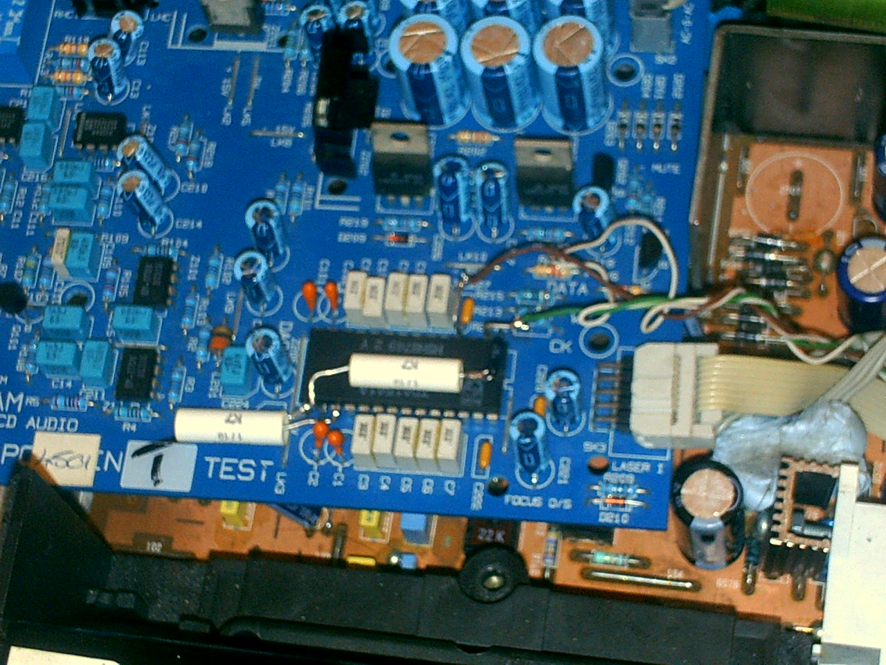

So. getting back on thread ( and I'm sorry I kind of moved it away for a day or two ) I have GOOD news.
I am DEM re clocked and it works fine.
In fact it works so damn fine I'm stunned as it's all on the spare Alpha board still crammed with 25 year old caps, NE5532 / OP27, standard diodes, no caps around the dac changed, original tantalums, no SEPC's......nowt !!!!
I'll attach the drawing and photos of the work done later tonight when I can find some ******* batteries for the camera ( kids ! )
I am very happy with this mod to say the least

OK, here it is - the drawing and the pic.
The photo is awful, used the flash - I'll get a better one when I do DEM to my modded ALPHA BOARD.
The diode is underneath where the 250pf silver mica was - across 16 and 17.
I'll get a pic of that tomorrow too
It's been running a couple of hours now and there's no extra heat on th DAC chip or any odd sounds or distortion - clicks or pops.
The bass has lost a bit of it's bloom and is a bit harder and impactful, the vocals are not so forward and have receded slightly. The hf is sweet and clean in the upper octaves of close mic'd piano music - which could at times make me wince a little. It's also another step in the realism department and room acoustic.
The midrange is still as we know it - it's not spoiled in any way.
You can clearly see the bog standard board so I'm expecting a whopping big step again when I do it to the other board with all the tweaks.
VERY pleased with this one - it's a keeper - I'll also be applying it to the Alpha 5.

I put a 1u MCap across pin 15 & 26. I need to save my last 4 OSCON SEP for another application. Also, I was not sure which way to orient it so I found the non polar film cap a handy way to avoid the question.
Orientation - good point . If you use a polar (electrolytic, eg oscon) cap for the part I proposed, install it +ve to (-5v) and -ve to (-15v) rails. And do install it across the relevant dac pins, not more remotely e.g. across these supplies somewhere else: this cap works to keep this internal-to-dac 10v loop as small as possible.
