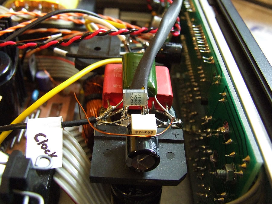

Technically I followed the Grundig circuit Andrew found. My execution with a soldering iron sucks, but I went for some tight fits. Put 200nf film caps right on pins 16 & 17 on the back side of the PCB. Used parts on hand. The caps werre pulled from the ARCAM board when I upgraded the first of the 14 decoupling caps. Would have liked to have had the surface mounted solid polymer caps ECDEsigns recommends, but could not wait for a parts shipment. Used a 2k7 Ritken from the parts bin instead of the 2k2 recommended. Seems fine. Added a pretty massive inductor on the -15v feed prior to the DEM circuit. ECDesigns advised that this would prevent noise from DEM oscillator getting back into rest of supply. I'll never know if this was good because I will not be touching this for a long time. The sound is quite fine.

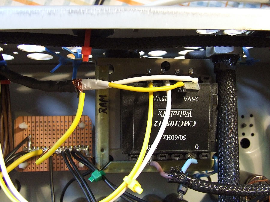

Oh dear, when I turn my CD player on it kills the radio in the kitchen DEAD. Not even just interference such as when a laptop is running off the mains in the room but total silence from the radio. If the external supplies are unplugged it doesn't happen so it's something to do with them - the unshielded wires to the Arcam or the incomplete metal chassis, or both. I could do with fixing this as the RFI leakage is only going to harm sound quality.
You haven't got unsmothed DC on those wires have you Simon - eg transformer/rectifier in one box, reservoir caps in the other? (asked only because that's about the noisiest way of doing things I can think of...)
Hi Martin,
Yes, the PSU box is full of DC. I've now isolated the cause of the radio interference. After a little chat with Brent he asked about the clock supplies and I went from there and found the issue. The clock supply transformer is off-board but, unlike my other supplies, feeds AC into the Alpha where it's rectified and smoothed to DC. I knew from experience not to have a clock supply off-board.
So I killed mains to the clock & CPU tx and that killed the interference dead. I then tried powering the tx but killing the winding that feeds the clock and that also worked fine. I think next I'm going to try running interconnect wire for the AC feed and ground the shield. Only obvious issue (Brent thought of this) could be radiation from the tx itself. We will see.
Martin, think of it like a top end Naim but more messy and with loads more transformers and smoothing, then you'll be close 😉
The issue is feeding the 'AC' to a remote rectifer PSU via this lead - all the noise from rectification gets radiated from the wire. Put the rectifiers next to the transformer and feed raw DC if you must. Wire should be a twisted pair - the noise is from 50Hz up so shielding alone may not help at all
If the rectifiers are part of the clock board end so you can't do this easily, try adding small 10nF film or ceramic caps across the AC wire at both ends of the cable - it may be enough to suppress things a bit.
I've previously been told that the rectifiers must be next to the smoothing cap for best results - so we have a conflict of interests in the layout, right?

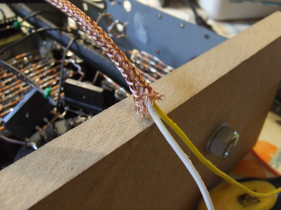

I've tried a twisted pair and the effect on the radio is the same. I've now taken the two braided layers off some interconnect wire and am fitting them over the twisted pair. I'm not holding my breath but I want to try it at least.

No conflict - you need to keep the transformer and the rectifiers and the reservoir caps all close together. Such loops are incredibly noisy.
So to do remote PSUs right, you need to send smoothed DC down the link and have additional local reservoir caps in the load at least. *
If the additional small caps don't work, a bit of brute force should - add a small resistors in each leg of your output from the transformer, 4.7 - 10ohms each if you can stand the resulting voltage drop. It will reduce emissions because it is effectively a low-pass filter with the (remote) reservoir cap.

OK, the shielding and 22nF caps at each end have made no difference to killing that radio station but the funny thing is I just tried tuning into other stations and everything worked just fine. It just ruins Rother FM LOL

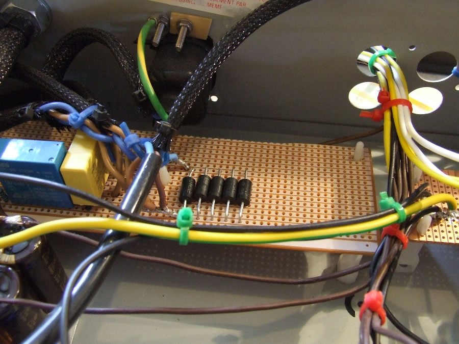

I also dropped in some transient diodes across live-neutral for spike killing.
