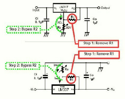

Bad news re the Bursons - thought they were drop in units and required just a small mod ? see atached pic
I'm fairly sure they are good for up to 250ma 😕
I'll contact Lucas direct re buffer - his lampizator drawings and comment can be a bit short of fine detail ( well, for me anyway )

I got the first generation Bursons on a clearance sale. They are only 80ma. could be it is just too much for the -15v one to drive its consumer and the other -5v reg and it's consumers. I am going to take my time and rewire without the cascade. Each reg will be fed off the 24v rail independently. I am also going to mount them right at the tda1541 consummer with point to point twisted pair back to the rail. They are a bit bulky for this application. They do add quite a lump to the Arcam.

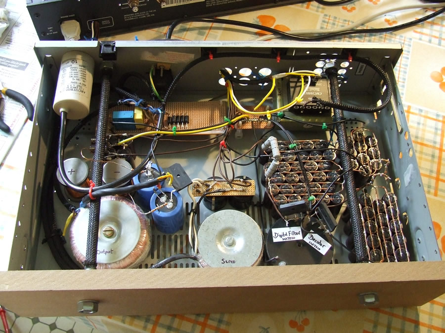

In case it helps, here is a picture of the lampizator output stage on my backup machine. It is playing while the Arcam goes back to the drawing board. It is running 6np6 tubes right off the I output of ad1860N dac chips btw and it sounds quite sublime.
I build the tube stage across the back panel. RCA output right beside the tubes which are close as possible to dac. The mains comes in on the left side. B+ power is the first pair of caps on the left. after the bridge, 2x100u 250v with 1k resistor linking the positive. Filtered power goes across the back with red/black twisted pair feeding via another 1k resistor another 100u cap for each tube. (so separate power supply to each & double filtered as Lukas recommends. The ground is as follows. Larger white wires take ground from rca neg to negative side of the first filter caps. Then another heavy wire takes it right back to the earth lead on the mains socket. There is very close to the mains a wire to a bolt in the chassis to ground the box 🙂. At each tube I use the neg RCA tab as my first star point for collecting ground. Pin 9, the dac neg lead, and the neg side of the last crc filter all go there and then from there back as described. So there are multiple star points but they all allow current to flow away from the signal source to the mains. Similarly with the filter supply, the power comes from the mains to that second CRC filter. Here it is 2x10k u 25v caps separated by a 1r 5w resistor. In fact to get enough current for the hungry 6n6p I even bypass the 1 ohm resistor so its actually just a bridge followed by 20ku caps. I take the filtered DC on twisted pair to pins 4,5 of each tube. The neg side of the filter is grounded back (nuther white 18gauge wire) to the earth ground at left.
So it is not neat. I am using dirt cheap caps from a surplus store and penny resistors. It is dead silent and sounds quite good. The arcam has all cool caps and more of them, chokes, and Kiwame resistors and sounds quite nice. I add this as a concrete example. This one did sound bad at first and I swaped out a pair of suspect caps.

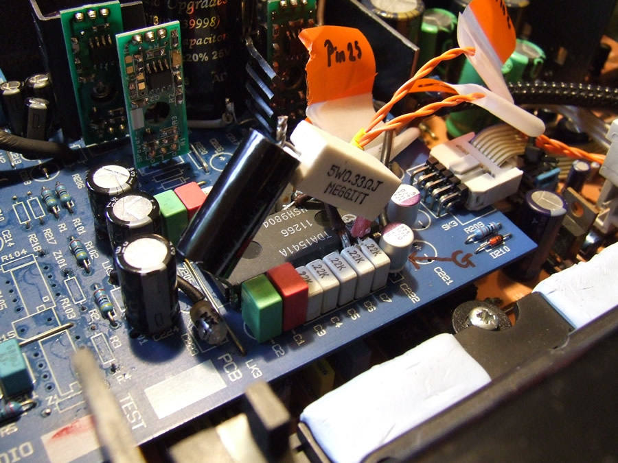

Burson shunts in!
Whew! In a mad soldering marathon I rewired and have Burson regs on -15v and -5v. As I suspected, there just was not enough power capacity in the -15 reg to power the rest. As soon as I removed the -5v LM337, the voltage shot up to 14.85 on pin 15. I then went point to point picking power right off the rail. Turns out I have 26.5v on the rail which is a bit scary as the BGN caps are only 25V rated. Seems they have a little buffer. Wired the -5v reg close to pin 26.
Board now looking even more like a mad scientist creation.
Checked voltage output on the reg. It was -5.00 spot on. I proceeded to wire it to the Oscon at pin 26. Voltage saged a bit under load. One thing that is cool about the regs is they are adjustable. With a little jeweler's screw driver I adjusted the voltages to be exactly -15.00v and -5.00. Plugged it into the system and music happened.
It's late, my wife calling me to come to bed, so only a couple of samples. I must say it is worth the effort. Not as dramatic as the DEM but same league. First impressions confirm the Burson marketing pitch. Yet more realistic sound stage. More 3d and very relaxed. Seems like some more detail. Need to do some serious listening on the weekend. 😱

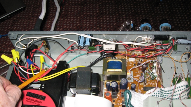

The work on this Sony looks very neat and tidy - lampization expert !!
Once I finish some stuff ( loads ) I'll do a proper lampz job and see what happens.
