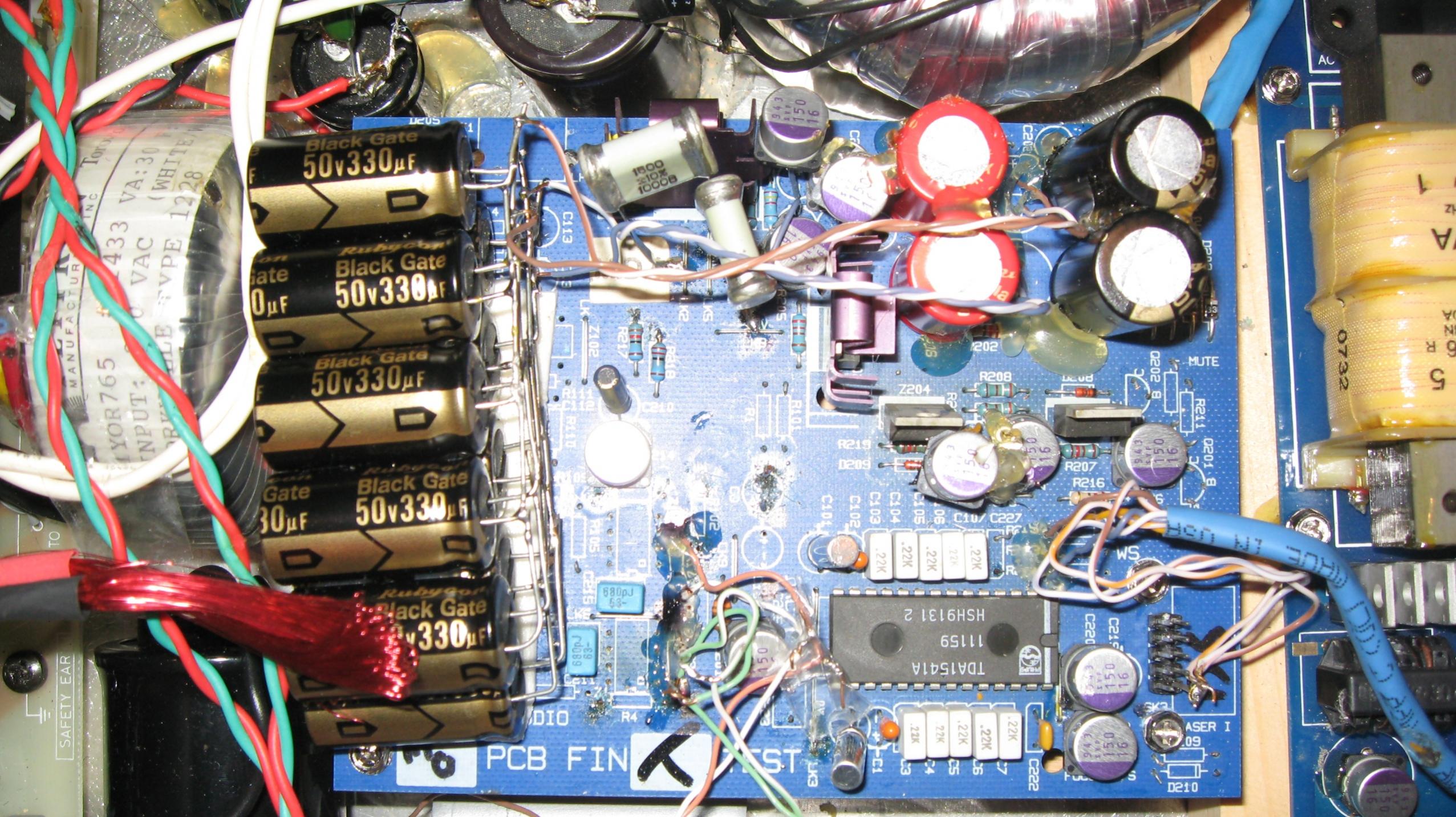

Congratulations Andrew! It is quite magical isn't it.
The answer to how much can you remove? All of it! Every last opp amp.
I pick the signal right off the output pins. See picture below. I actually pick it up at R3 and R103 for convenience. I ripped the little opamp devils off the board to stop them stinking the place up!
It would be better even better right at pins 5 and 25.
As EC Designs says, get rid of them all.
Andrew, using 6np6 you may have to leave the first op amp. At some point, it would be interesting to test picking up the signal before the op amps and see if you have enough gain to drive the 6np6. Worst case, join me in using 6n2p. They are equally great, just different, but with 10x more gain. Once you prove that you can steal signal without opamps, time for an opampectomy. With a pair of pliars you can pull them out like a bad tooth. Even after you stop using them, things get better just getting them off the power supply as they pollute that as well.

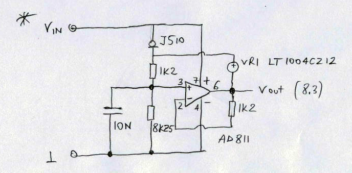

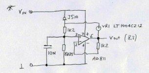

That 'voltage reg' may be designed to drive a reference pin on the TDA1543 or similar but it's a really poor regulator. For a start, it isn't going to deliver more than 25dB or so of ripple rejection . And any noise benefit from using the LM811 is lost due to the high source impedances it 'sees'. Finally, it's output current is very, very limited. Definitely not a superreg!

Yes.. Peter has a thread "pushing the limits of 1543 DAC. He, Bobkin and Uncle Leon have pushed his dac to another level ... shunt regs described, but Peter commented they got nearly as good results using this series reg. I will try mine on the clock.
Glad to hear the valve stage worked out so well.
68 Should be fine. I am likely high at 90. One guy claims he's measured distortion at higher values. Others prefer the sharper edge at 90-100.
6n2p is a drop in replacement, but the filament current is much lower so you'll likely need to increase the resistance in the CRC filter up to 5 - 10 ohms to get 6.3 V.
Edit for afterthought - I think there's somethign wrong with the diagram as posted. rearranged as a more conventional series reg it'll do a bit better than I suggest above, but it's not optimal.
Thanks Martin. I'll try it on a low load pin somewhere. I'll check with the designer to see if they are sure they penned the design correctly. Otherwise sounds like its back to the drawing board. I was attracted by the simplicity and low parts count.

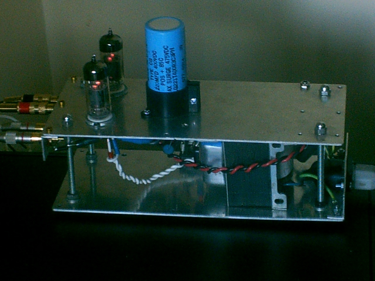

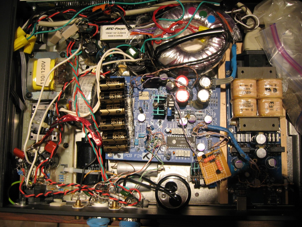

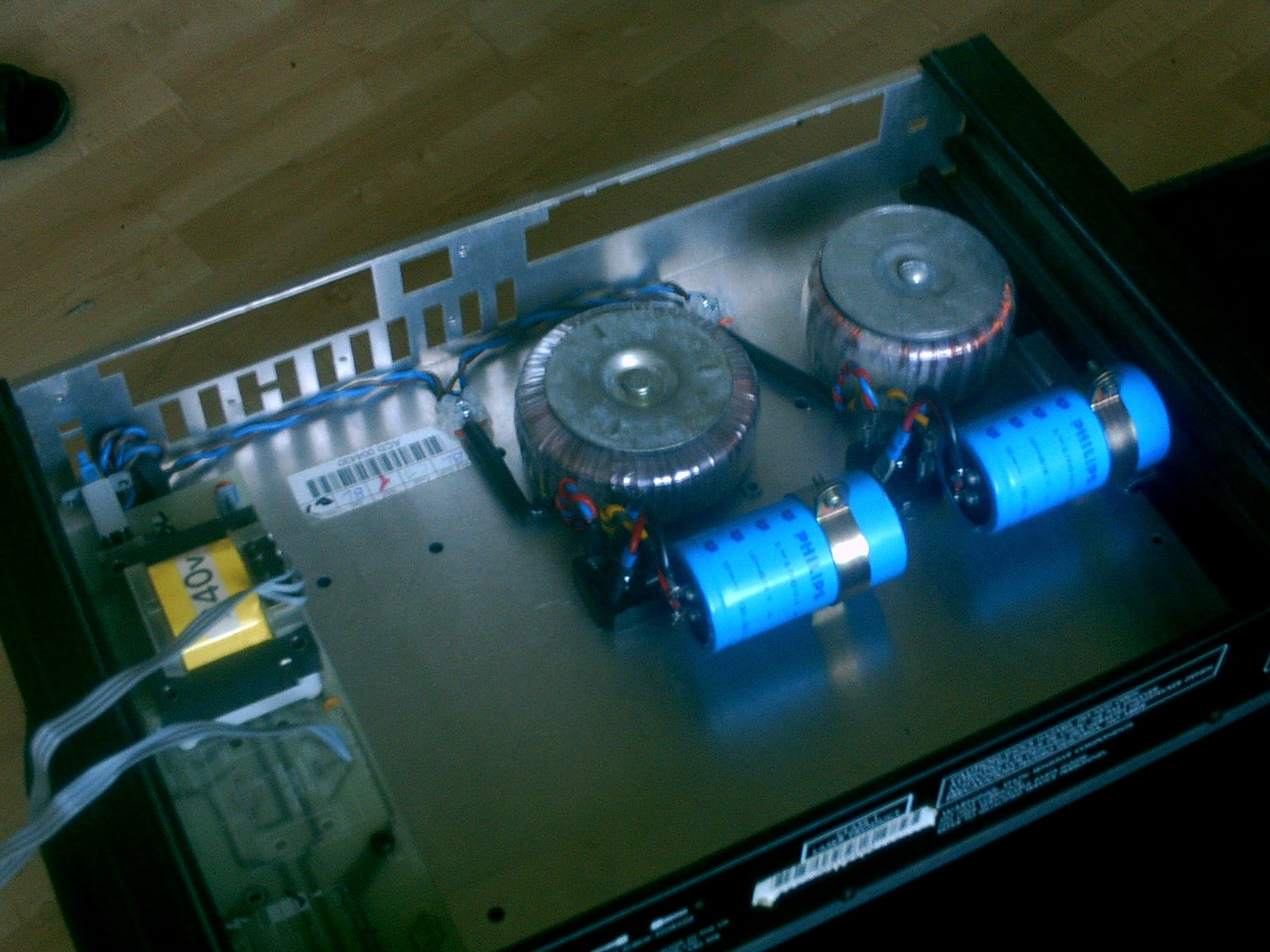

Couple of update pics - power supply as of Sunday gone and the valve buffer.
One more traff to fit to the ps plus the fittings / fixings and then a test as early as Friday hopefully. Also the dac board will be completely stripped of it's original output stage too.
I've decided it's too complicated and probably stupid to attempt the idea of powering the whole player from this external box. So I'll leave in the main player the original larger traff and have the clock ps only.
The DAC traffo will be in the new box as per photo.

Nice job! Both look great. I particularly like your tube buffer.
