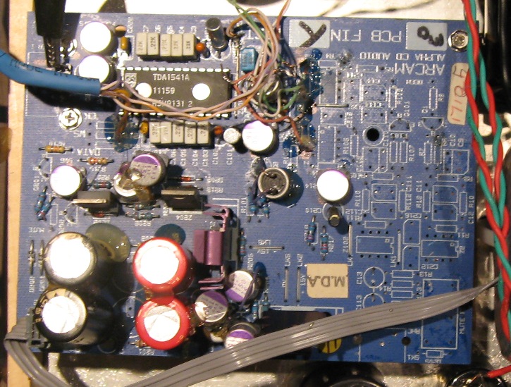

For about the 10th time I have messed this thing up. It is getting harder to debug it at this stage as there are quite a few weak solder points that could go bad. It really is time to get a scope to see what is really going on.
I had weak solder on the caps on the MSB pins, and had trouble getting one of them soldered. It played, but had lots of distortion in one channel. It is possible that I got too much heat on the 1541a. Anyone following my lead with the surface mount caps, I advise keeping them under the board to keep the heat away from the 1541a. Also possible I just have a bad solder pt somewhere or a small piece across 2 pins. 🙁
However there was one observation that I would like to note. As an experiment, I switched the DEM signal from WS to BCK. In the brief period before I pooched it the SQ was very promising. After rereading through pages of posts on the DEM topic it appeared that taking raw BCK at 2.8m is in some cases possible if the decoupling is well done. It is also a very simple experiment as it just means moving one lead from pin 1 to pin 2. Easy to reverse. Of course like me it is also easy to inadvertently kill something in the process.

DONE!!
Right you are Andrew! It took me 4 hours, but I went over every inch and found a number of issues that are now corrected. Ultimately, a broken solder joint on one of the super regs did it in.
Now for the good news. It works, and it is sublime. Like Andrew, and I suspect Simon I am off to other things. There may be marginal increases to be had, but the risk of breaking it is now too great, and I value it immensely. If I take it up a notch, it will be a new hand wired TDA1541a using all the learning from here and EC Designs.
The 8.2u organic caps on the pins turned to be a real winner. I would not wish the exercise on anyone. Better to do it on a scratch build. The other key thing that worked out for me was soldering caps right on pins 16 & 17 + and inductor for good power from pin 15. With all of this, I am able to run DEM right off the BCK WITHOUT flip flops / reclockers or anything. That is 64xWS or 2.8mHz. Sound is superb. I am 2x EC Designs rate which is 32xWS. I also finished the board and all components by cleaning up with rubbing alcohol to get rid of dirt and solder flux. This should help minimize leakage.
So how I ended up is decoupling with 8.2u SMT organics on the first 6 pins leaving in place the ARCAM supplied Tantalum and film caps. The 7th pin has just the 220n film cap, no organic. I am leaving the Burson regs on -5 and -15 and the original LM317 on the +5. I figure with lots of OSCON SEP caps how bad can it be. It has its own transformer winding followed by BG CRC filtering bypassed with Russian silver Mica. Its possible it would be better with one more super reg, but I will never know. Again I am done.
With this new level of detail and resolution, I actually had to go back and retune the source. I drive with a CMP2 computer transport. It allows you to tune the algorithms for phase and bandwidth essentially dialing in where inevitable ringing occurs. I think that is a sign of the new level of resolution. Before this, I could barely understand what these settings were for.
Andrew, post details of the IV stage. That is something of interest for both my tube output stages. Thank you
Andrew, the new amp project sounds like a winner. I too am back to building my tube amps.
