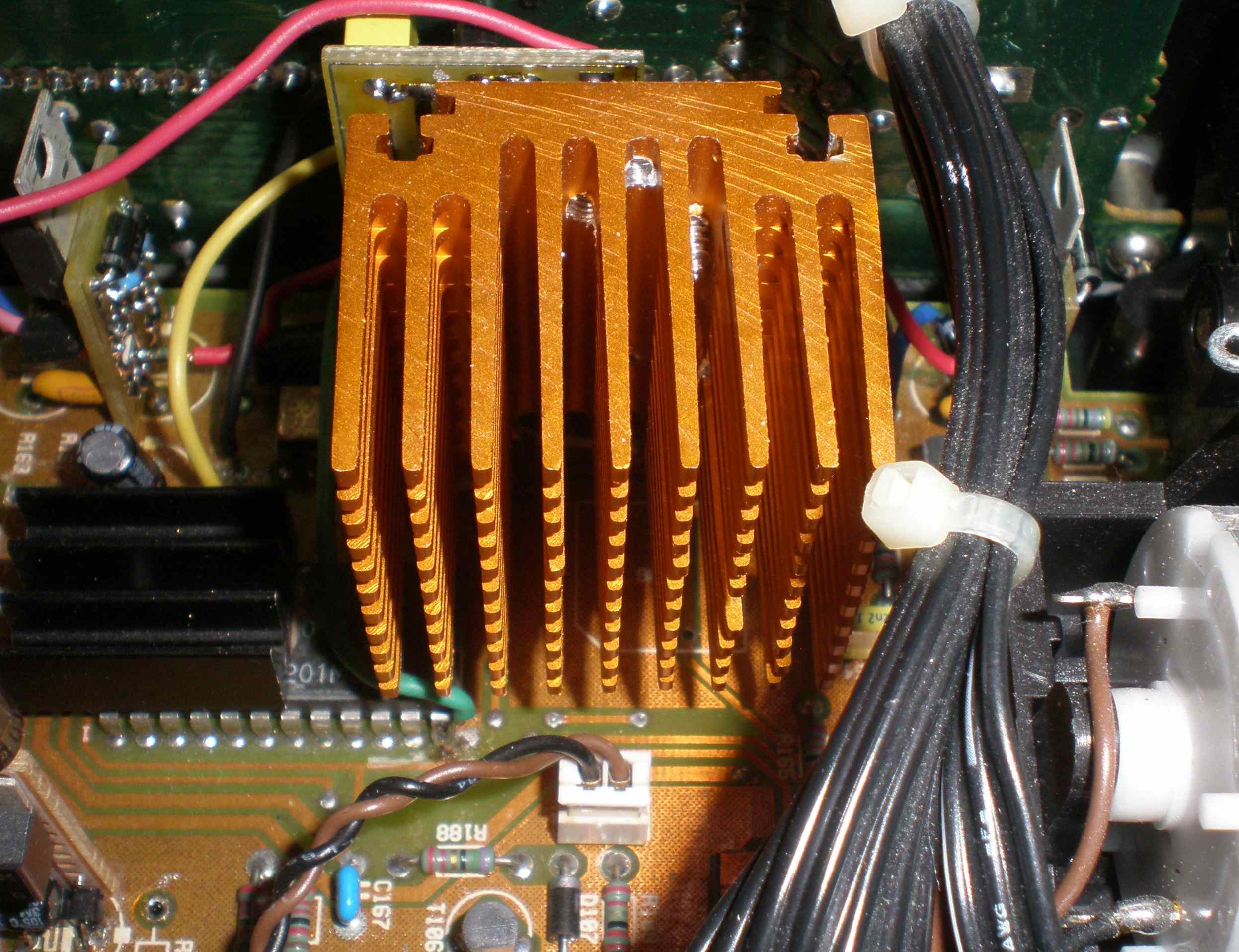

I have an LM317 based regulator on the 7220 with the ground wire soldere directly to the chips ground pin. The heatsink is quite large but it still gets quite warm. I took the ground from the 'Kelvin' ground point of the reg direct to pin 12 on the chip. You can see the bit of green cable poking out under the heatsink in the photo.
