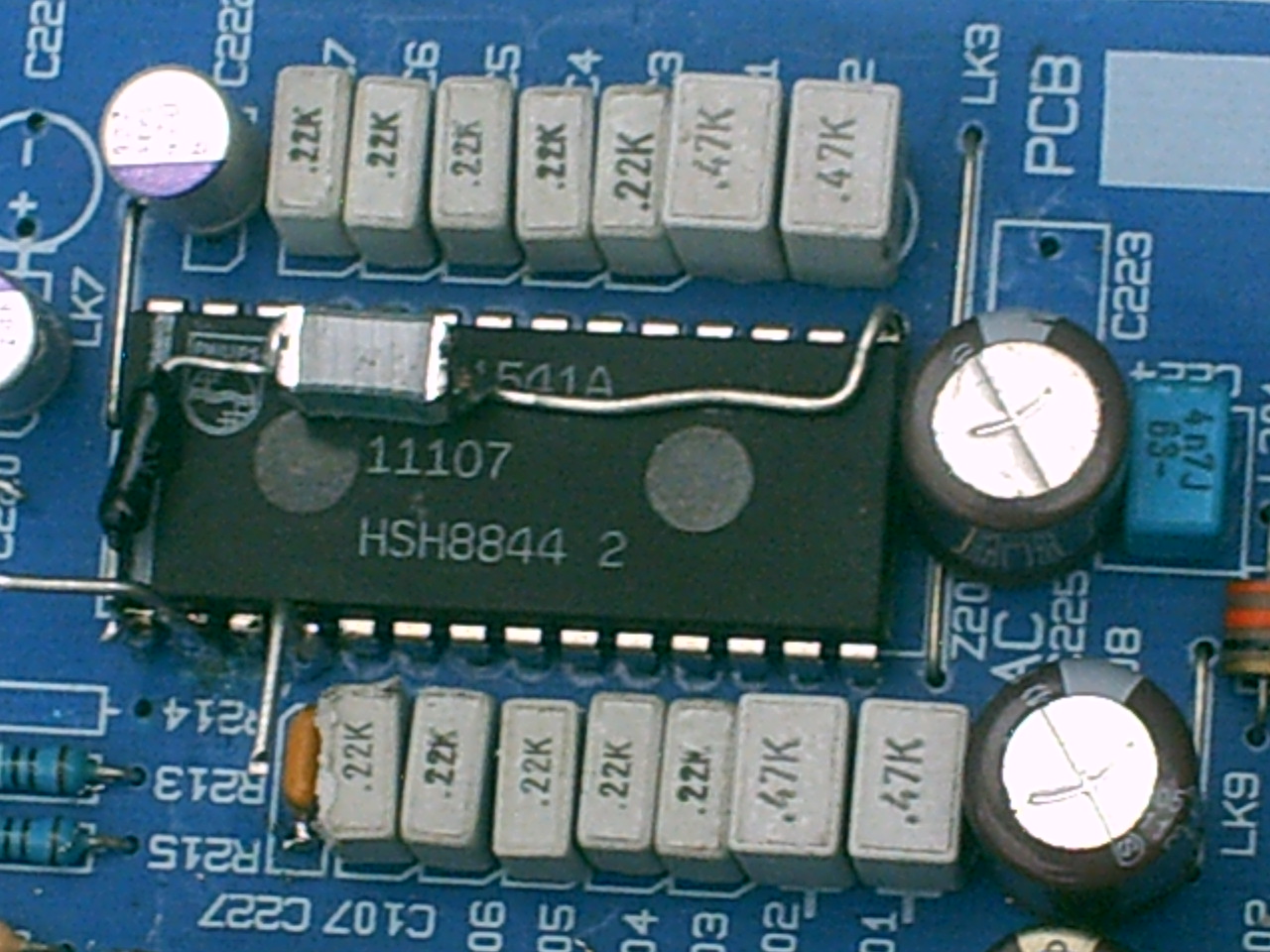

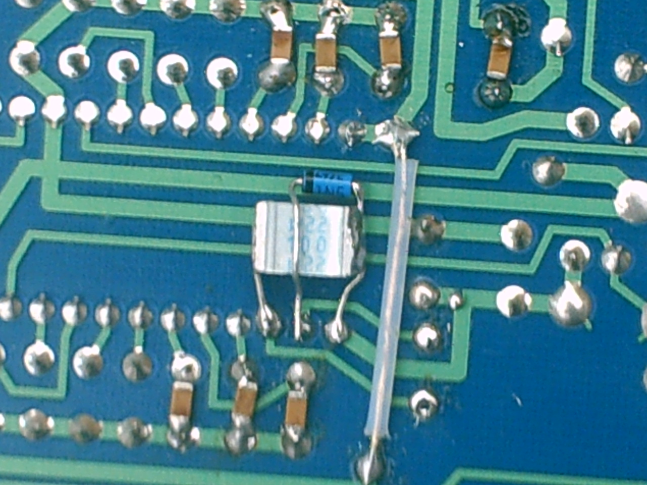

Seems there is another DEM trick that I missed by a mile today too - like I put the zener in the wrong place ?.......but why does it work so well ?
I'll be making some changes in the morning - do the test again and advise asap
Have valve buffer almost ready to try too - could all happen at once tomorrow.
Splitting the input grounds and routing to the new star .
Both pin 9's now grounded too. I reckon I'll have cracked it all by tomorrow evening

If the rail to the -15v doesn't have a little bit of RC decoupling ahead of the -15v reg, add some. 10ohms and a 10-100uF is enough. It will clear-up noise that otherwise passes right through regs
Even if it's an op-amp based super-reg ie. S Power? I'm making a list of several tweeks to do at once today and wondering about this one.
I'm going to feed the -5V S Power directly from -24V and install the silver mica and a cap from -5 to -15V. I'll probably have to put those two caps underneath the audio board.

The Alpha board has LC right before the -15v consumer. L201 followed by C224,5. It is less than a cm. In my case I put OSCON SEPC 130u at C224 and left the stock film bypass. Just before the Reg is a CRC consisting of 3600uf BG STD and BG N. I think my issue remains to replace the LM337 reg with something discrete. I know your super reg worked well, but its too$$ for my setup. I'm looking at ECDesigns for inspiration.
You can make these super regs DIY, but making them neatly / compact is perhaps another matter. Sometimes old Audiocom units appear cheaply on Ebay too.
I removed the inductor and film bypass as they were in the way of the new elco. My SEPCs are all 6.3V-rated so I had to use a Rubycon ZA, probably a 220u/35V, which also has outstanding specs. TBH I thought the film cap was a bit pointless without it being nearer and when it's mated to an already-good elco.
Final implementation as attached.
Just running unit now - too early to say.
Works great though - more later

That's it - no more or a while now - it's all done on the tweaked board and is installed - I did the Oscon tweak across -5 and -15 too.
It's been running quite a few hours now and have had a good listen.
Smooth and more detailed - period.
The attack speed has improved quite markedly
Background details are part of the ' whole ' in a way that were not last night or before - room acoustic has moved another step and Piano pedal movement is now easy to hear - who whats to hear that ?
Actually - I do 😉
Simon, you've commented in the past about the sound of drums being amazing in your system - well, it's just an opinion but I think you are going to get a bit more of that 🙂
It's just tremendous and the whole thing could get a bit better once it all settles down too plus the valve stage could be an addition soon.
I quietened it down quite a bit this afternoon by fiddling round with a few grounds as per your suggestions - not perfect yet but I'm on a roll here😎.
So far as what it does musically is concerned it's lovely so I'm going to push on with it until I can silence it completely.
Looking forward to seeing your progress next

Simon - yes, even with superregs a bit of RC ahead of them can help.
Do keep the R value fairly small though, up to say 10ohms works well. Active regulators can go unstable or perform worse when fed from high supply impedance; this is why 3-pin reg datasheets always show a small cap on the input to a reg - it is always a good idea. If manufacturers could guarantee stability with out, I'm sure they wouldn't mention it!

IN 5711 - little zener types - about 40 cents each in your money !!
