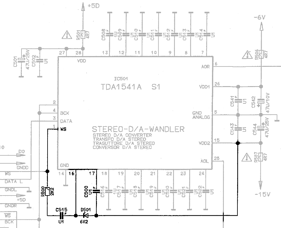

DEM method is aborted and I'm implementing this instead ( attachment )

Ok - now for a head scratcher... does C227 not already do this?
-5 @ pin 26 goes to digital ground via c221,c222
-15 @pin 15 goes to analogue ground via c224,c225
digi and ana ground are tied together via c227. Basically we are adding caps to c227
I think I actually killed that one some time ago thinking it would be good to have digital ground not send very high frequency over to analogue ground. I thought at the time it was good. I have a couple of options in my used cap drawer. There is a BGN 47U at one extreme. At the other end are my newly aquired 1500pf silver mica russian military looking for a use. perhaps its time to experiment. Thoughts?
Had a look at the schematic now - no, this extra cap i suggest is doing something quite different.
C227 is odd to me - most other implementations (and the quietest way of doing things) would be to have just one ground plane and the analogue and digital grounds going into it. The only reason these have different pins on dacs is to keep the current loops inside the chip separate - sharing one tiny internal bond wire for all digital and analogue 0v return current would badly degrade performance by crosstalk.

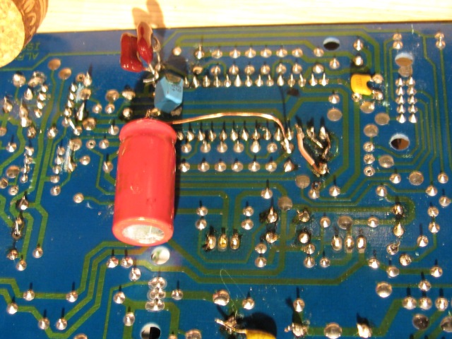

Cap in on -5 & -15
I did go back in and install a cap across the -5 %-15 pins. Also added some 24 guage copper wire to take analogue ground pin out to where I attach my ground wires to the tube output stage.
I have now been listening for about an hour, so all this new stuff has yet to fully settle.
At first I wondered if I liked it. There is a lot more bass. Enough that I realized I had turned down the volume. With less emphasis on the higher registers, there was alot less fireworks.
There is no less definition. Clearly a relaxed, liquid sound. I don't have a turntable, but I imagine this is very analogue. No hint of digital hash, or fatigue. That new range of crystal clear detail in the upper registers that came with the DEM reclocking is absolutely there. Its just very laid back and easy now.

Oh BTW, the cap I put is was an old MCap aluminum/film 1u 250v. It is well broken in as it was the output coupling cap at first. Later pushed aside by Obligatos and Russian Teflon, so why not. forgive the blurry photo, but attached pic of my handy work.

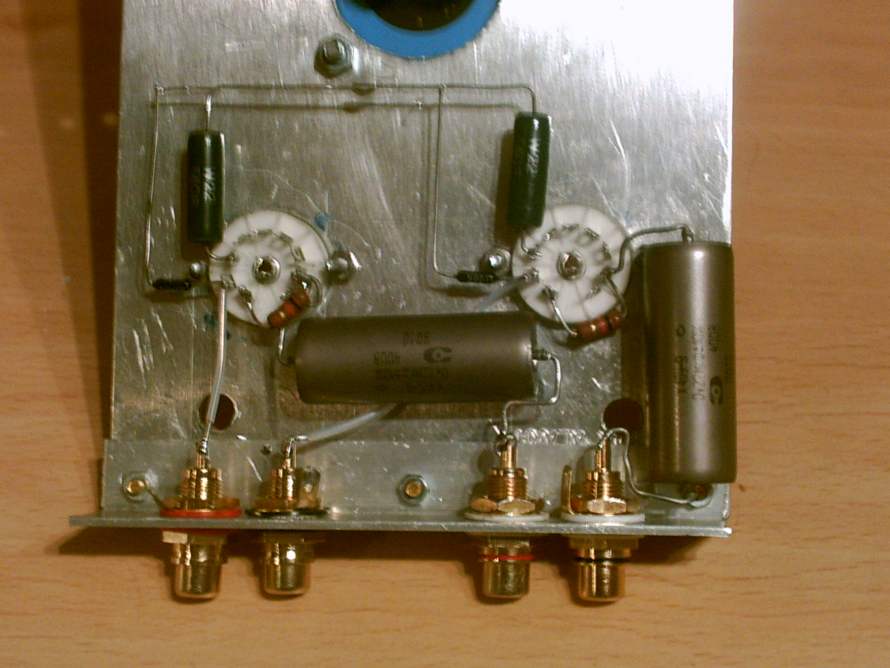

6N6P - direct off the DAC chip ?
How did you do i/v - resistor ?
Fikus told me to go straight off the op amp because the low gain of the valve would be insufficient.

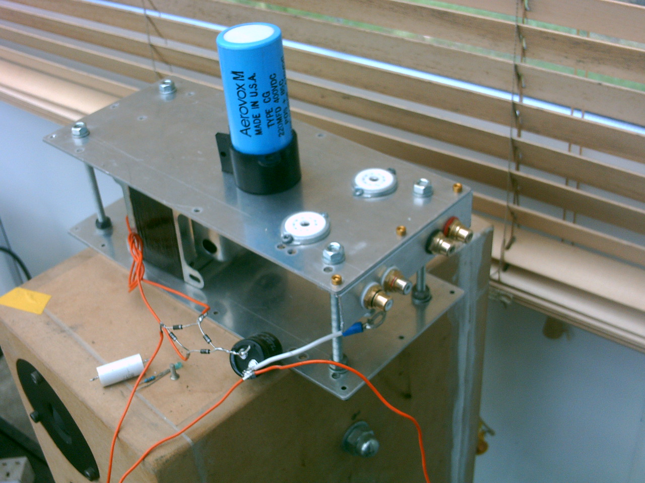

You can see my state of readiness with the buffer ( ignore the test rect diodes mess - have newer solution already in place )
It'll be tested today between CD and volume as a straight buffer but once I'm happy that a....it works and.. b....I like it... I'm going to wire it as an output stage off the i/v opamps.
Unless of course you tell me it's OK straight off the DAC - that'll make my day.

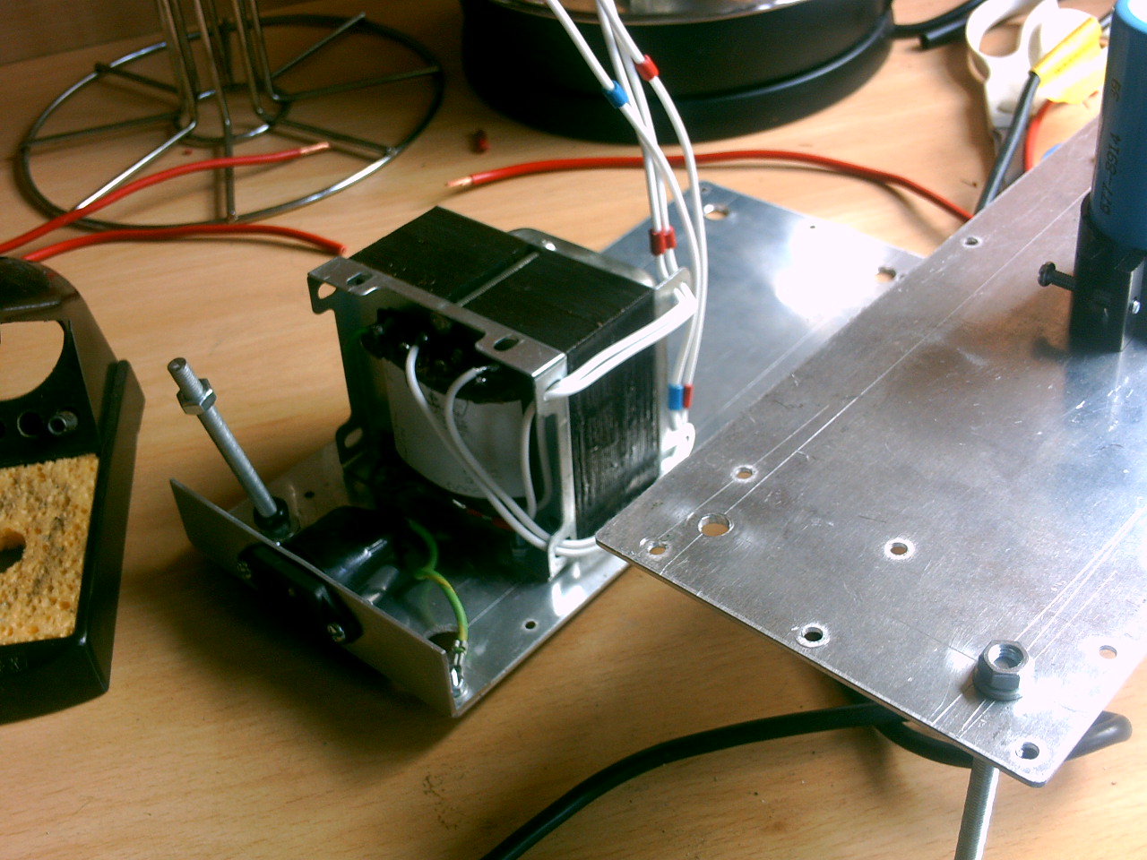

Then DEM and then back to the amps and the external PS box for the CD player.
