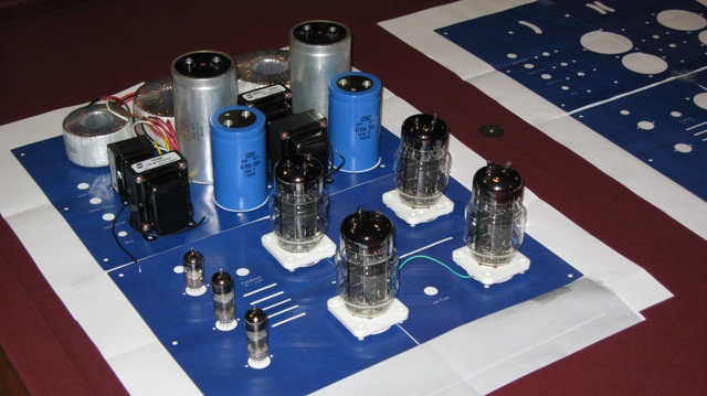

My main project is long a long slow run at building my first tube amp. I think getting the source really right will be important before this comes online. Its clear that my current amp is not the limitation, it remains the source.
Here's a preview of the amp project, btw - just finalizing the layout. Very exciting..

Oh yeah - loving that pic !!
Want one of those😉

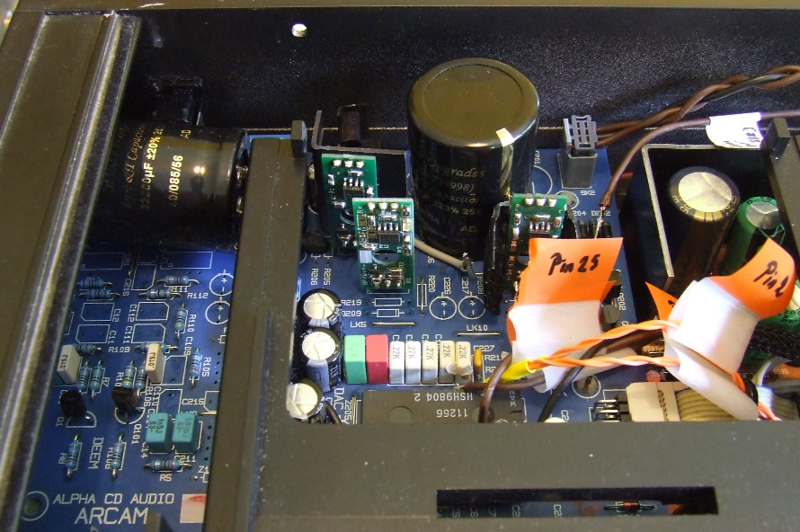

Have you seen inside an Arcam Alpha? Specifically, the DAC / output board that Arcam use to differentiate it from the stock Philips design? The -15V reg (LM337 as stock) feeds the -5V reg. Same with the +15 and +5 regs. These then feed the op-amps (removed on my model) and DAC's +5, -5 and -15V. What do you think of this cascaded sort of regulation? I left it as standard for now but thought it might be better done "directly".
What do you think of the layout? Are these regs too far away for high performance? I thought not but you seem to be getting at something, unless that wasn't directed at me (it felt like it was as I am using the good regs round here!)

Not sure what you are using for the I/v stage Simon but it is critical to getting the best out of this DAC. IIRC some arcams had OP27s in there - a more ill-suited part I can hardly imagine, though it sounds very 'polite'.
The point about cascaded regs - I'll have to have a look at the Arcam's manual this weekend. I can think of one way it may not help - the internal current source reference in the 1541 is between the -15 and -5 supplies; keeping a constant 10v between these two supplies is more important than it appears and the reg cascade is going to do some (ahem) interesting things to that.
With a conventional hookup of -5 and -15 regs you can experiment with a small but good cap between the -5 and -15v pins of the dac* This one extra cap - say a 10uF oscon - closes the loop and helps maintain this 10v difference nice and quiet at HF, where it matters😉
(With the regs in cascade this extra cap would be an AC connection across the -5v reg input to output and probably result in a power oscillator or, at the very least, negate the point of having a regulator there - beware!)
* if you have a scope you may find adding a bit of RC damping at the output of one or both regs to 0v is required for best stability / effect.

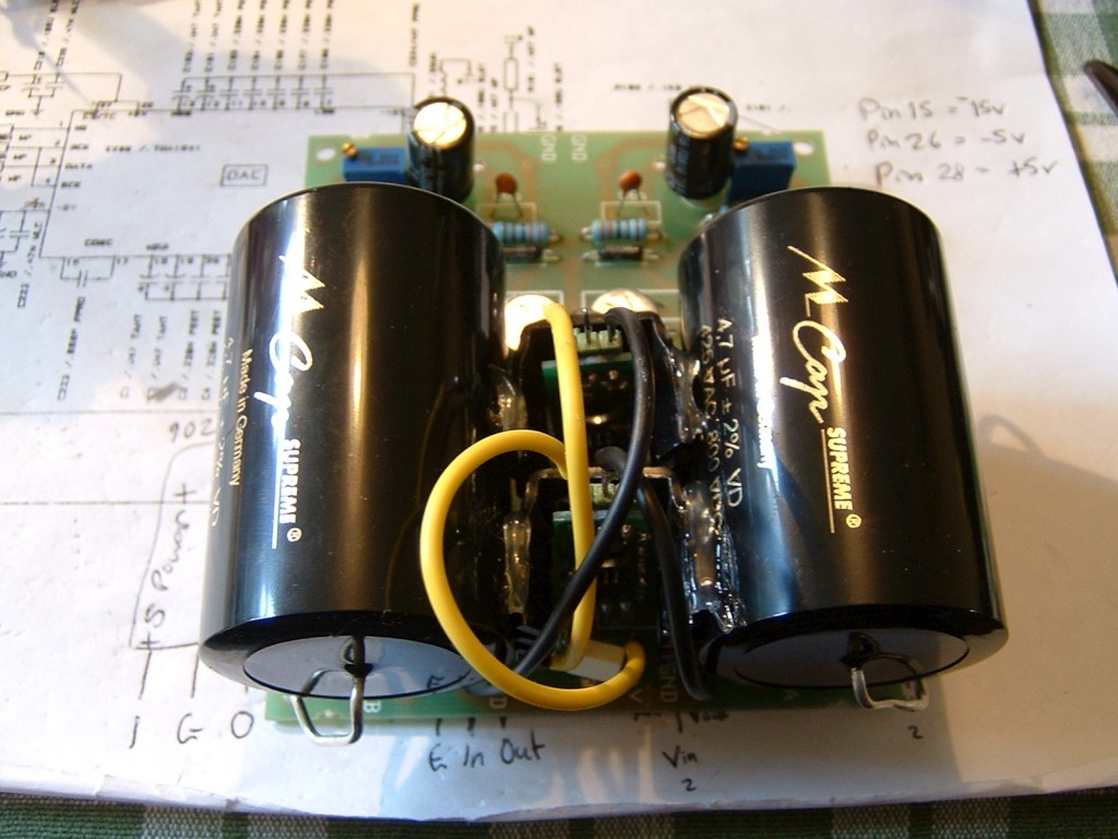

Very cool post, thanks! I'm using the Pass D1 output stage with quality parts and S Power regs (and the usual huge, dedicated 100VA supply with good smoothers). I love this output stage though as a Naim guy I think you might not agree!!!! It is exceedingly polite / smooth / warm / full.

I've got some ideas to mull over now. I've contemplated substituting the feedback resistors on the -5 and -15V S Powers for a resistor + trimpot to achieve a perfect 10V between them but, being honest, thought I'd break them as it's all surface-mount there. Is it worth the risk? Will I hear a gain?! I'm curious.
It would be more effective to feed the -5reg from the same rail that feeds the -15v reg, then try the extra cap. The -5rail only draws about 30mA, so the reg will be ok heatwise dissipating c.0.5w if run off (say) -22v; no extra heatsinking required.
If the rail to the -15v doesn't have a little bit of RC decoupling ahead of the -15v reg, add some. 10ohms and a 10-100uF is enough. It will clear-up noise that otherwise passes right through regs - the 1541 seems sensitive to this to my ears (the -15v goes to the substrate that everything is built off in the dac - you can see in the datsheet this pin has the worst PSRR)
Arcam used RC decoupling on the psu for the +-20V (feeds the DAC and op-amps). When I upgraded the smoothing caps I also deleted the RC filtering and the sound quality gain was about the biggest ever from this player. I'm now seriously sceptical about using RC decoupling on the DAC supplies... though I used RC and LC filtering on my SAA7220 and SAA7310 supplies and got a slight gain in SQ. These were massive banks of caps before and after the L/R. I also used LC filtering on my clock supply, which also seemed to improve the SQ a tiny bit.
I seem to have some conflicting circumstantial and incomplete evidence regarding RC filtering in the cd player. I'm not sure what noise I'm removing from the DAC PSU as it's not shared with anything. The transformer, PSU and regs purely feed the DAC's 3 power pins. I'm sure there's ripple and noise from the AC, but I don't know how much.
