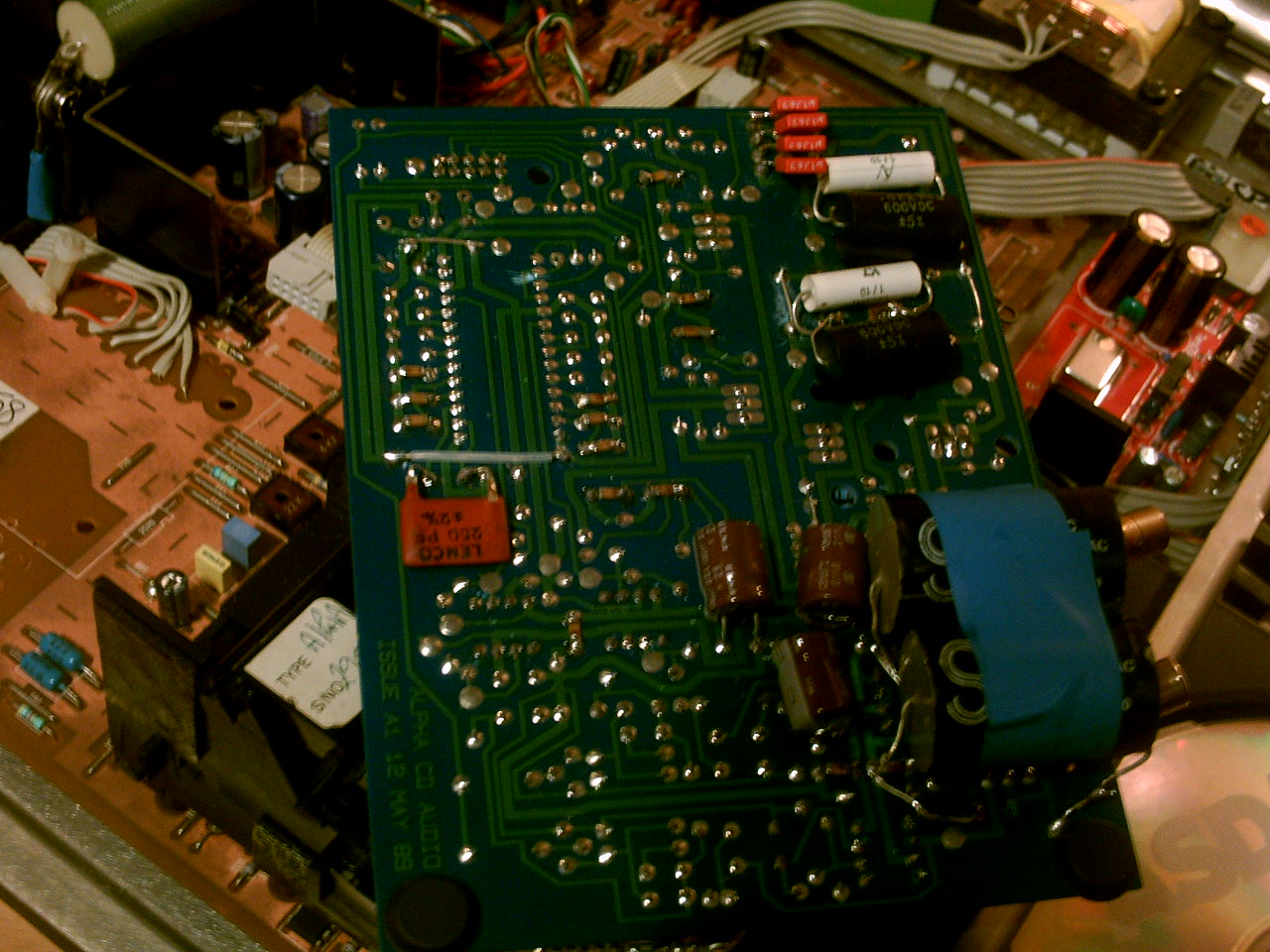

If jitter masks some upper mid and hf small detail then this has most certainly worked for me.
There's this track I listen to a lot which has some cymbal tapping going on in the background - you could just about hear it but it was never prominent.
Now, I can hear it quite clearly - that's not to mean it's gone bright or splashy ....just it's now part of the music as a whole - it's was quite surprising.
I'm really glad I did it and hope your findings are the same - see pic with the flat red Lemco.
The legs are not ' rods ' like resistors btw but instead are flat so you'll need to fold them with long nose pliers or something - very simple.
They still fit in the holes fine - no problem at all.

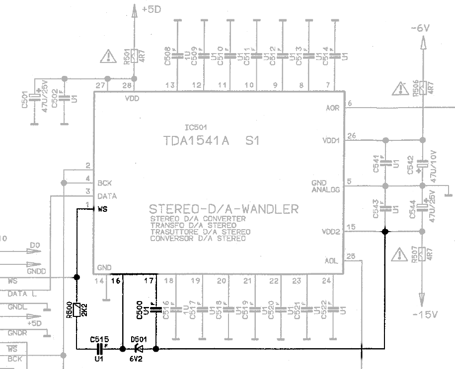

Simon see below :
Quote: Also, is silver mica ok for the DEM cap in 2% tolerance ? You mentioned 1 % but they are hard to come by. unquote
Reply received today :
One could use a 220pF 2 ... 10% film cap in parallel with a 47pF film trimmer. This way the trimmer can be adjusted until the DEM clock locks on an exact multiple of the bit clock, this can be verified with a frequency counter or oscilloscope. The free running DEM clock can still lock to the bit clock because of on-chip crosstalk between both clock signals.
This is the latest received from ecdesigns - fyi

I see why you installed that mica underneath, it's a pretty large and unwieldy-looking part.

Simon Hi
Underneath is the ONLY place I could fit it - probably same for you I'm guessing.
That diagram is another DEM method allegedly and has been done with success on other machines.
Still some homework to do and some guidance from a guy whose done it already.
If I can do it and it works I'll post the pics for you and Walter to chew over - only if it works though !!!

I think you may mean 680pf but the answer is yes - cap C223 is out and replaced with the silver mica.
