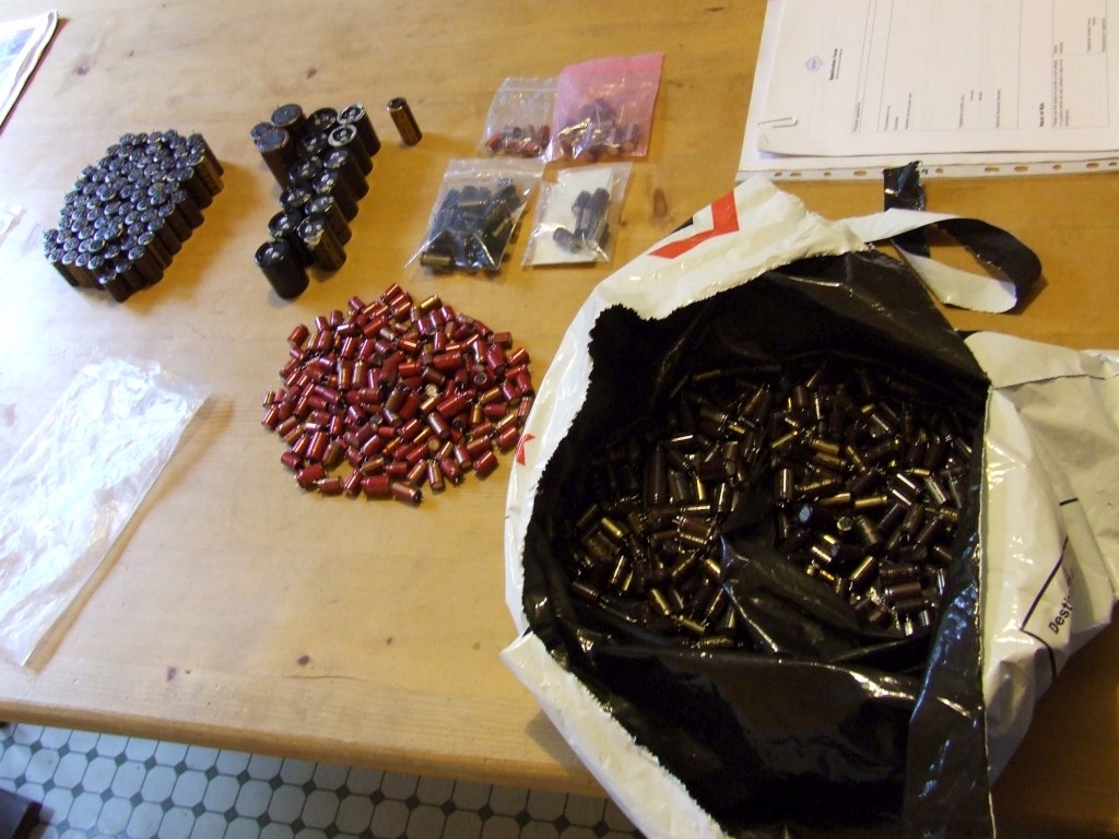

The bag was very big indeed! These supplies are already off-board in my external power supply box. There's plenty of room to play in there. The chassis is from an old Sherwood Pro Logic amp / decoder - a bit defunct so I stripped the innards and recycled the box.
That's like ....a skip, not a bag !!

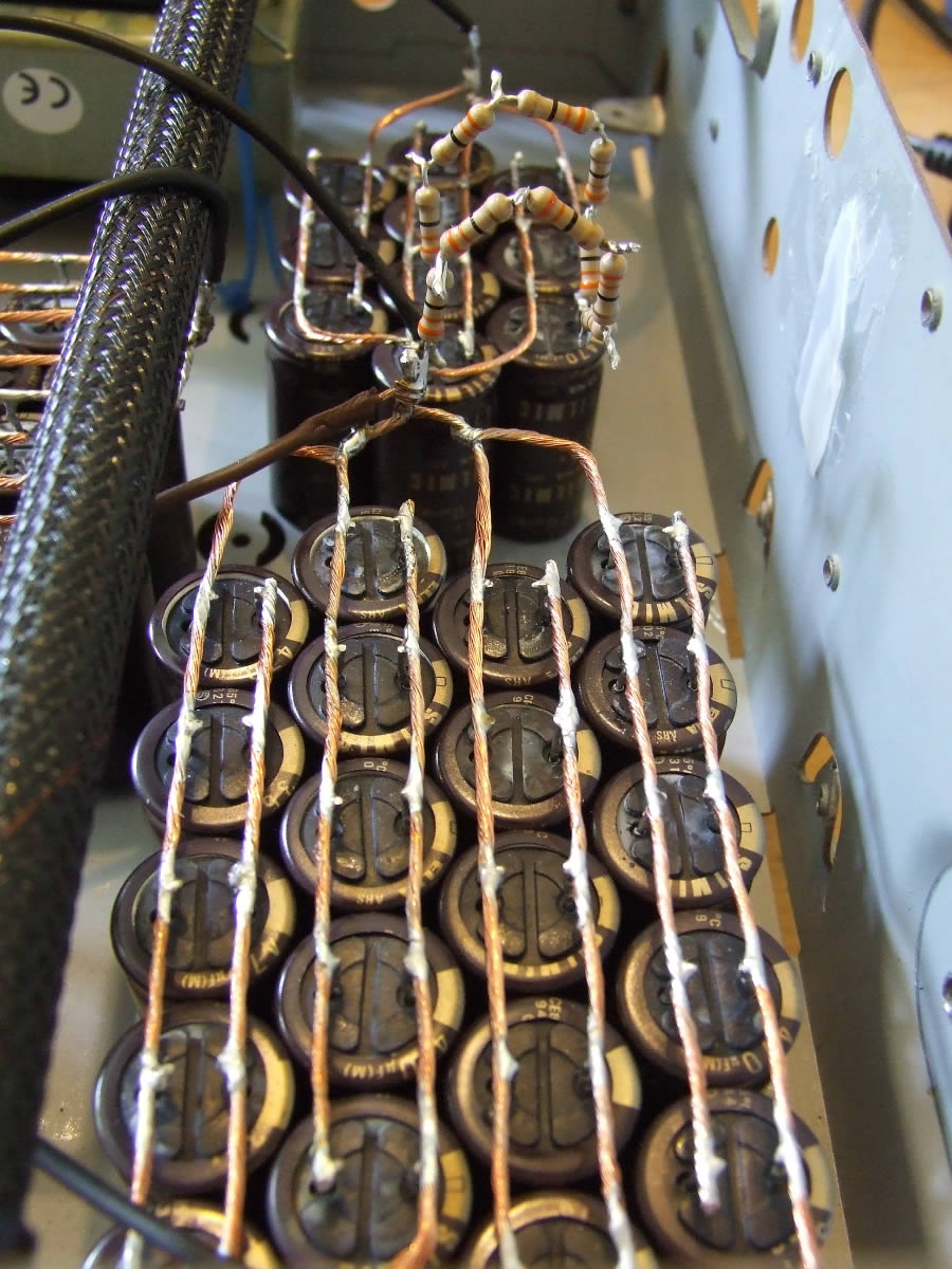

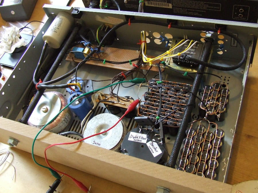

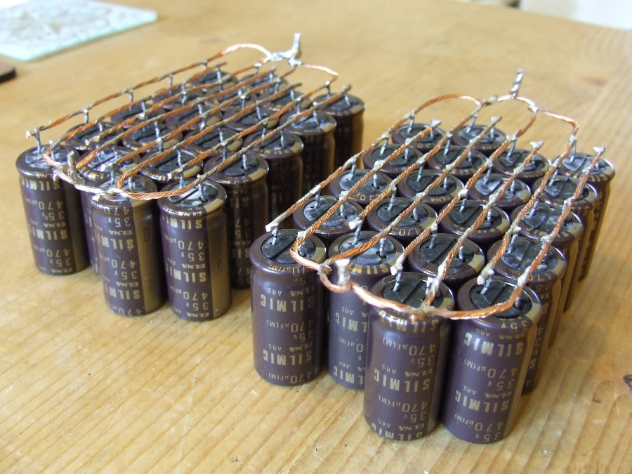

Well I've connected up the two banks of 20 Silmics. It fits in the external psu just fine after a minor re-jigging. I'm going to try CRC filtering as Lee suggested to me in private. I will simply place a series resistor from each cap bank leading to another, smaller bunch of Silmics. I've not worked out exactly what value the resistors should be but I'll start with a bit of trial and error looking for a reasonable voltage drop.

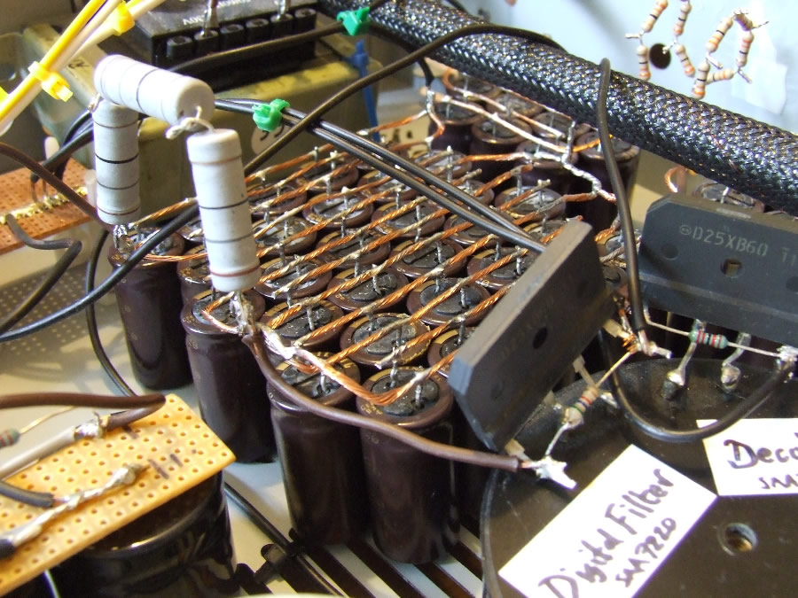

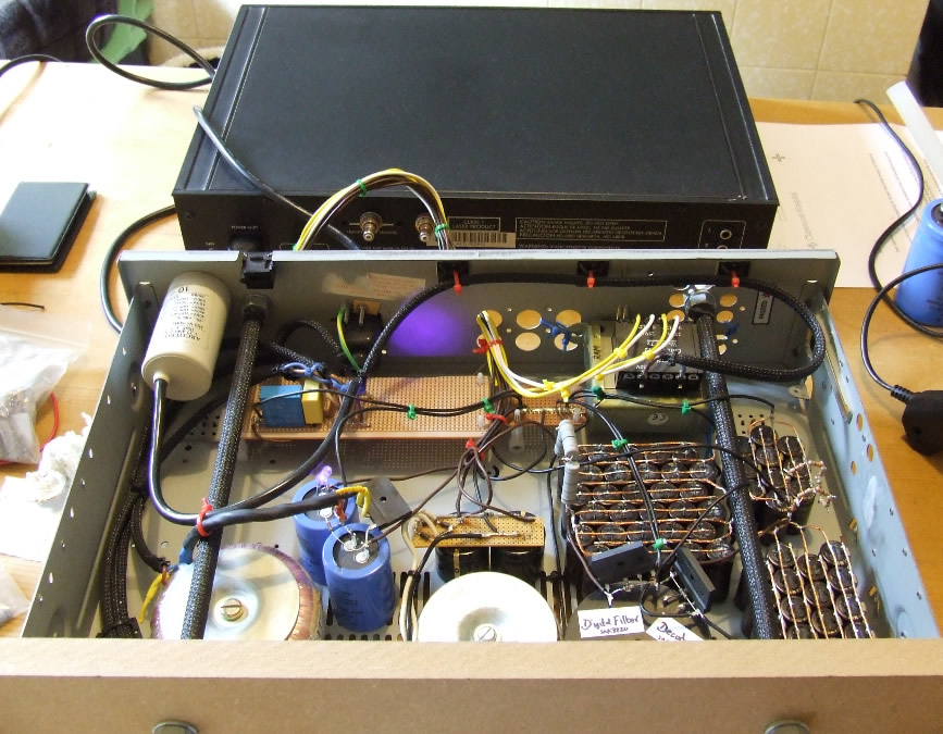

Alright, here we go. I finished my CRC supplies for decoder and digital filter.
It goes like this. Decoder: 20 x 470u > 10 x 33R 1/2W in series > 10 x 470u
Digital filter: 20 x 470u > 3 x 18R 5W in series > 10 x 470u
Each supply drops about 7-9V across the resistors. The resistors get warm but are over-rated quite heavily (I actually did some basic maths for once).
The regulators now have to regulate less and have a supply surely almost completely devoid of any ripple. Hopefully the player will run a bit cooler inside, with more heat spread into the psu box, which was previously quite cool-running. Curiously the bridge rectifier that powers the digital filter supply now gets warm to the touch.

Thanks Andrew, it's not that neat, just neat enough to be sure it works properly and won't fail.
I've been listening most evening and it seems to have improved matters. The sound seems more dynamic and detailed with deeper bass and a smoother midrange.
Combined with the cap upgrades on my DAC chip and also in my preamp and my bass power amp the gains are substantial! Diana Krall sounds magnificent right now!
