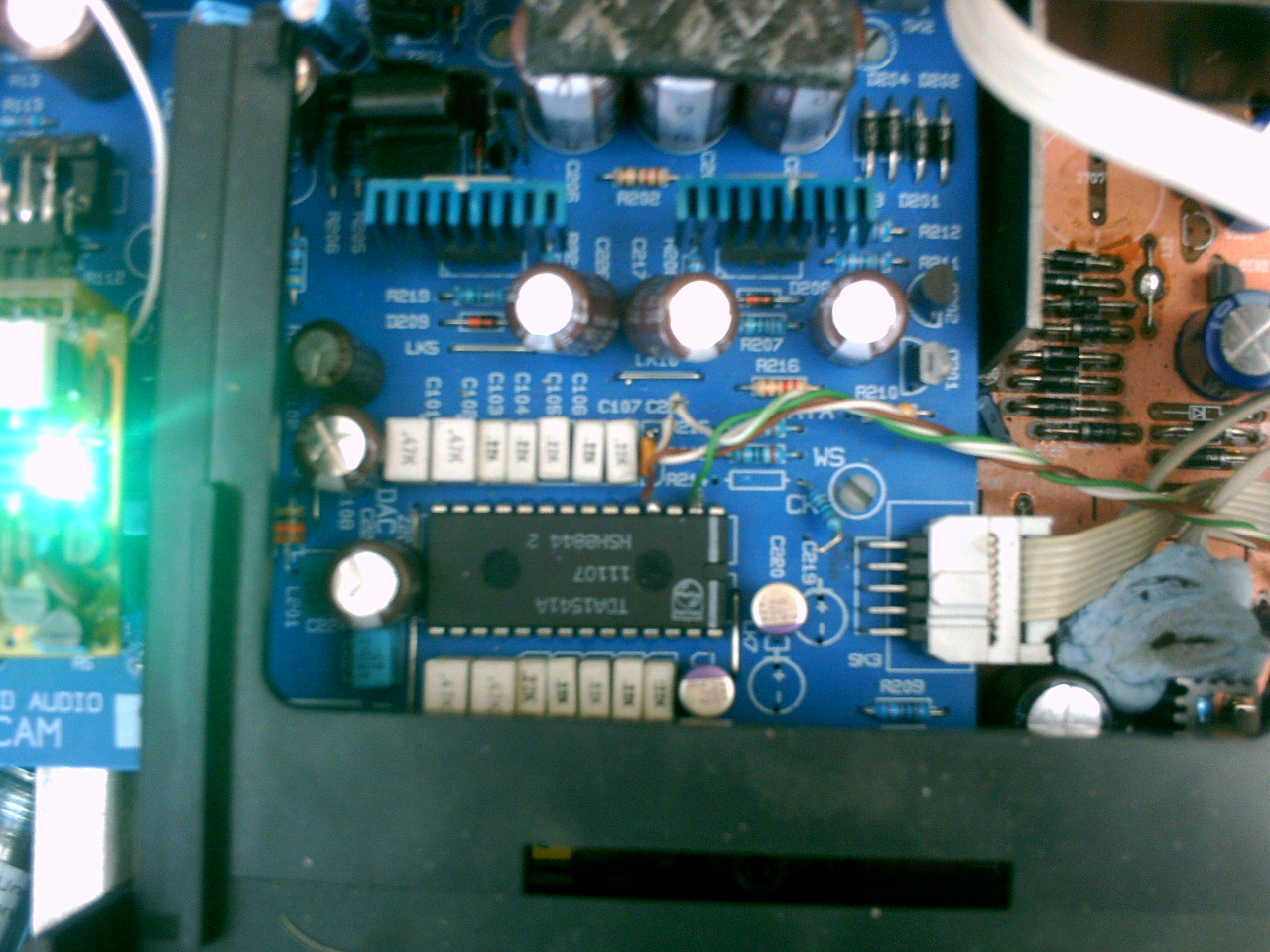

470 pf polystyrene on the DEM as you did ( C223 ) to replace the 680 pf already installed - good idea ?
Hi Andrew,
Yes, go for it, that won't hurt and probably gives a small gain.
Infact - can I stuff the board with polystyrene caps to replace most of the standard issue EVOX pfr's fitted ?
Given polystyrenes usually only come in small values or are very chunky I'm not sure they're the best decoupling cap around. PPS may be a good substitute for the decoupling caps. If you're talking about replacing the filter caps in the original output stage then you can't go wrong with polystyrene.
The lytics in the output stage and before rca's - you linked them out - if I remove them and link out can I just put 3.3 uf or higher film caps across RCA out +/v and -v ( there's no room to put them anywhere else as you know )
I have to say I'm not 100% sure what you mean by that. If you mean film caps as DC blockers then yes, 3.3uF films should do the trick. Only issue is maybe some bass roll-off due to the low value.
On your DAC board - there a small piece of black wire connected to the -v point of a removed cap ( C225 ) and connected to the other side of what appears to be a ( now removed ) tubby inductor ( L201 ) This is all linked to the LM337 on the -5 and -15 rail. Safe to do this ? Or was it part of something related to your D1's install ?
Ah, that. I've had to get my photos and the datasheet open to see what's goin' on! What I've done is put a larger cap than wanted to fit decoupling the -15V rail. That meant removing the series coil (L201) and using the space of both C224 and C225. As I'm no longer sharing the -15V rail with the op-amps (and the D1 has its own +-30V supplies) the coil is not needed for isolation purposes.

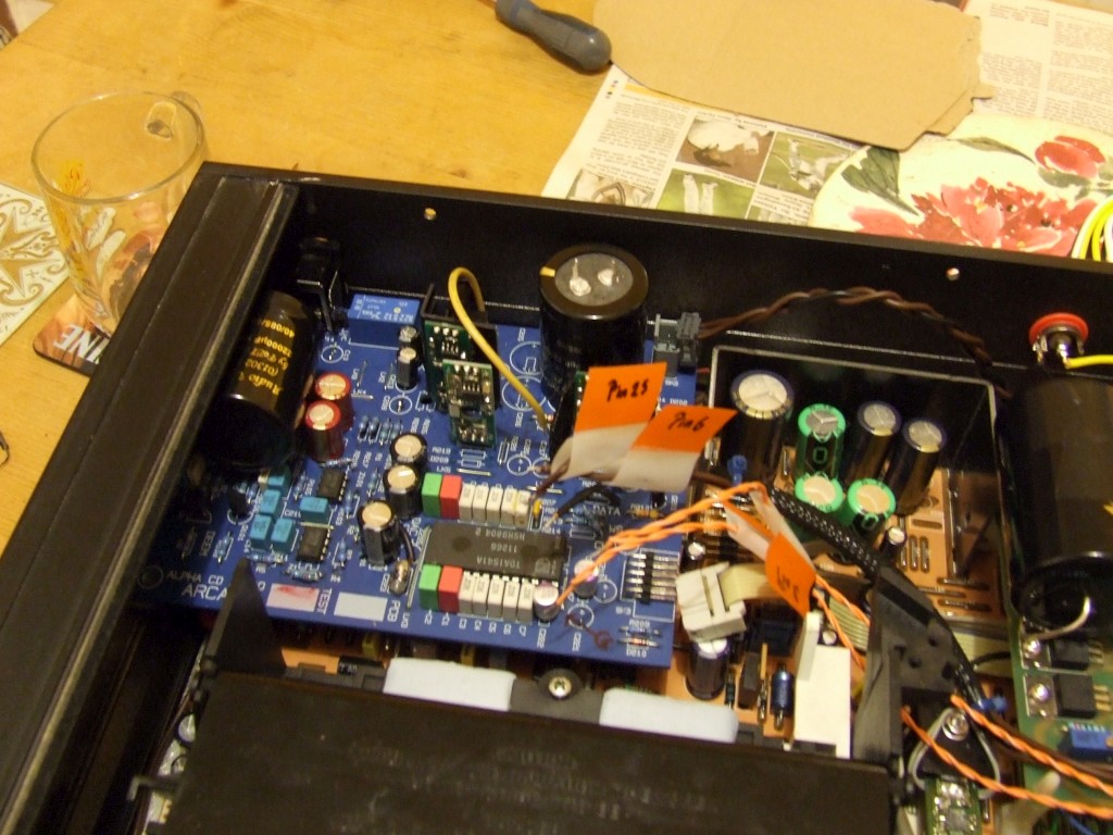

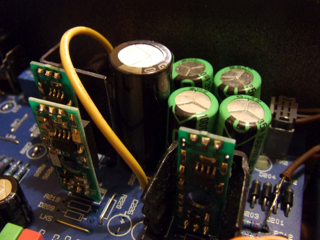

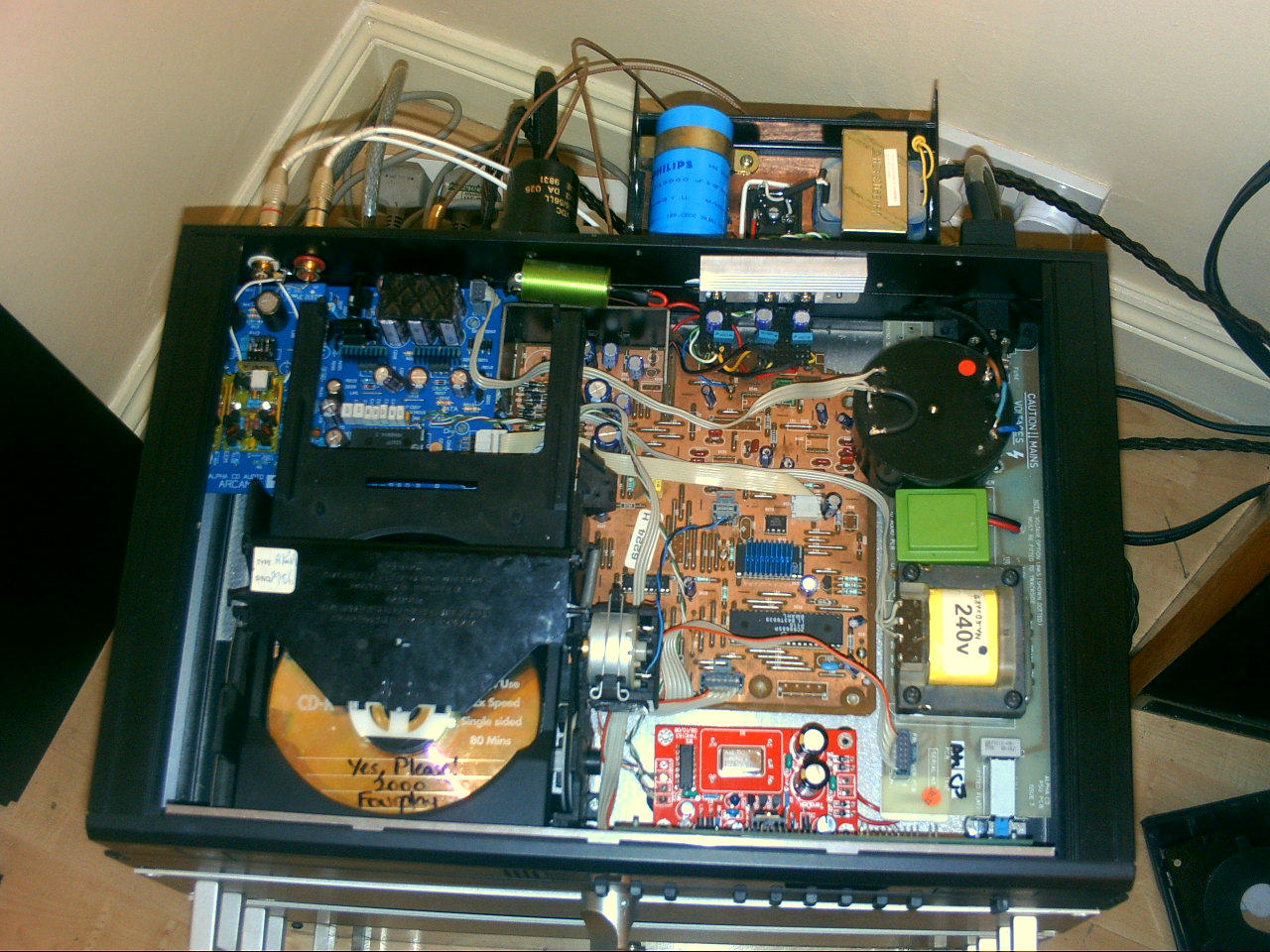

After huge success regulating the servo driver op-amps in the CD63 (others report the same success) I thought the same would work well in the Alpha. Apparently not, I heard no real changes in doing this mod, so I don't recommend doing it until you run out of obviously-good changes.
In the pic, the Aerovox large- ish black cap ( 10,000 uf / 63 ) sticking out the back replaces the on board 6800 and is bypassed with a green Vishay 10 uf )
The bit sticking out next to it is a fixed alu case with a traff / bridge and
large Phillips blue cap all dedicated to the SAA7220.
The aluminium heatsink holds ( crap ) std 7805's which in turn feed 7310, ram and 7220.
Have some teddy regs for 7310 and RAM to go in and a possible discreet ps board for the 7220.

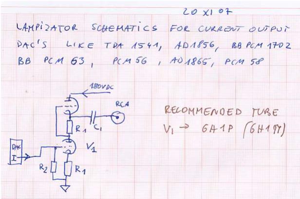

Are your DAC supply smoothing caps standard? If so they'll want renewing. I'm actually about to do this on mine. I put 5 naff 1000u caps in as well as one Black Gate. I'm going to replace them with 2 x 22,000uF Fidelity Audio caps, which are the same as Mundorf M-lytic. Fitting will be interesting, may involve a drill. The DAC deserves a good supply though, and it already has that nice transformer and schottky diodes. I may at some point change those for HEXfreds as I think they may sound better, not sure. Schottkies may be good for digital, probably less so (bright and sterile) for analogue applications.
RE 6N6P OUTPUT
I have had good results by eliminating the entire stock output. I take left an right channel directly from the tda.. 24guage twisted pair straight to the pins of a 6n2p output section. The output from the tubes coupled via 4uf Obligatto PIO caps to new RCA. I tried 1uf Mundorf film caps, the PIO was a big step up low end and rich clear texture. Most recently I have made another big step up by bypassing the PIO with .1uf Russian teflon. To summarize, the big jumps in order on output were:
bypass all stock output with a 6n1p tube output,
switch to 6n2p tubes
remove all bits and pieces (caps, resitors and opamps) from the PC between the tda and rca. (75% of the board is now empty)
upgrade film to PIO
add teflon
I follow the Lampizator approach to output. He would claim you 6np6 will not have enough gain for the tda. Not sure if he is right. I have a sony cdp that I use for experimenting with a current out dac as well. Tube rolling on it recently between 6n1p, 6n6p and 6n2p all worked well. It is no contest that the 6n1p is the loser. The 6n6p is lovely (takes a ton of power for heaters). Its really a matter of preference between it and the 6n2p.
The russian military caps really are a deal for output coupling.
If in the mean time you are talking about the filter caps between the + and - on the stock output RCA, just snip them off and throw them away. You will find a wonderful improvement with no cap. Then run toward getting rid of all the stock ouput IMHO

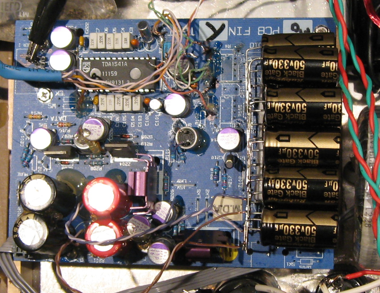

Simon Hi
Thank you for taking the time to reply to all that - I'll try and be more precise / shorter for future - apologies.
I've changed the MSB's to .47uf's which improved things a bit - maybe a 1 uf in the future.
I did change the 6 DAC supply caps to Elna's but your idea sounds MUCH better.
Wire links connecting pos and neg's together on the DAC board with flying leads to the new big caps - is that how you'll do it ?

Yes, that is a typo. The Lampizator guide is here:
teachings of Prometheus
He describes the circuit as:
"Lampizator is an anode follower single ended triode in pure class A with a dynamic active load. It is called SRPP circuit or totem pole. "
Removing stock output
I thought a picture would help describe what I mean by removing the stock output.
The first pic is with the output gone. I pick up the signal just before the former location of the first opamp. I have blackgates on the power supply and oscons everywhere else.
Second pic added more blackgates where the output usesd to reside.

Wow - plenty of room there - Simon will be inspired by this !!
Good and useful pics - thanks.

I don't need the room created by removing those parts, I think I can get away with one cap lying down on top of them.
Nice Black Gate bank 😀
