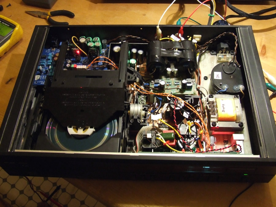

Further clock upgrades
I recently had the opportunity to acquire a new Fidelity Audio C2 master clock, now called "Premium Clock". This I used to replace my C1 clock, which is a simpler and now discontinued product.
Initially I tried running the C1 on the SAA7310 (decoder) and the C2 on the SAA7220 (digital filter) at the same time. This played music but, presumably due to sync issues, there was a ticking noise superimposed over the music. I quickly abandoned that idea, I have somewhere else I may try the C1 clock later.

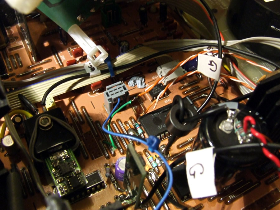

The C2/Premium clock has 7 separate outputs: unbuffered F1 (11.2Mhz on mine), 2 x buffered F1, 2x /2 and 2x /4. So we have 11.2Mhz, 5.6Mhz etc. The clock has onboard regulation (very good voltage regulation at that) so I could leave the super reg attached to the old C1 clock for later use with that old clock.
The first thing I wanted to test was to see if just replacing the C1 running the decoder and digital filter would provide audible gains. I connected the two buffered /1 outputs to each of the SAA7220 and SAA7310 clock inputs. I listened for days and came to the conclusion that I like the clock a lot. The sound became more solid, lifelike, more open and three-dimensional and with less fatigue - particularly on busy passages, which are prone to hardening up on lesser CD players.

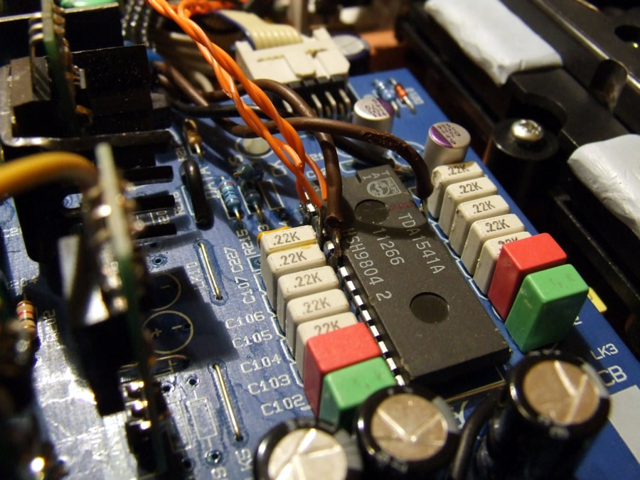

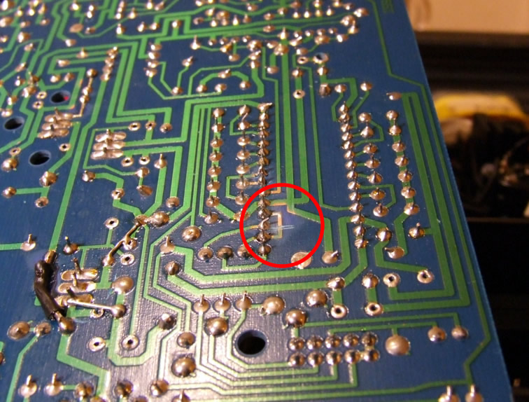

After enjoying this for a while I went back in to finish what I'd started. Now it was time to re-clock the DAC, namely pins 2 (BitClock) and 4 (SystemClock). Pin 2 receives a /2 feed, pin 4 receives /1. For pin 4 I took the clock feed from the spot labelled T1 on the Premium clock, as this is the lowest jitter point (the unbuffered output).
The PCB link between pins 2 & 4 was cut and R214 was lifted (original clock feed).
Some TDA1541 DAC versions *may* not accept this clocking arrangement. My chip is a Taiwan-manufactured TDA1541A and seems happy.
In fact, the sound is quite excellent. Gains were made in every conceivable area. The sound became more dynamic and less superficial once again. The bass, in particular, has taken on a new level of hardness and agility. The pitch of individual bass notes is much easier to discern. Overall, the sound is again easier on the ear and it's more possible to turn the volume up to very high levels due to the non-fatiguing source quality. This is, of course, somewhat material dependent but then again such upgrades seem to benefit ALL music, even the bad stuff.
The clock runs off the same power supply that ran my C1. It's a big frame transformer off-board, feeding a standard bridge (onboard), then 10,000uF smoother, a home-made coil, then a further 25,000uF with various bypass caps.
A couple more pictures.
Not a lot more to do to this player now. Of course there's the DEM re-clock but a close friend thinks it's nigh on pointless (ie. barely audible gains) and that puts me off a bit. I might change my CAT5 clock lines for some good mini coax when I get some, though this works just fine.
