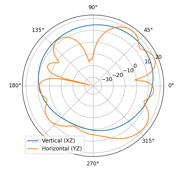

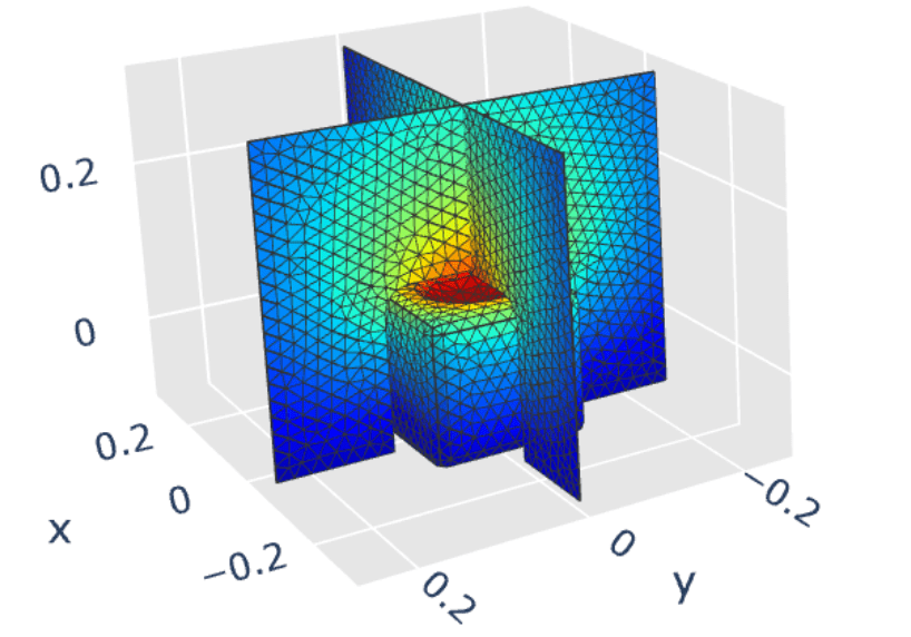

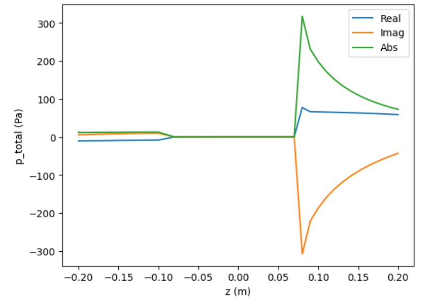

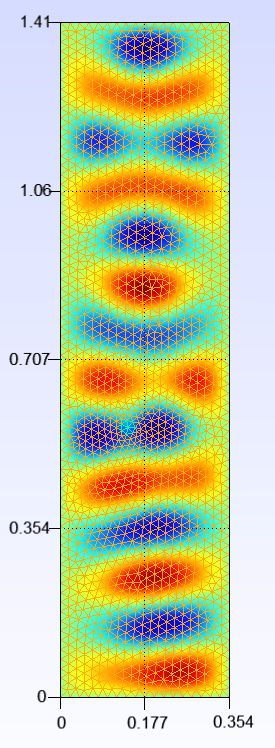

Making slow progress with bempp. Again it's poorly documented. I'm trying the simplest thing that could possibly work (by probably not) - giving it the 2D mesh with velocity field from Elmer.
Currently sorting out how to input the mesh, because bempp reads the mesh but not the field values, so you have to read the mesh again to get them. So now I'm reading the mesh but using the (undocumented!) Grid constructor, which takes numpy arrays of vertices and elements, but the structure of each is different than expected. Now problems with the separate meshed body of the exciter, which had normals pointing in the other direction, but bempp requires all normals to point the same way.
I shall probably have to build a larger 3D model, with an identical mesh on the reverse side so that I can assign the field values there with opposite polarity, and maybe a baffle too. Then give Elmer just the segment it requires.
I dont see how to easily do an infinite baffle in bempp either so that we can compare with other methods. Building a box that's large enough in comparison with the panel dimensions would mean a mesh with many more elements, and very slow run times.

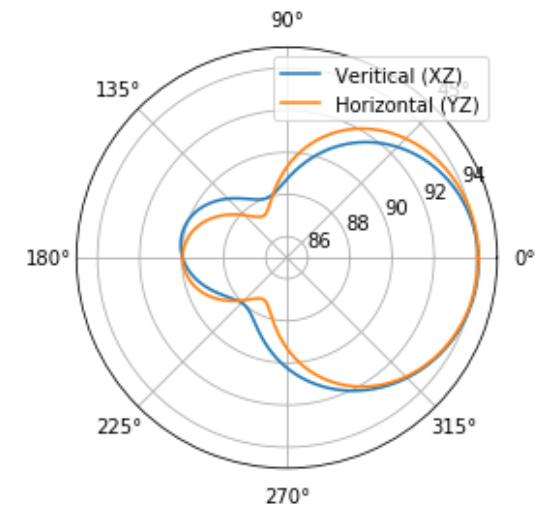

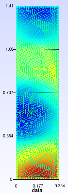

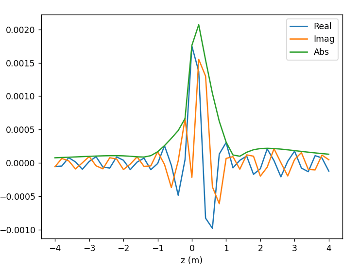

Solved the normals issue, and finally figured out the easy way to get the data in from Elmer to bempp - its obvious when you know how :/.
Dont take notice of the numbers here, I have not even bothered to add the calc for velocity yet or get the frequency right. But is does seem to work.
It seemed to be happy enough to accept a 2D plate, and it radiates with the same sign in both directions, but that's not useful anyhow. Next I need to stitch together the front and a reversed copy for the back to get the proper polarity.

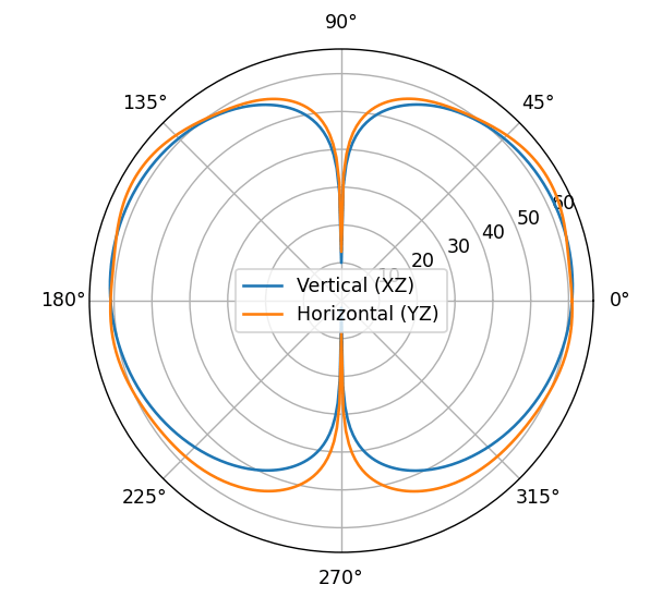

I stitched together a front and back of a panel with opposite polarity for bem measurements. Responses are as expected - a strong falloff of frequency with distance, and bipolar dispersion. Im still just using a random displacement field from some earlier experiments. Each analysis takes about 2 minutes on my laptop, so a freq response with say 50 points will take a couple of hours..
Next I have to build this code into my previous analysis code as a function for getting a reponse.
Regarding standardisation, ideally we would agree upon some standard panel area (I'm using 0.5 m^2), and standard distance for far-field (what about 4m?) and a standard excitation force or pressure (maybe 50 grams force, ~5N ?). Any suggestions for these figures, or any other things we should agree upon? Maybe damping, but that is a can of worms I think...
I will add an option to apply the body force to the whole body for harmonic analysis, because when comparing eg aspect ratio, using an exciter location will obscure the results, exciting different modes as the aspect ration changes. Better to separate optimisation of exciter location from aspect ratio etc.
So next week I hope to have the first frequency response from BEM.

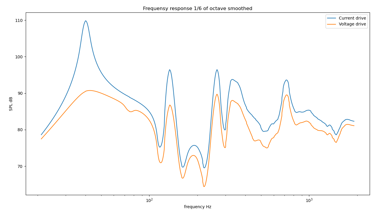

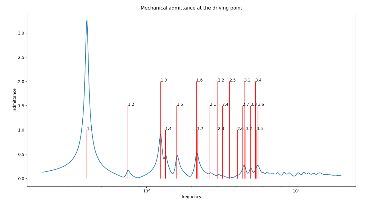

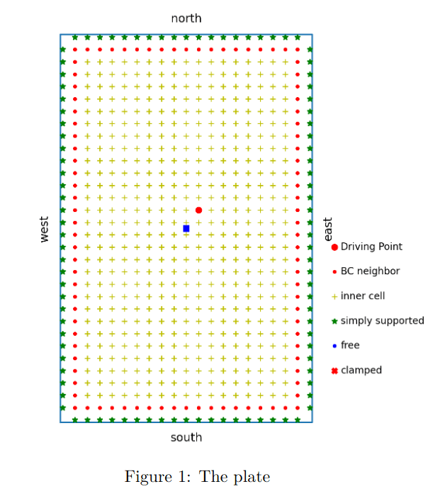

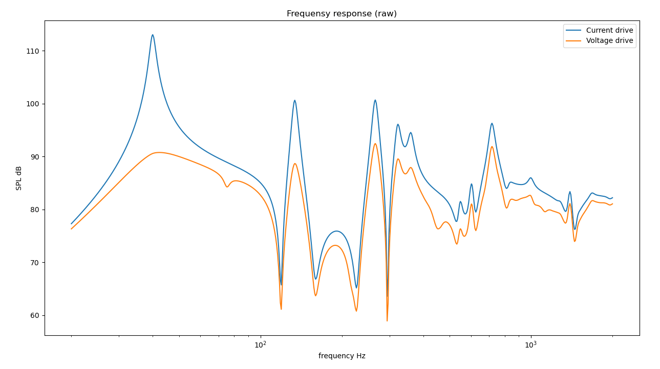

New step achieved : first FR from simulation! Same simplified case for test : a simply supported plate
The plate is Lx = 0.4 m by Ly = 0.62 m
The mesh is Nx = 21 cells by Ny = 32 cells
with a grid dx = 20 mm by dy = 20 mm
Bending stiffness B = 3.09 Nm, Areal density µ = 0.375 kg/m²
Driving Point at 0.55 0.55
Exciter : Re = 4.0 Ohm, Le = 0.1 mH, Bl = 4.0 N/A
Point Of Observation at 1.0 m
Plausible enough to be satisfied for tonight!
Explanations of the method to come
Christian
PS : some adjustment to be made in the SPL (wrong value for the reference acoustic pressure, 13db to be added?)
Hi Paul,
Which additional operations have you on that? A simple sum of the opposite identical signal would lead to zero over all the range. Some attenuation of phase effect from the distance on the rear?

I just came back to your previous post with FR like #275 (now my script is able to give results in the way it outputs something, I have more possibilities to go in the comparison) In a next simulation I will import your parameters (panel 1m*0.5m, material...) to have a comparison. 2 remarks having a look back to those FR :
  • have you the option of semilog (I am used to have the freq in log!)? If not, not a problem to plot in linear also from Python.
  • it seems having a difference between our 2 scripts at the first frequencies.
Hi Christian
Yes I can plot semilog no problem, I’m using matplotlib. I use linear when I need to interpolate or estimate frequency values because it’s not very accurate with a log scale.
I created a copy of the front mesh displaced by 15mm back, and reversed the polarity for the rear. Then I stitched them together by creating the sides with more triangles. Yes simple Rayleigh integral cannot handle this, it’s for BEM. I can’t do double-sided with Rayleigh, and I can’t build an infinite baffle for BEM, so comparison is not like with like.
