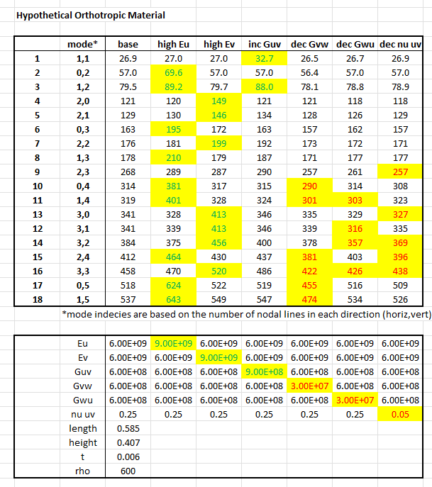

Here is the way I typically use to determine the elastic properties of bending wave plate materials using the "tap test" method.
The following is an update on this earlier post, where I described how to determine the elastic constants of an orthotropic plate. The post referenced above details how do extract the constants E1, E2 and G12 from "tap tests" that identify the natural frequencies of a free plate, in combination with an FEA (or FDM) model. This new post is intended to provide help for extracting also the poisson's ratio (nu), and the other two shear moduli. These additional constants are most important (I think) for accurate modelling of skin/core/skin composites which have relatively light (and compliant) cores. Examples include things like panels with carbon fibers skins over a balsa core, or aluminum skins on a Nomex core, and even plywoods.
In the following I am using the notation used by my LISA FEA program (sorry), where the constants are given as: Eu, Ev, Guv, Gvw, Gwu, and nu-uv. I think you can assume that u=1=x, v=2=y, and w=3=z, if you prefer an alternate notation.
What follows is simply a table I generated for a hypothetical plate, where I simply varied each of the six elastic constants to see which modal frequencies are most strongly affected by each of the constants. For me, the value of this table (I hope) is too make my crude manual "trial and error" method a little more efficient, by helping me decide which constants to adjust in order to better fit natural frequencies identified by tap testing. But this information might also be useful for developing a fully automated method, as Christian has been working on.
The plate I chose as the base case has the following characteristics. These represent no actual panel, but are in the ballpark for a plywood panel. Hopefully some of the generalizations from these results will apply to some real composite panels.
length=585 mm
height=407 mm
thick=6.0 mm
density=600 kg/m3
Eu=6.0 GPa
Ev=6.0 GPa
Guv=0.6 GPa
Gvw=0.6 GPa
Gwu=0.6 GPa
nu-uv=0.25
Below is the table of results. The highlighted cell are modes most affected by changing each of the elastic constants. The lower table shows which constant is changed. One thing to note is that the predicted natural frequencies are much, much more sensitive to the first three moduli than the other two. For the first three moduli, a 50% increase in each (from 6 GPa to 9 GPa) created a big shift in two or more modal frequencies. On the other hand, to produce significant effects from the other two moduli, I decreased them by a factor of 20!
I'd like to believe that the following generalizations may hold pretty well:
- Guv can be inferred from the 1,1 mode.
- Eu can be inferred from the 0,2 mode, along with the other modes where the second index is higher than the first.
- Ev can be inferred from the 2,0 mode, along with the other modes where the first index is higher than the second.
- The other constants mainly influence the higher frequency modes,
- Gvw can be inferred from the high frequency modes where the second index is higher than the first.
- Gwu can be inferred from the high frequency modes where the first index is higher than the second.
- Nu-uv has to be inferred (maybe??) from the high frequency modes where both indices are high.
Eric
